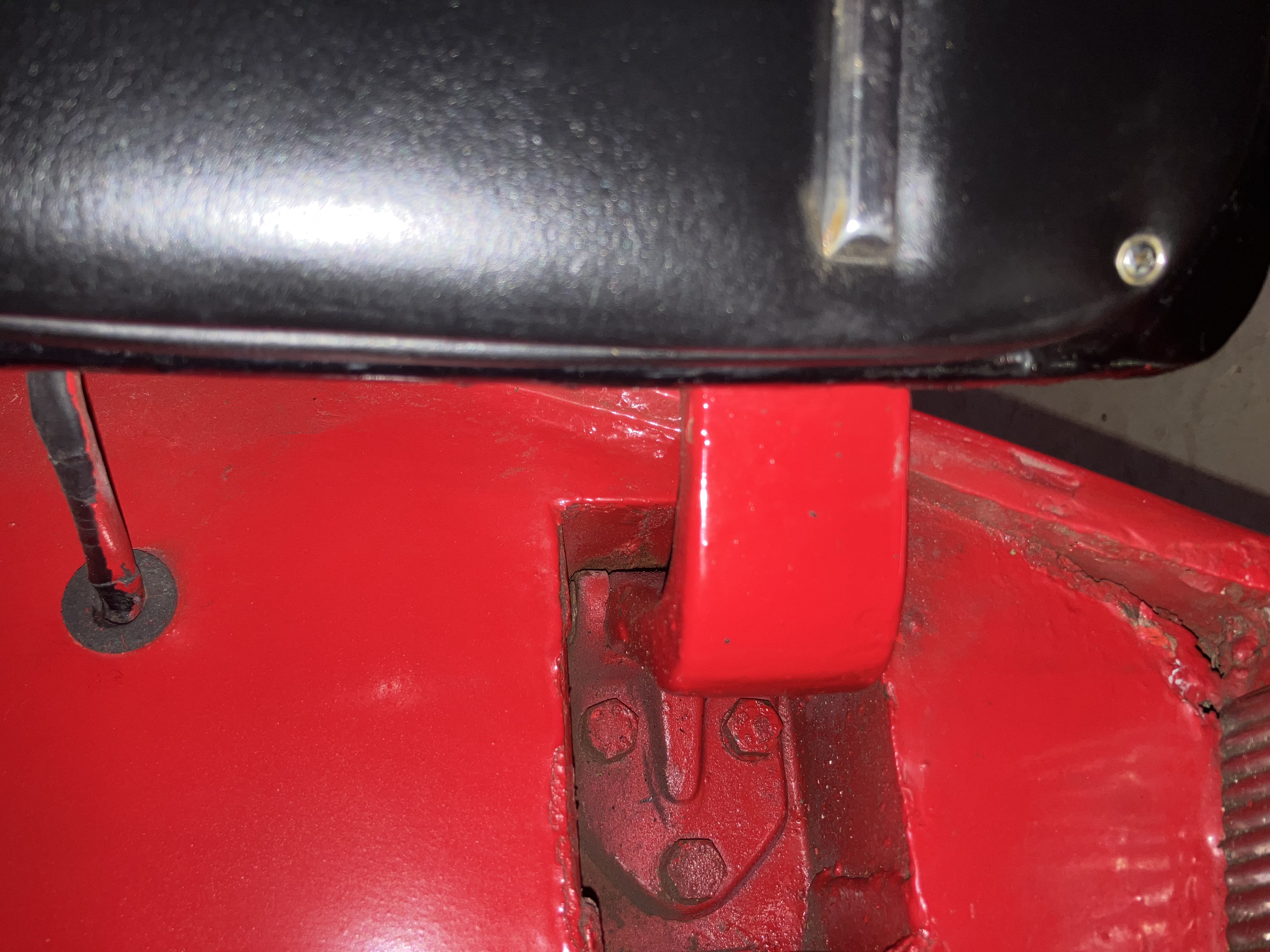

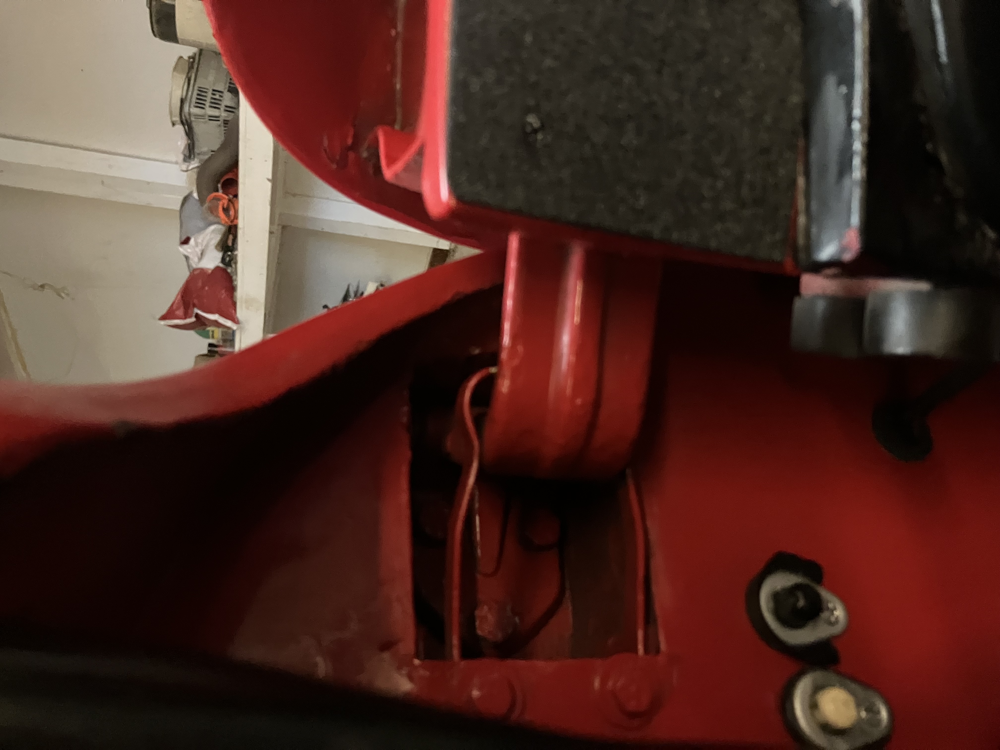

I have a 1967 Dino Spider, Series 1. I want to return the appearance of the door hinge areas as close to original as possible. Attached are 2 photos of the upper and lower hinge areas on the passenger door. You can see that I have my work cut out for me. If any of you have a Spider in original condition and appearance could you please send me photos of the upper and lower hinge areas. Either door is fine. Thank you for your effort and consideration.

I’m in the middle ( I hope) of a total restoration of a 2.0 Spider, the same colour as yours. When I stripped the doors I found that they had been resprayed and the hinges were the same colour. But when I got them off the doors I saw that they were cad played under the paint. It’s hard to tell if it came from the factory with paint & cad plate or if it came plain cad.
I digging thru old photos to see if I can spot an open doo.
It’s the same with the hinge springs.

I'm hoping you find an old photo or two that shows the original. Is cad plating silverish?

Cadmium plating is what all silver metal finish was until the world decided the process isn’t good for the environment.
I only found this out recently🥴
Now it’s a zinc process similar to galvanizing but a lot finer.
I have just had a bunch done in silver, yellow and black. I’m told blue is available also.
I stripped the paint of my hinges and they are definitely cad painted under the paint. Now zinc. As where the original bolts ( of which I only have 2 out of 24)

Now I am asked by the company doing the zinc plating if the original cadmium plating had a goldish tint. Do you have any idea? My appreciation in advance.

Sometime along the production run, from what from what I can establish, all the anodizing became gold colored. My frame is 000665, it’s probably a great example of what was original ( except for the body respraying, where they managed to spray a lot of car red!) but for instance I have both silver and gold colored anodizing. All the engine parts are silver, the pipes for the brake accumulator are silver. But the bonnet release mechanism, which looks original is gold. The door lock mechanisms are silver, but the boot lock is gold.
My car sat unmolested for 35 yrs. I believe these parts to be factory installed.
But I saw an immaculate 2.4 Spider and I was told that all the anodizing was gold colored including fasteners.
Maybe some one a lot smarter than I will add their experiences.
