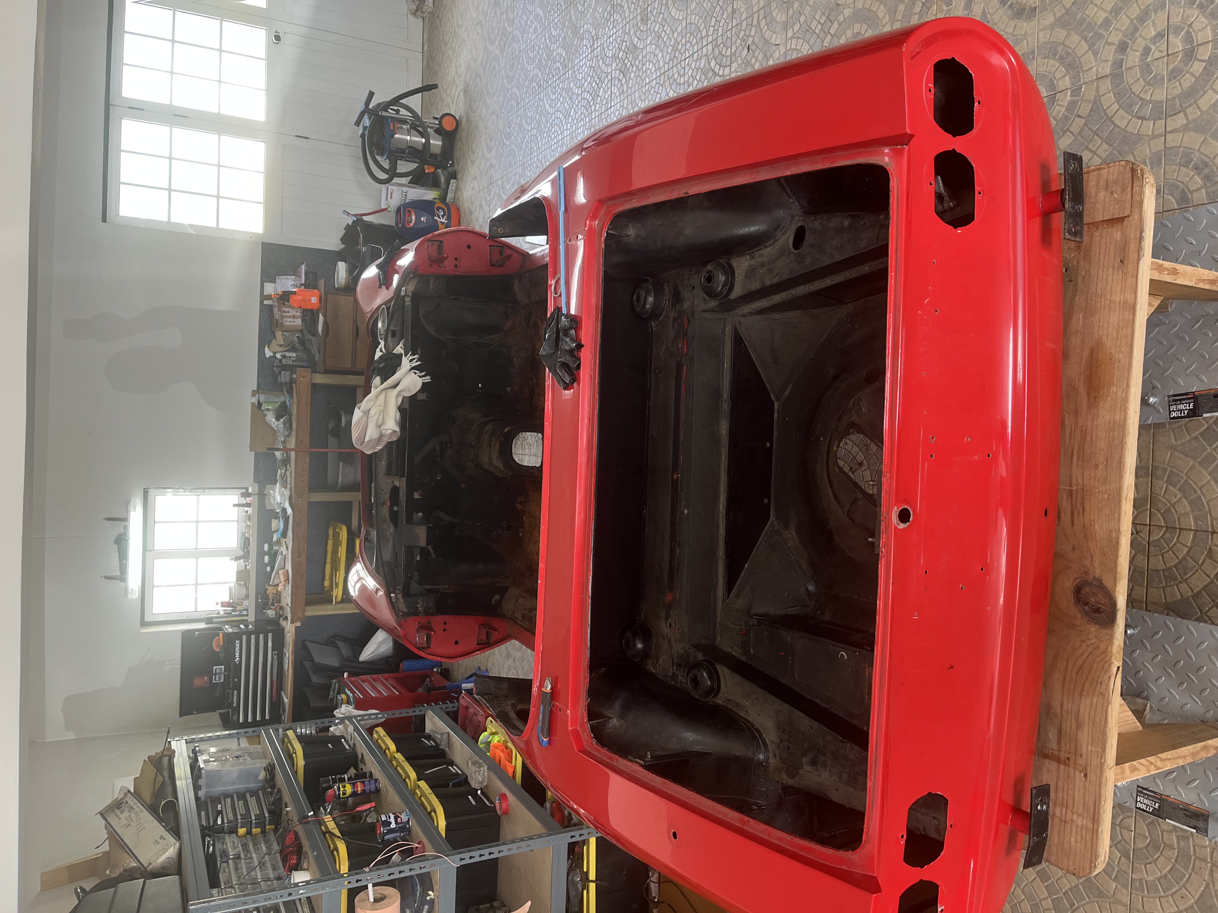

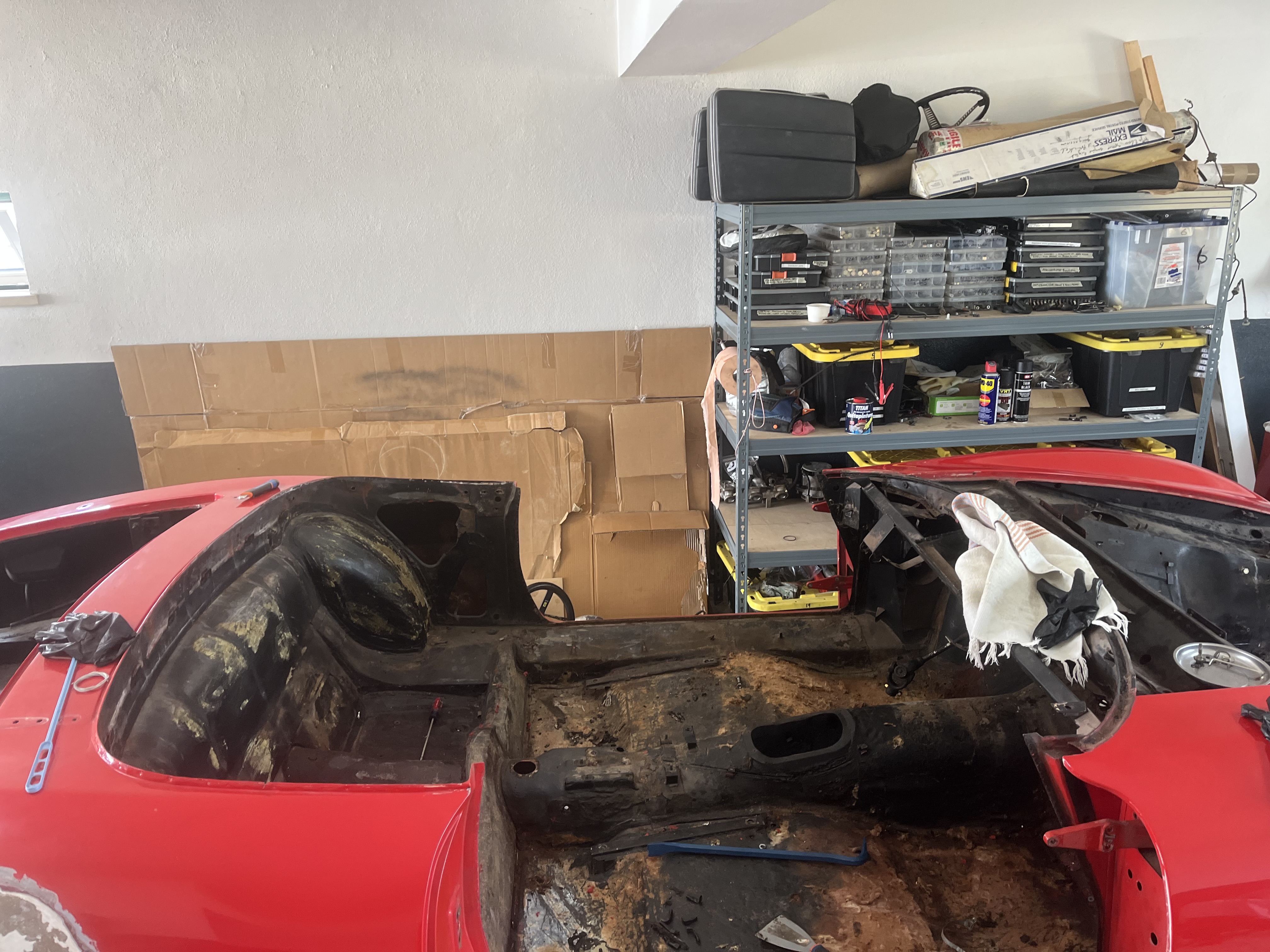

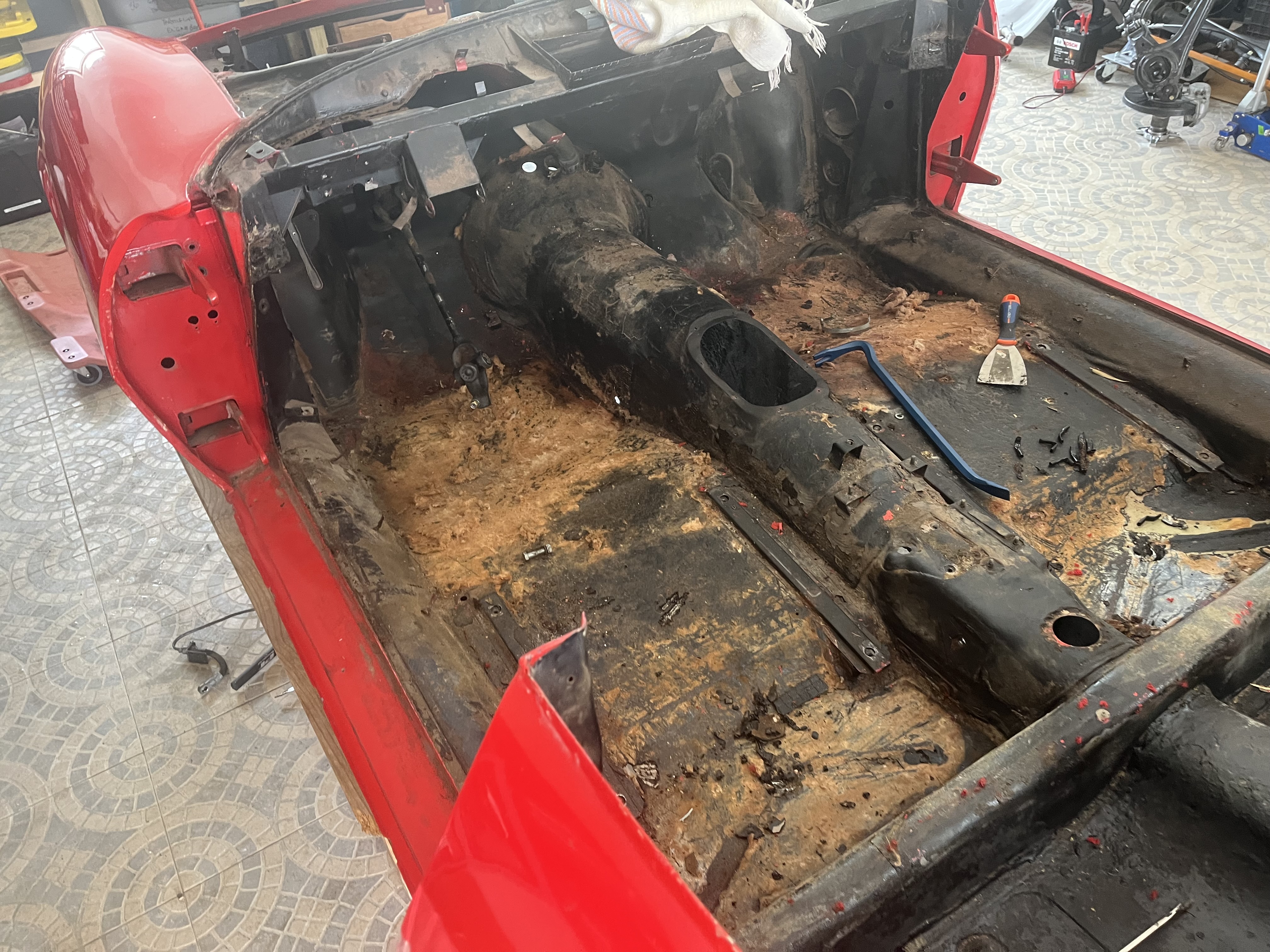

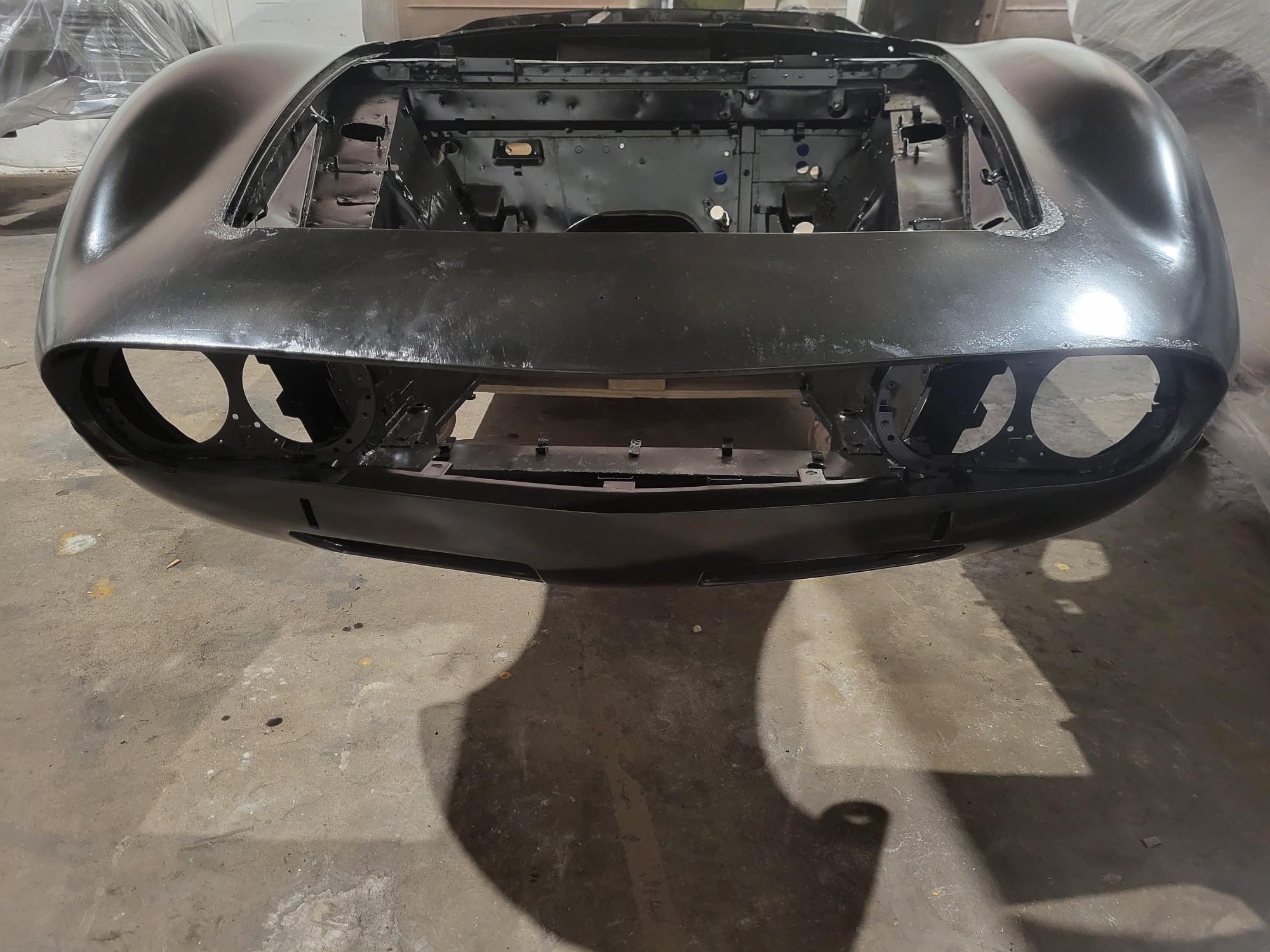

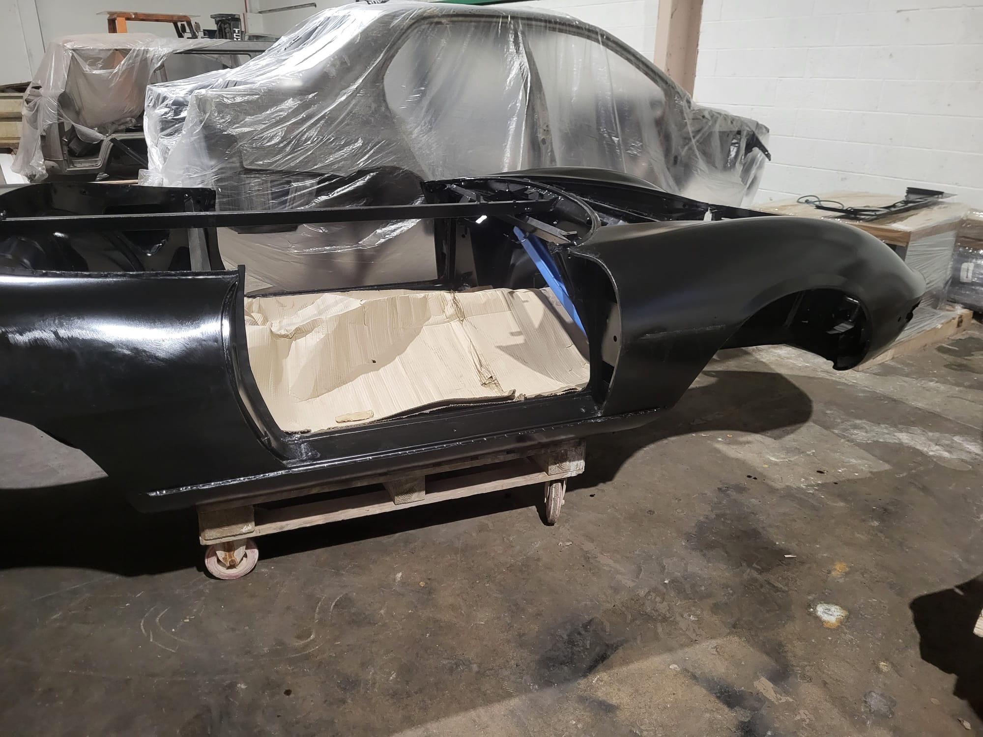

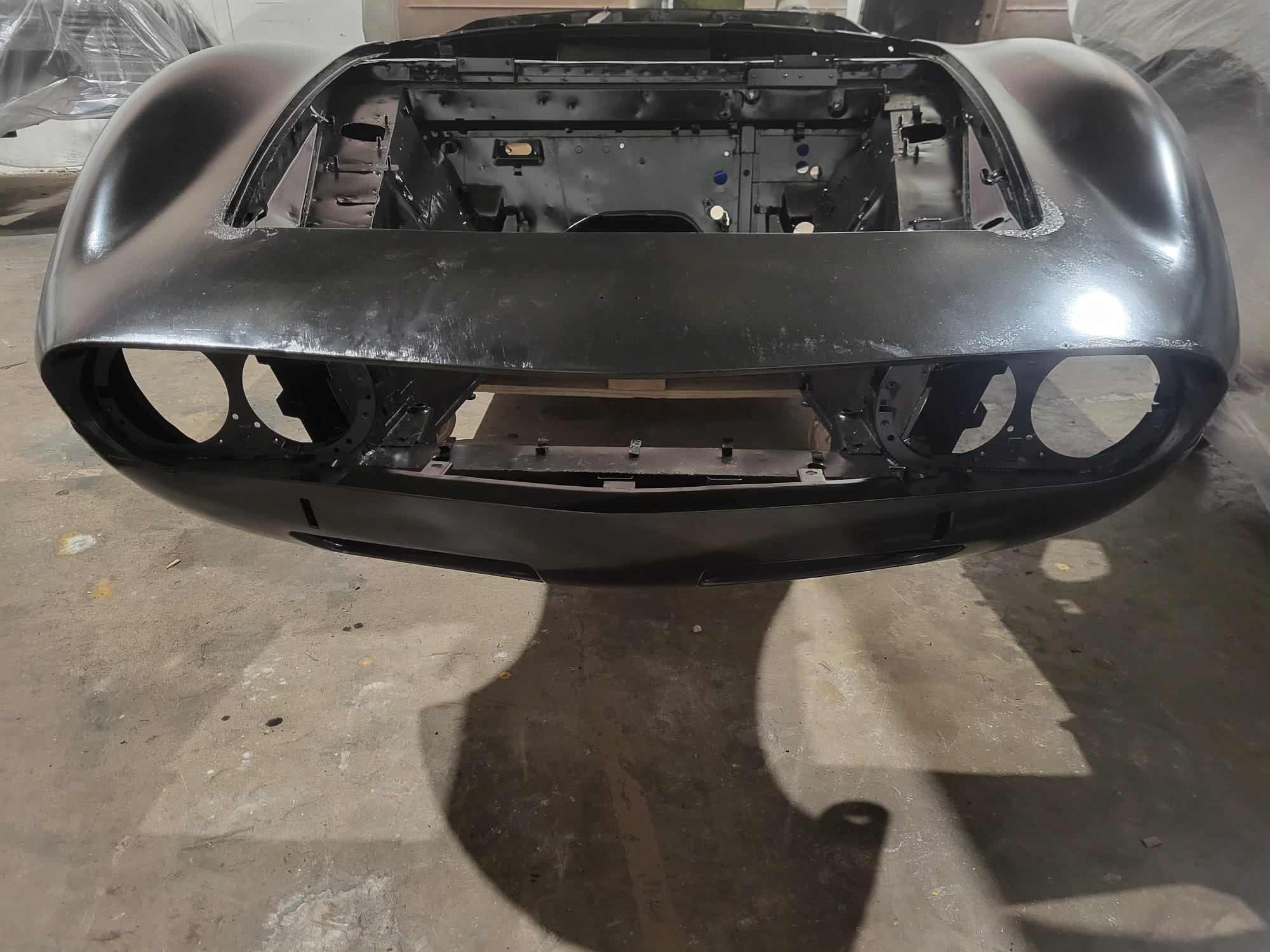

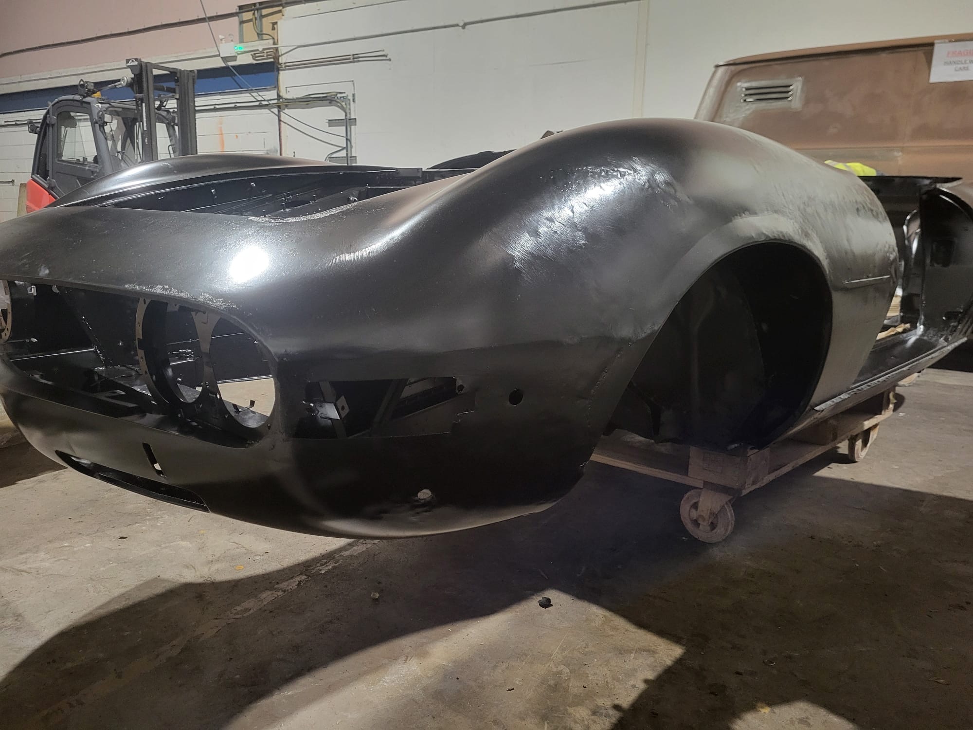

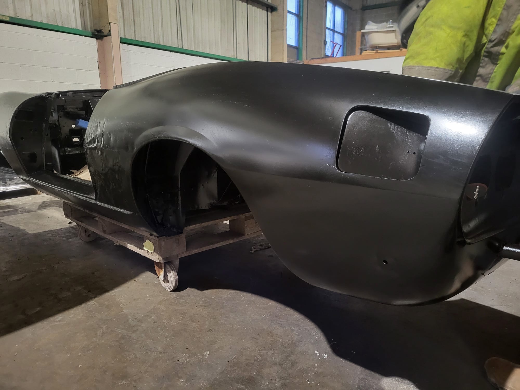

I sent the car for chemical stripping. Everything except the boot lid went into a 4 dip process. Paint stripping, body filler and all rubberized coatings and finally rust removal. Then it was pacified kiln dried and finally dipped upside then flipped to get into all the interior voids.
I’m very happy with the results. Considering this Italian metal is 59 yrs old. Quite a bit of surface rust. Eaten away, three accident repairs that I can see and rust in the drivers side sill. But in knew about that.
On is way back to Portugal next week.

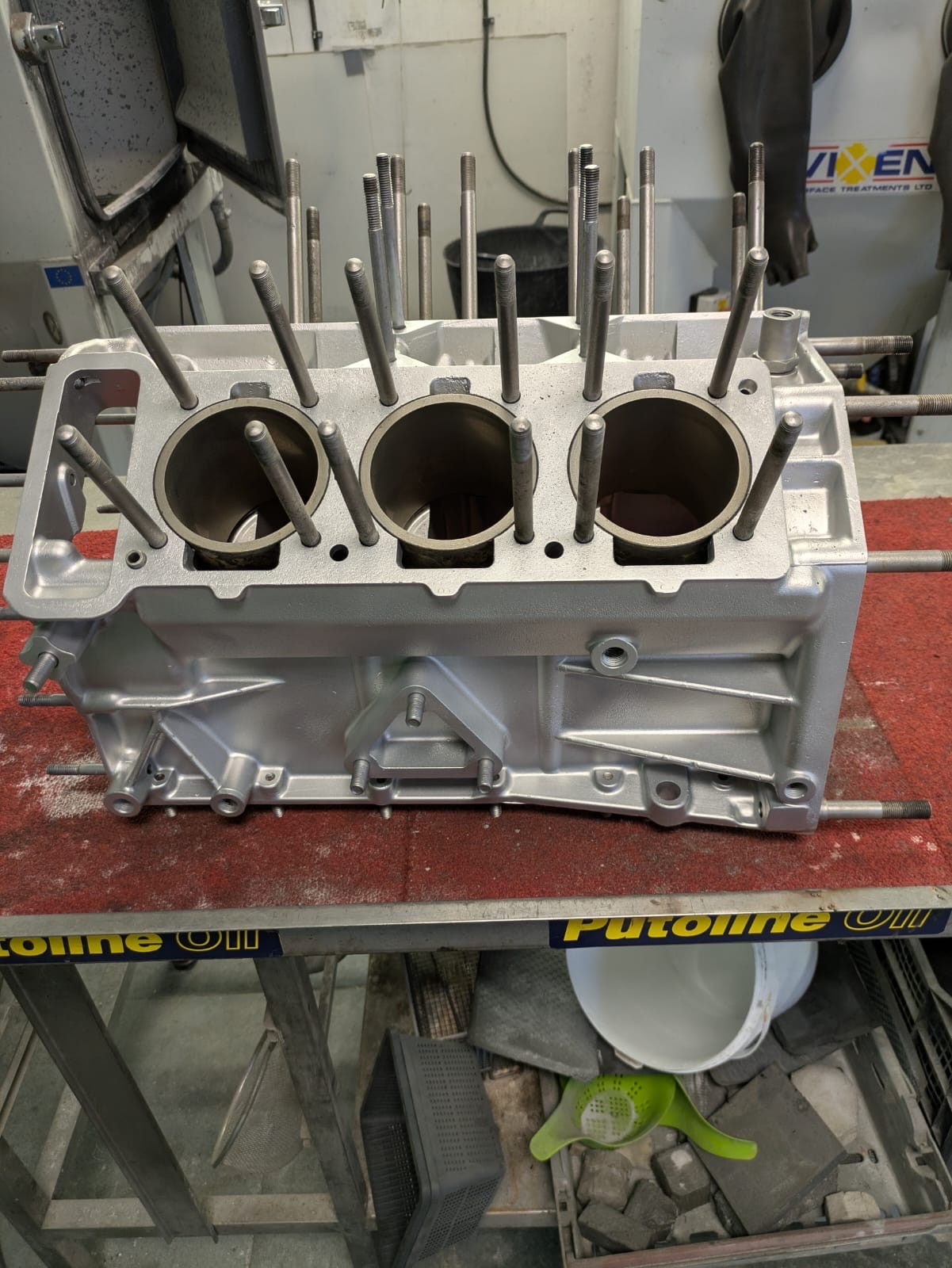

I mentioned my thoughts on colours for the valve covers, dump etc. After seeing several pics of early engines in advertising stuff, other owner’s comments, I decided on a darkish gold ceracote finish. Same coating for the sump but a grey almost the same as the original after cleaning.
All internal and external components were vapour blasted.
