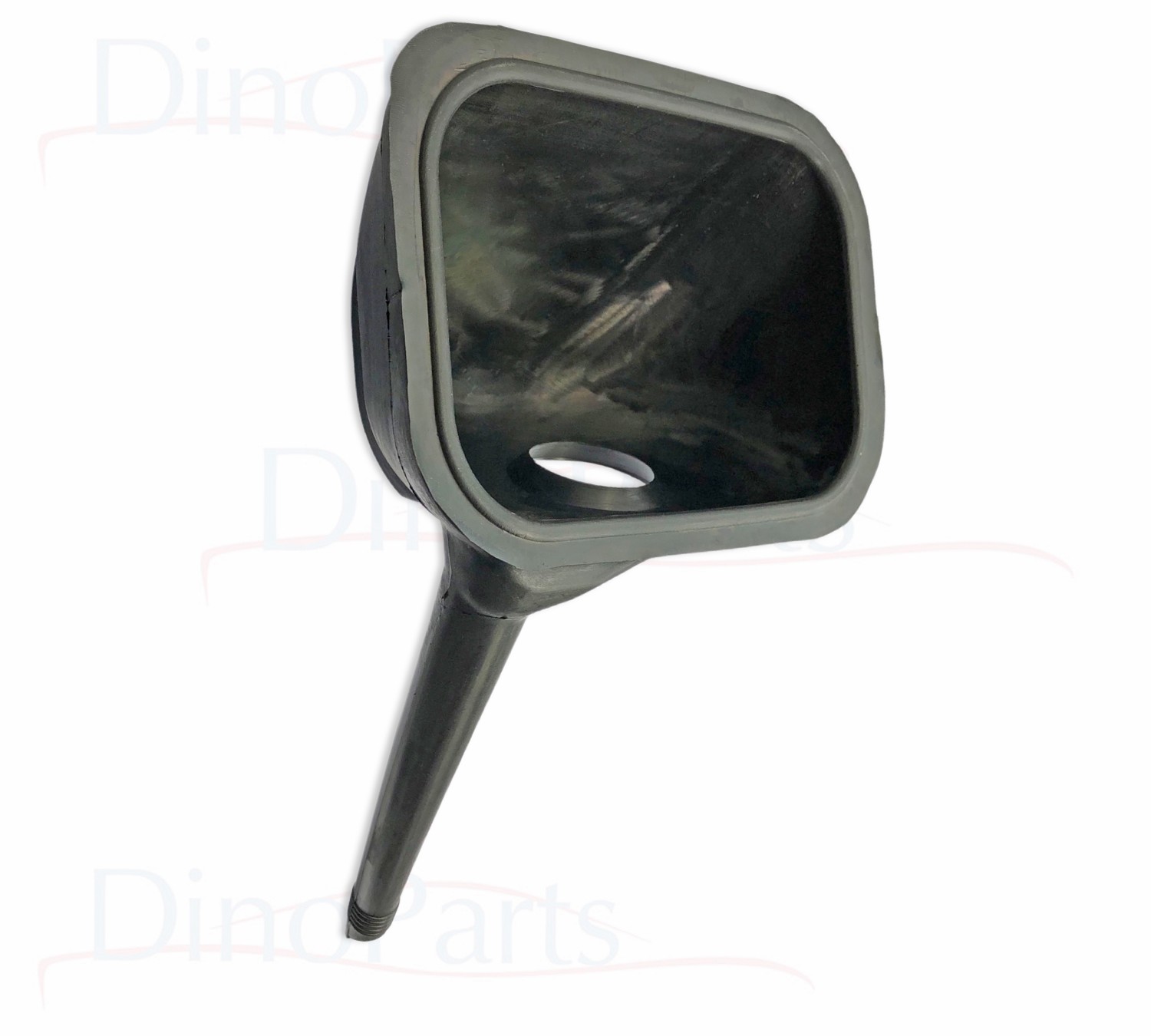

My coupe doues not smell inside (not much
Modern fuel is unfortunately more poisonous than 1970 super, and it is very aggressive towards old ruber and fuel hoses.
I replaced all my hose with modern FPM-ECO DIN 73379 material.
Final step was to replace the old rubber part for the fuel filler:

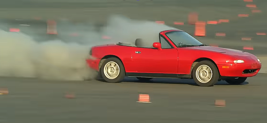

This got an explanation, when the american TV-series "Mythbusters"
equipped an open Mazda Miata with a smoke grenade.
When it was installed just behind the car´s rear valance, the smoke
was sucked forward, filling the whole car with smoke - even at high
speed! See pic below:
Only when moving the smoke grenade clearly behind the car, the
smoke was not sucked forward anymore:

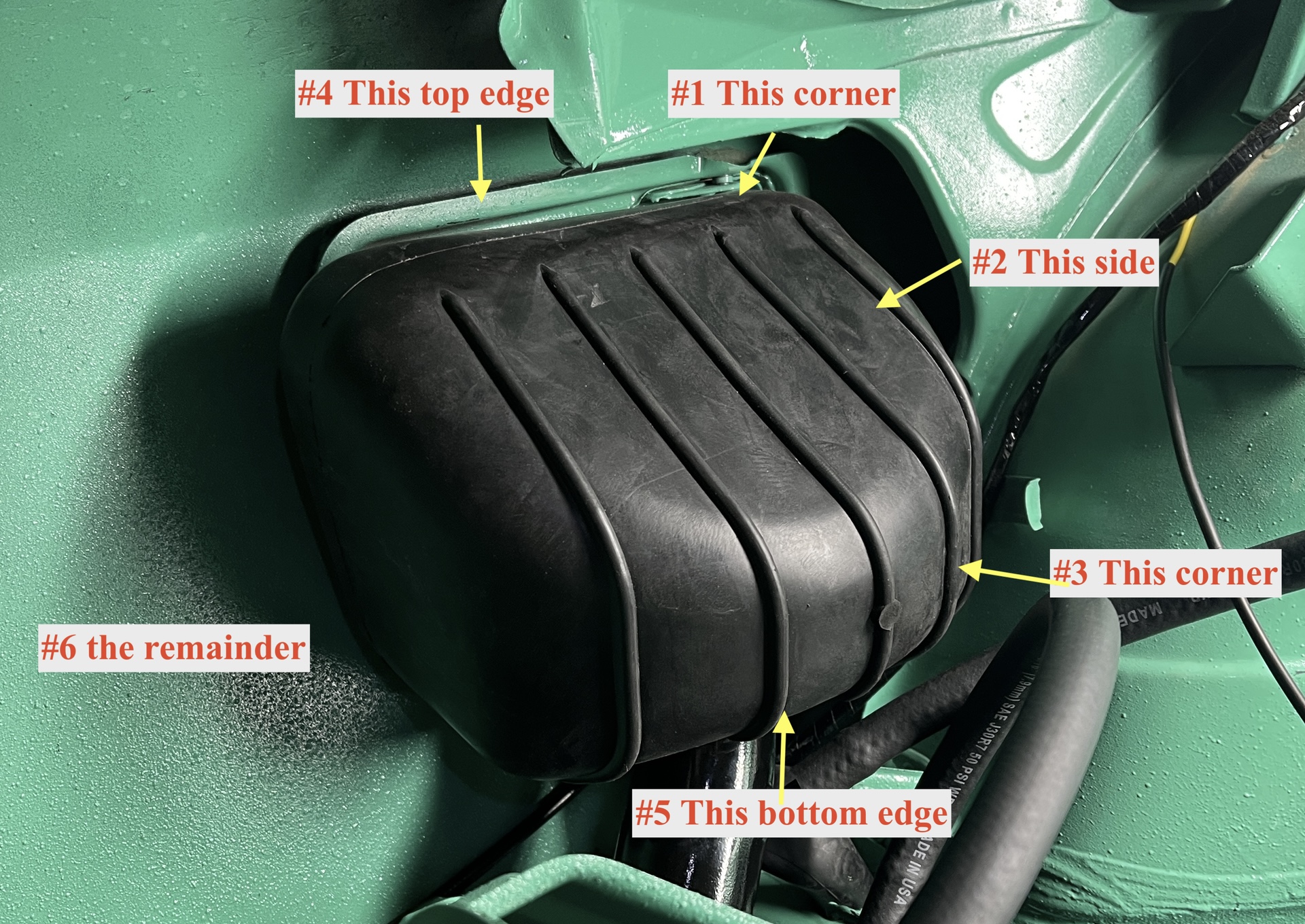

BTW: it is really a PITA to install the Bertone rubber boot. Works only when you heat it up in the sun or in hot water. On alfabb, I found an assembly procedure (thanks to Scott!)
- Posts: 141
