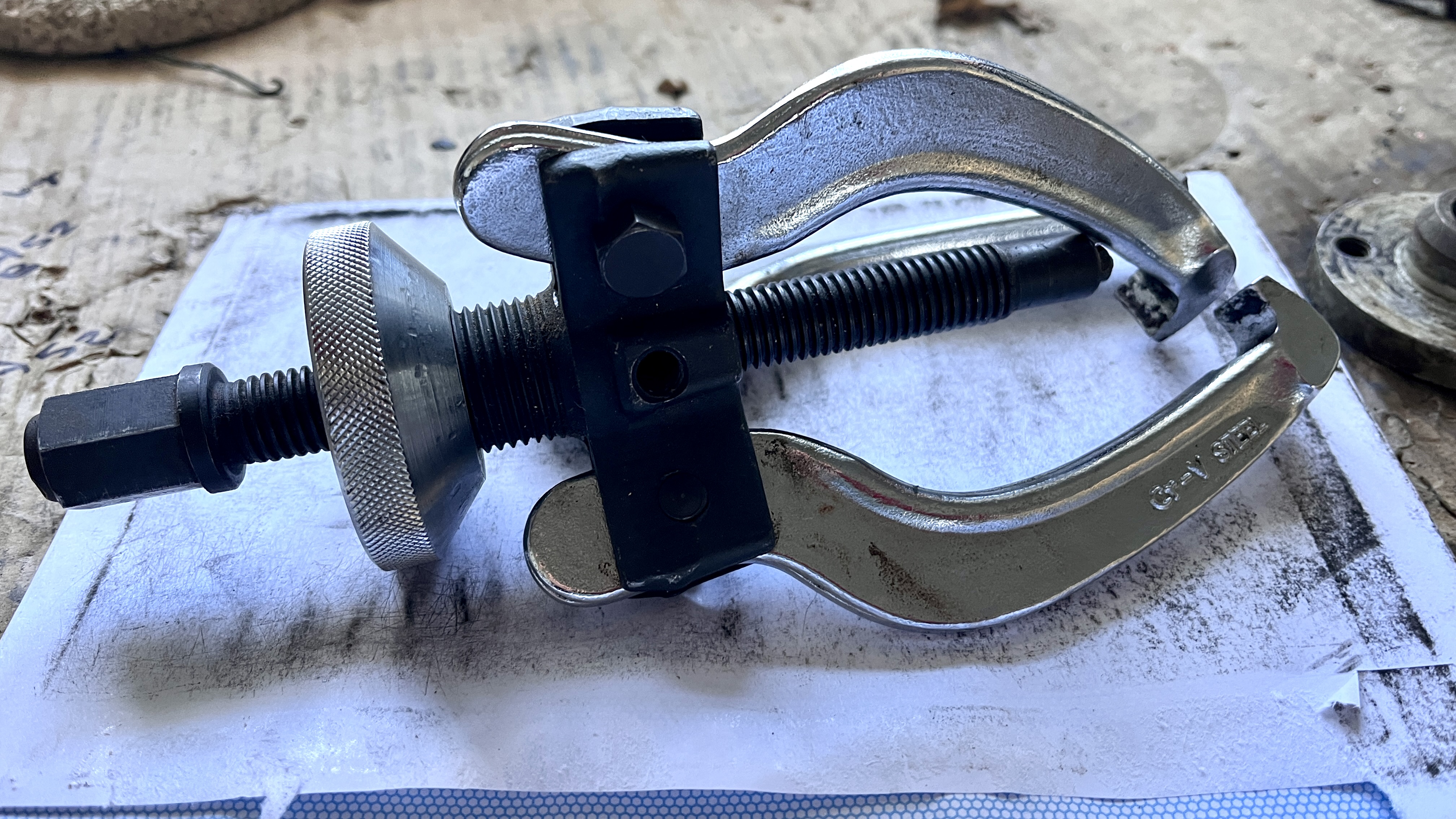

Any solid 3 legged puller. Look for cast steel arms with machined hooks not cast finish as they will slip off. The threads should also be cut and not just cast. I will add a pic of a good quality one I’ve had for 30 yrs, when I go to my shop.

There’s no name on this one, but the arms are cast of CR-V steel, chrome vanadium, note the machined not just cast tips and the nice almost square thread.
