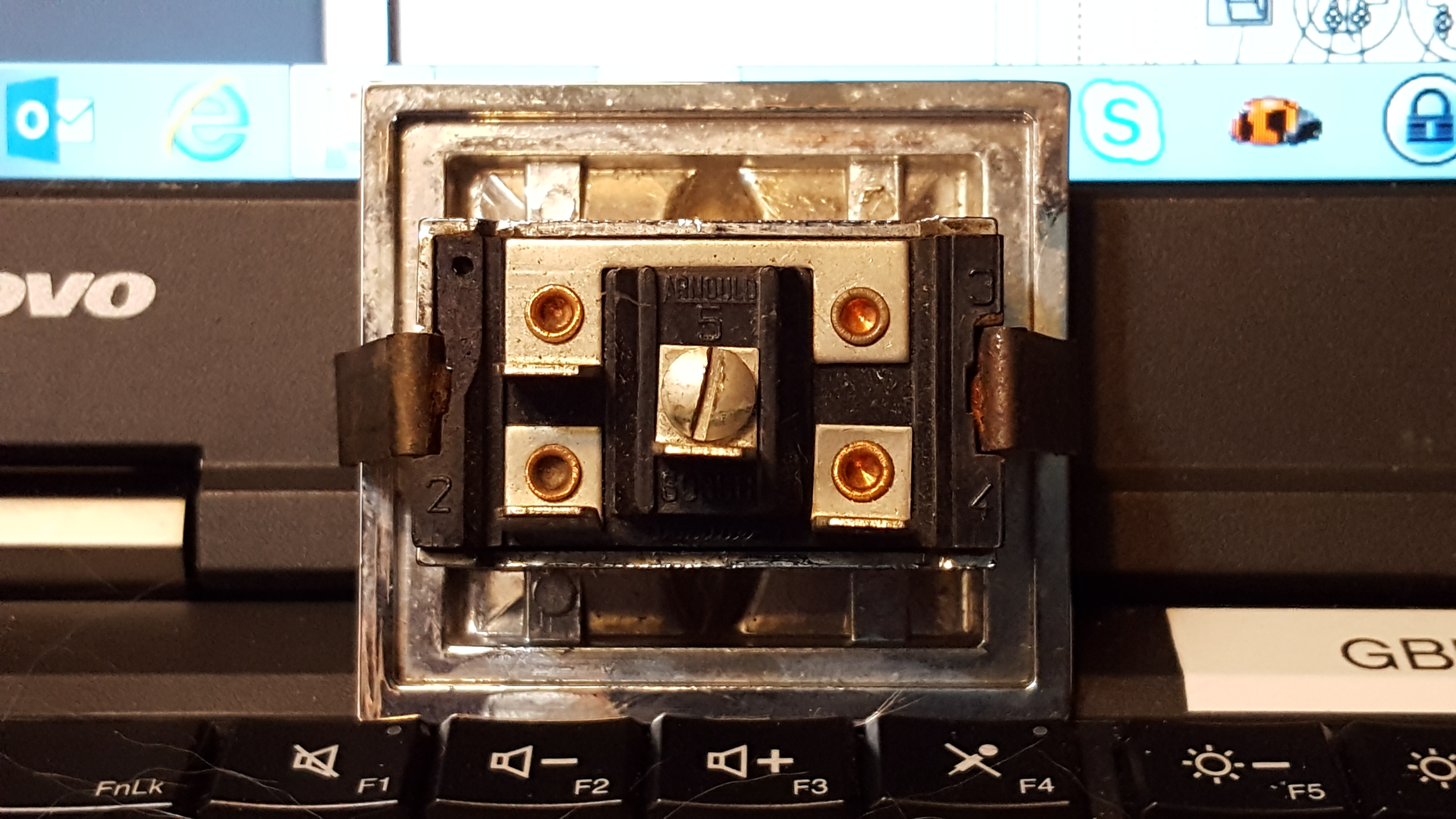

So, how are the Ducellier switches wired? The wiring diagrams are not helping my understanding.
I am using Alfa window motors.
johnharrill
Posts: 73
Re: Options for window switches
Post by johnharrill »
Decided to go with DPDT switches and Alfa window motors.

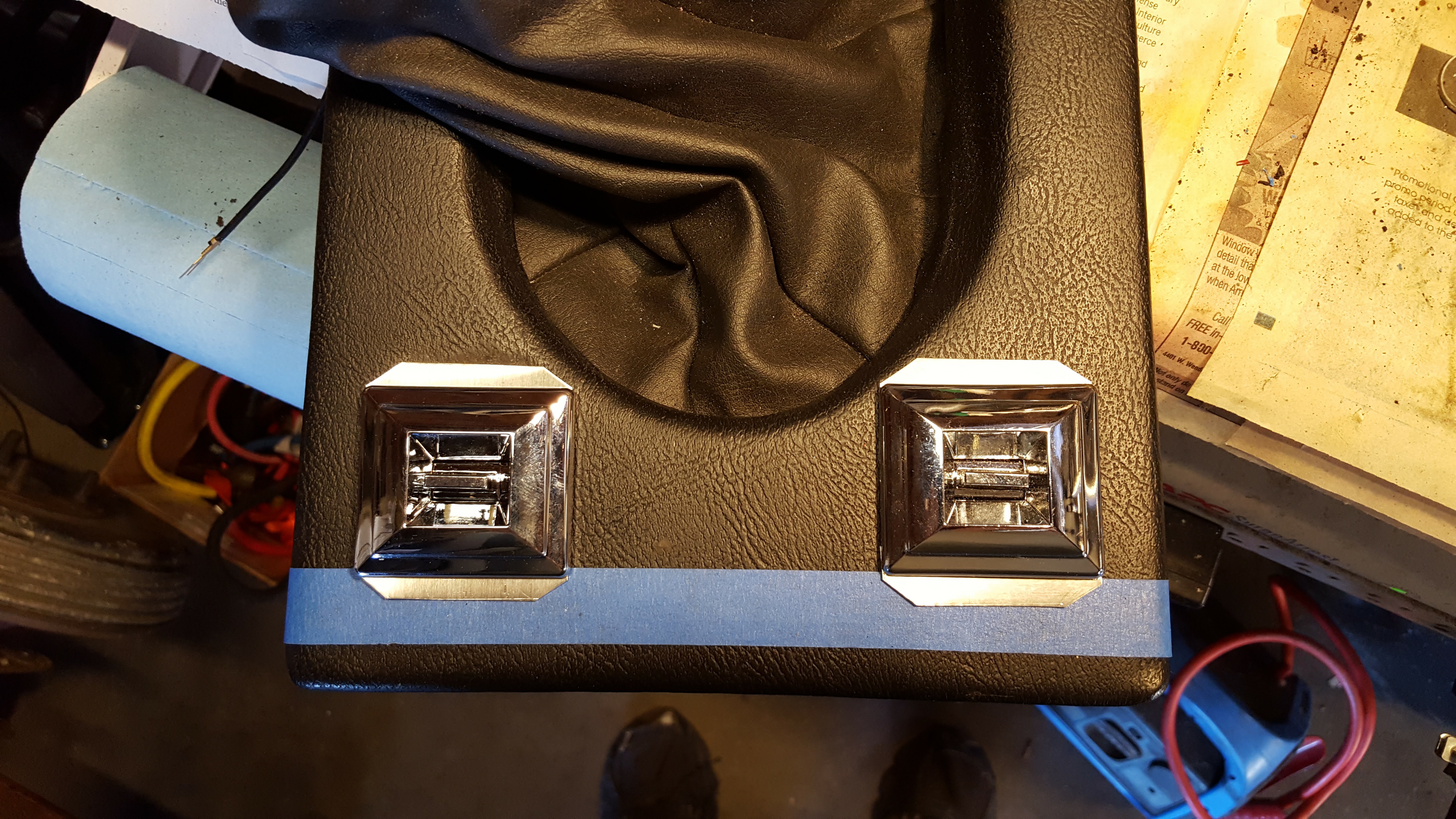

These are from a (Gulp!) 1971 Buick.
