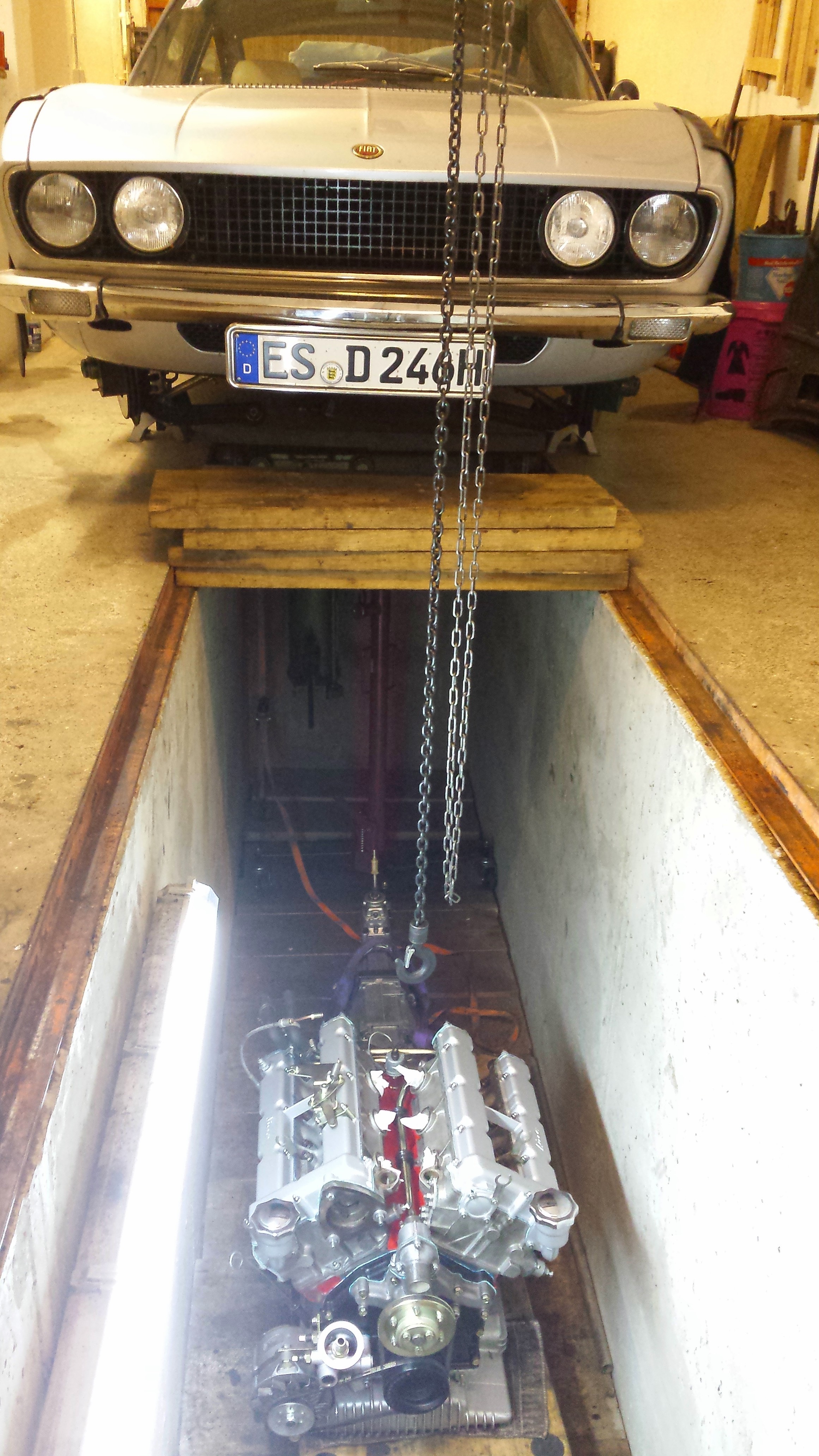

I have Pulled my Engine out and in From below. Works very good with my pit and a crane on the ceiling. Lower Arms and all steering Arms have to be removed as well as the exhaust System and the Part that sits unter the Engine where the lower Controller Arms are connected to (dont know the englisch Name for it) and the stabiliser bar. Works Pretty well.

Here is a picture....

Great looking Coupe, Thomas.
