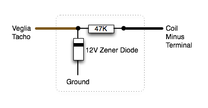

I have a question concerning the tacho of my 1967 Dino Coupé.
It had a perfectly functioning dinoplex ignition and the tacho was working correctly, i exchanged the dinoplex for a 123 ignition and the only disadvantage of this is that my tacho is not reading correctly anymore, it's showing about twice the rpm. I expect the output signal from the red bosch coil is different than the Original Marelli coil. What's the best way to get it functioning properly with a red bosch coil?
I read some things at dinoplex.org about circuit board replacement but is it possible to get it functioning properly with the Original circuit board and how?
Thanks in advance!

The electronic Veglia tach expects a square wave 12V signal, as coming from the distributor in a Dinoplex factory setup, it won't work with a high voltage pulse when connected to a coil minus terminal. What you could try as a work around is to put a 10K-47K resistor in-between the tacho wire and the coil minus terminal, and a 12V Zener diode between the tach wire (after the resistor) and ground.

Thanks Adrian, i will definitly try. If i use a potentiometer instead of a 47k resistor, am i able to finetune the reading on the tacho?

You could try a 100K potentiometer for finding the best resistance as long as you don't go below 5K to avoid too much load on the Zener. I would just try a 10K, 33K, 47K or 68K resistor and keep the one which works best.

Do i need a special zener diode, i see that for a 12V you can have 0W to 5W
