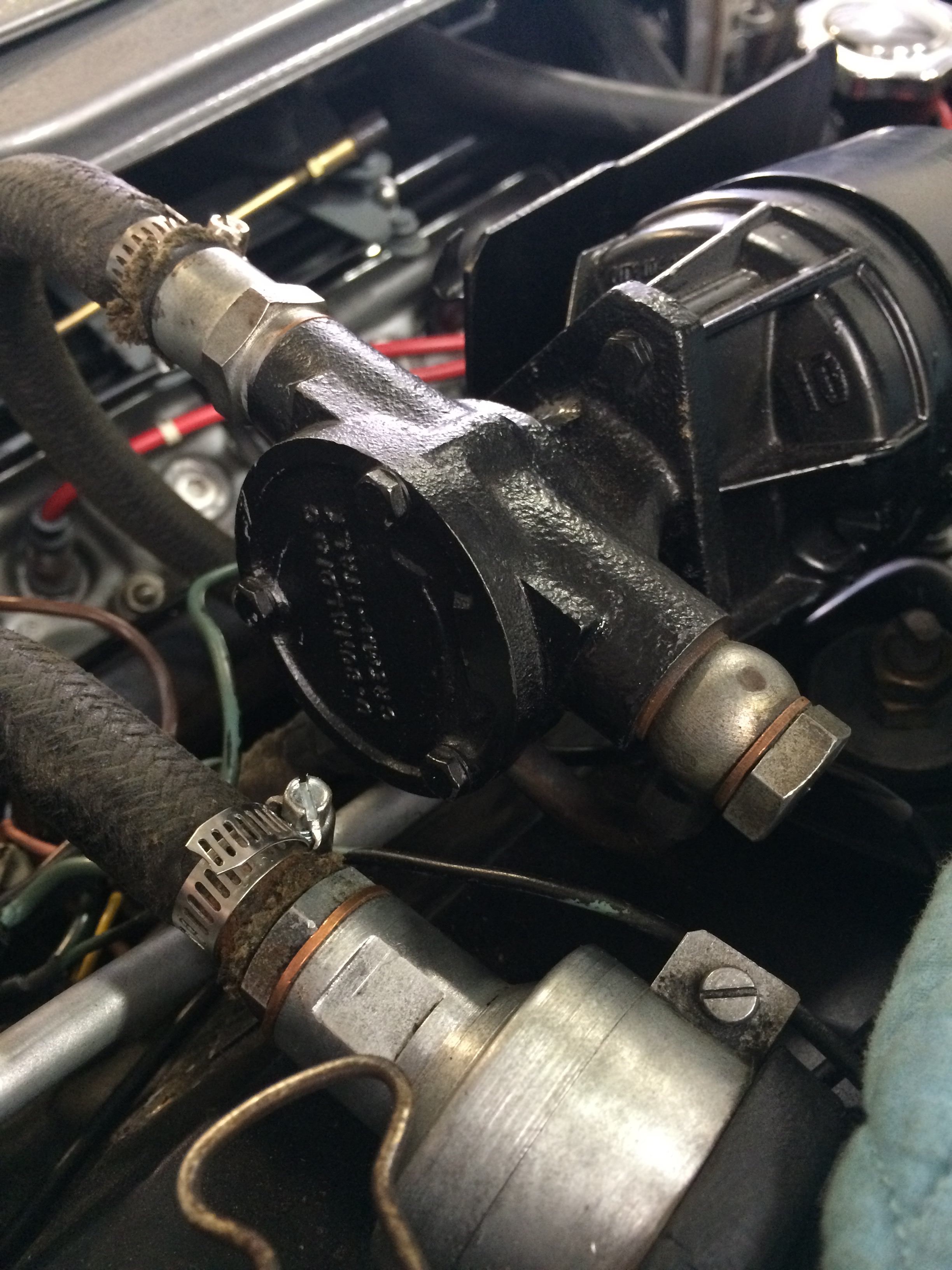

Made some progress in isolating some areas where I could perform some vacuum test on parts of the lines.
I disconnected parts the lines and made sure that my clamps were nice and tight. I manage to hold a 15 lbs of pressure from the pump to the tank.
I then test the line a the banjo fitting near the firewall to the brake booster. I then noticed that our new vacuum reinforced stainless steel hose from supplied by superformance did not have a perfect clamping at either ends.
I got larger clamps and heavy duty seal silicone to help close any potential gaps.

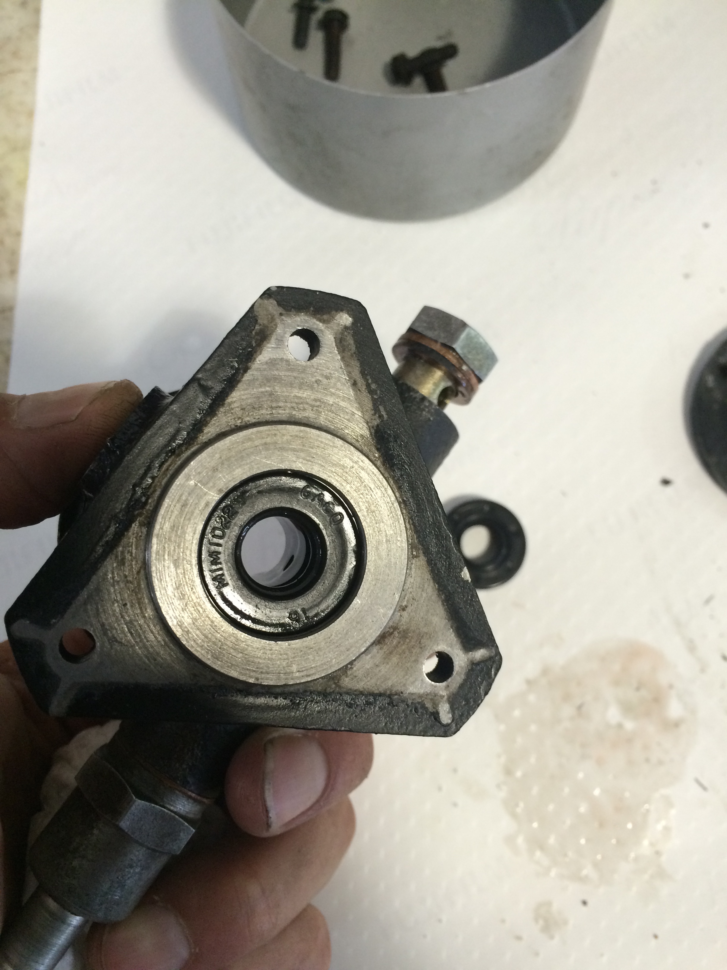

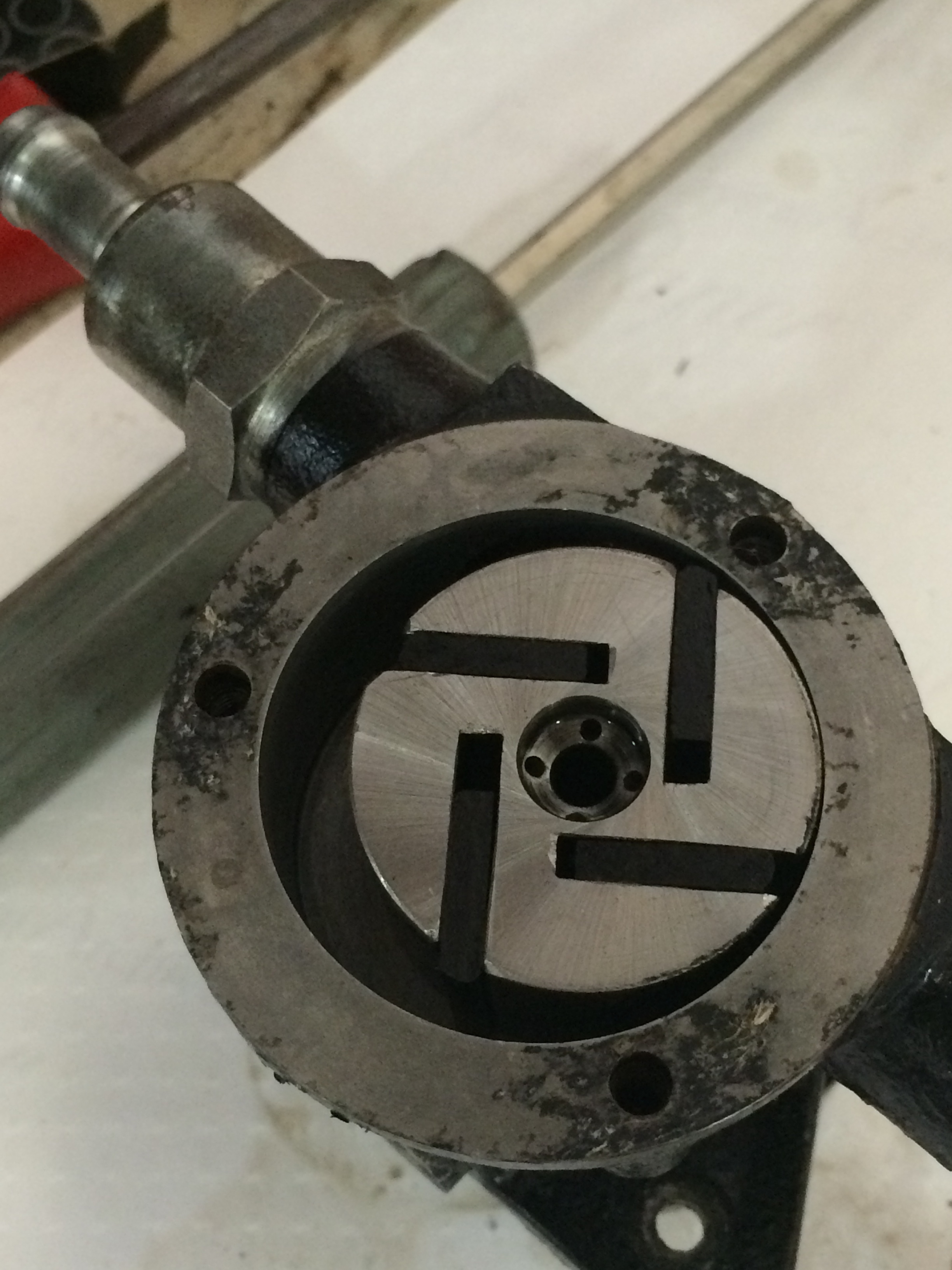

I decided to take apart the vacuum pump.
Replace the de motor seal 1022 " 10 MM inner diameter 22 MM outer diameter.
Here are some pictures. of the impellers, have a look at the position of the offset and the 4 extendable rubber impellers.
Pretty cool, high speed spin sucking air out of one hose and expelling it out into another hole.
It is very important to place this pump at an angle so that no OIL will back flow into the vacuum lines.

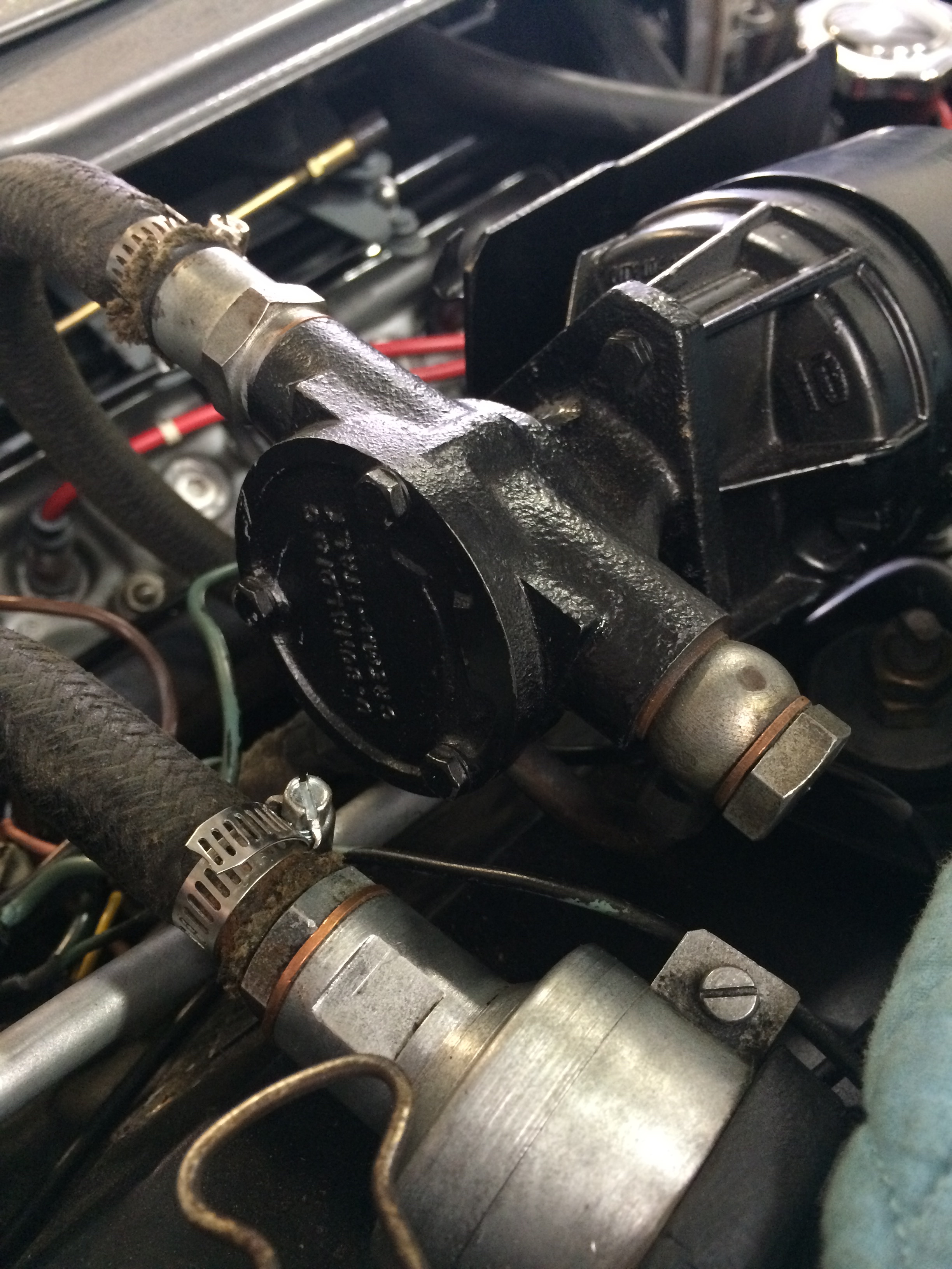

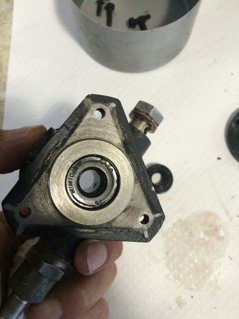

Olivier, nice work.
I suggest you send the faulty hose back to Superformance ASAP. They've been having quality issues from third party suppliers for some time
