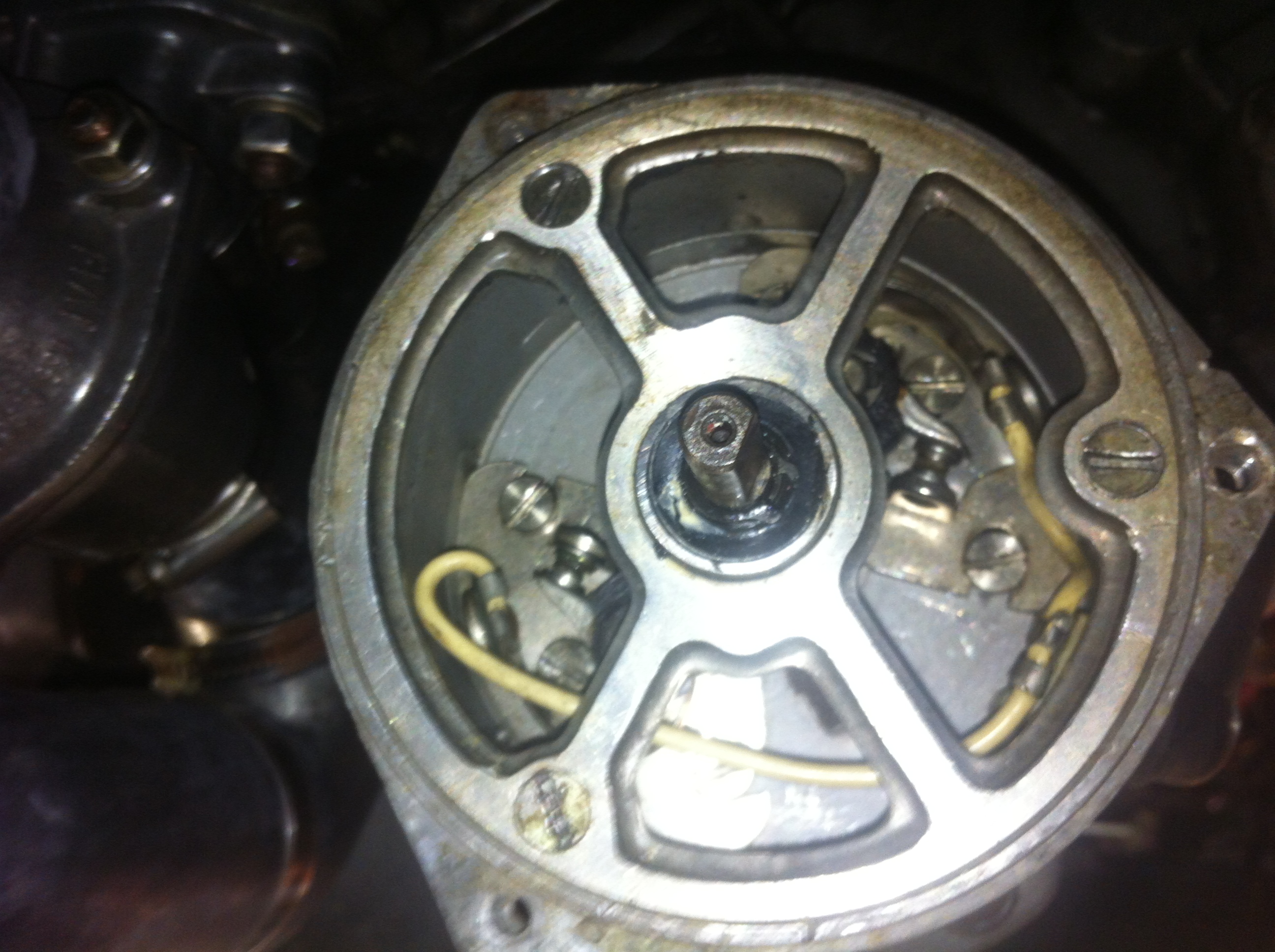

This is my distributor at the moment:

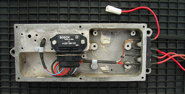

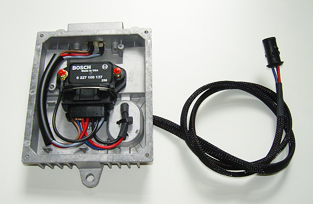

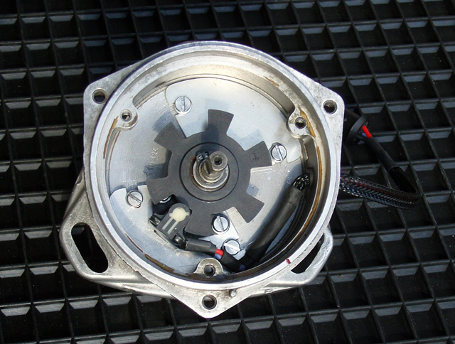

See images below for a S125BX Lumenition conversion, a Dinoplex C AEC101 and a Dinoplex AEC103 converted to Bosch components. The Bosch setup works best with NGK BPR7EIX spark plugs. The distributor conversion is a bit fiddly if you haven't done one before, but Bob Stewart in Germany offers S125 Lumenition conversions including the material/pickup for €200 if you mention my name.

S125 converted to Lumenition Optronics Pickup
S125 Lumenition Conversion.jpg (164.84 KiB) Viewed 23482 times
Dinoplex C converted to Bosch components for a S125 Lumenition Distributor
Dinoplex AEC103A converted to Bosch components for a S125 Lumenition Distributor

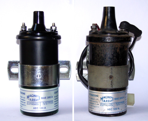

Mail me your postal address and i'll send you the correct Marelli coil sticker for a 2.4 Coupe with a factory AEC103. Photo of a repainted Bosch (left) and original Marelli coil (right) attached.
