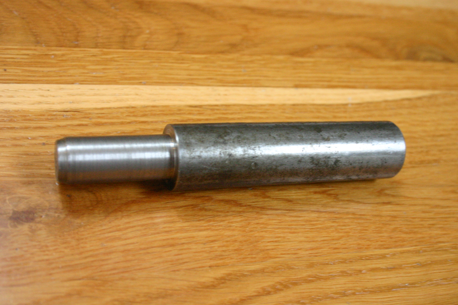

Would anyone know where i could fine a clutch plate alignement tool for my spider 2400? trans output shaft has 22 teeth..
there are a numbers of plastic alignment tools in my tool box, but none is correct..

DIY. Any skilled turner will make you this tool on his lathe. The teeth on the tool are not necessary as long as the outer diameter is about 0,3mm smaller as the inner diameter of the teethed clutch plate.

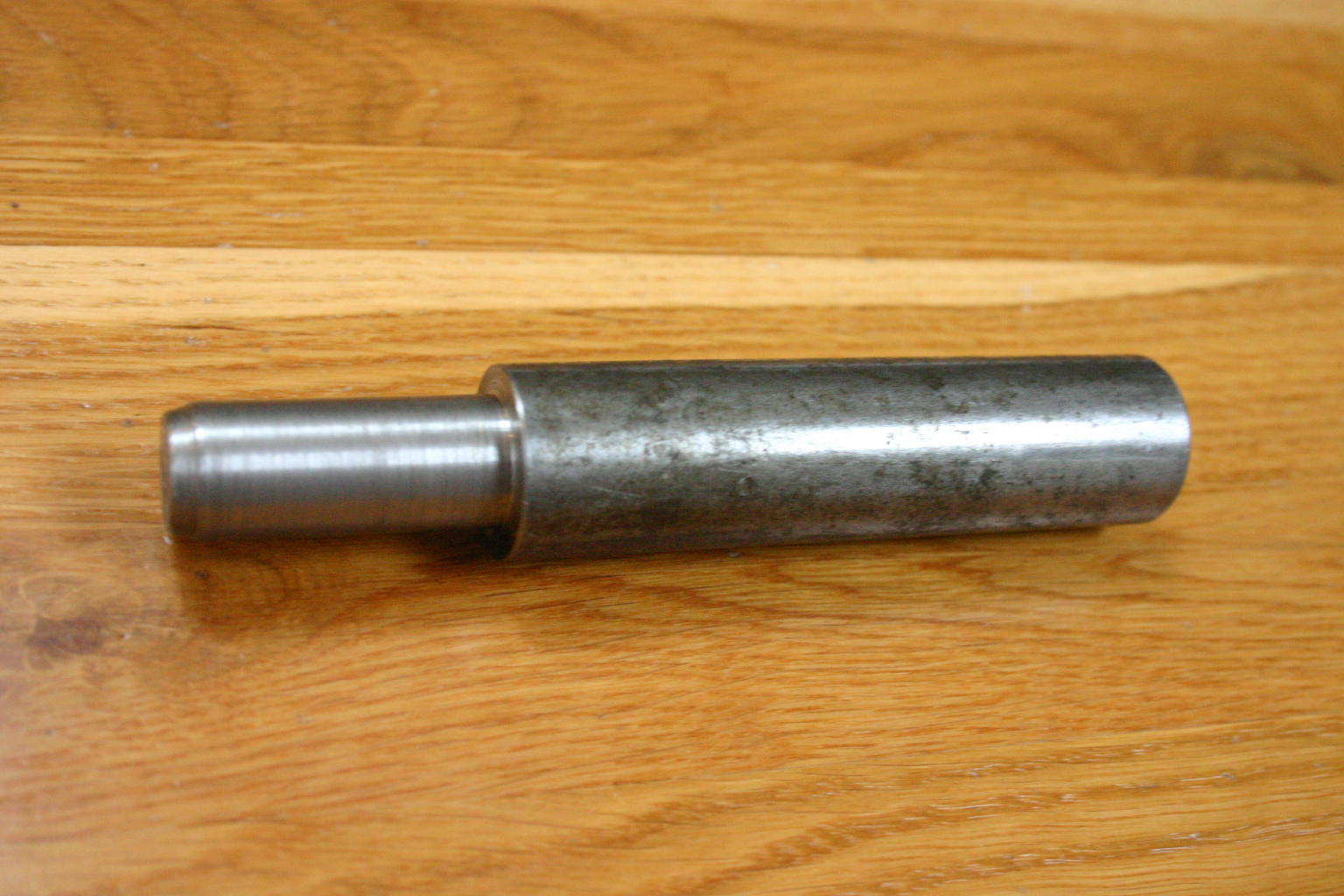

#5 for mazda works perfectly..
