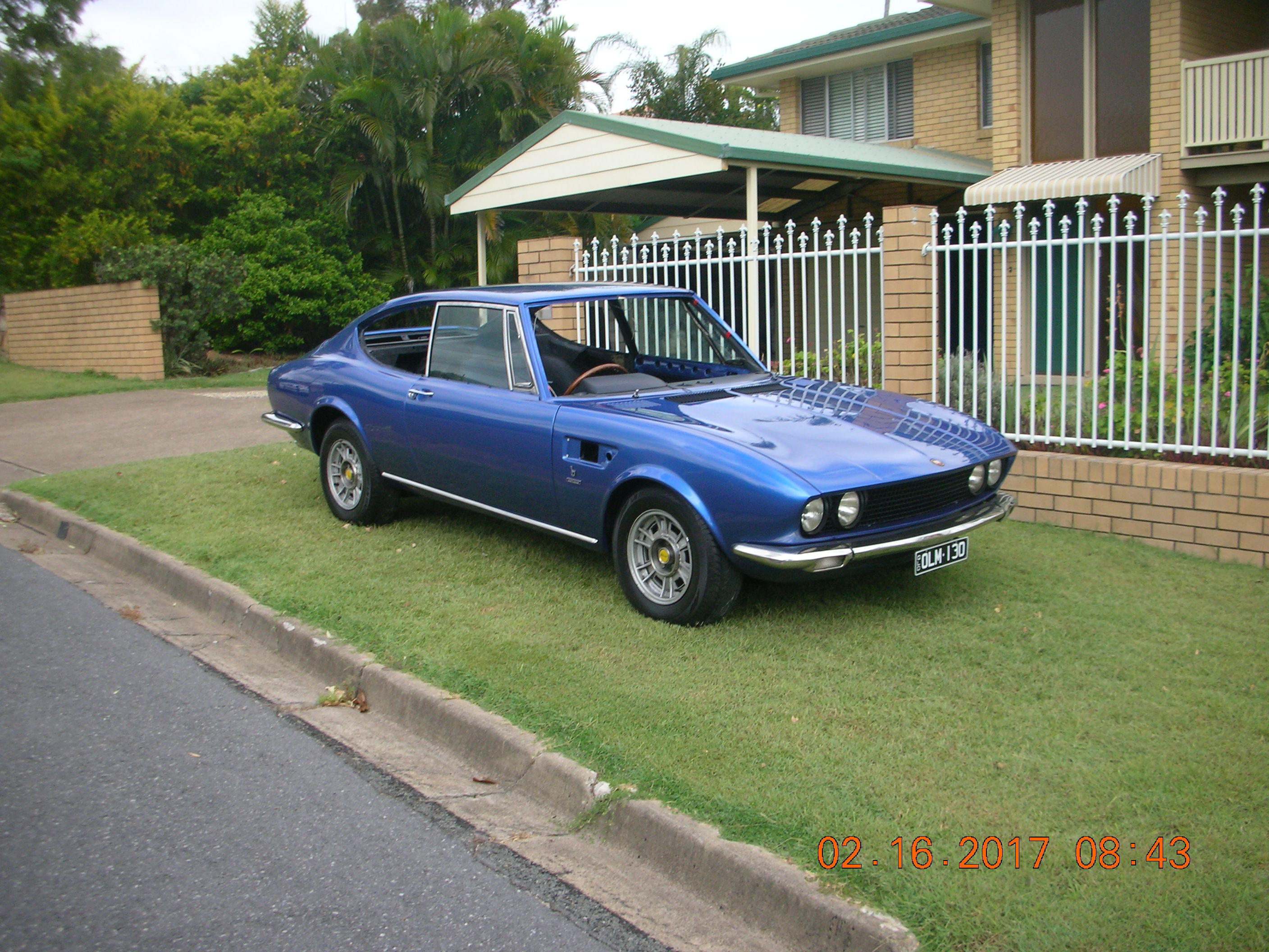

maduno
Posts: 20
Re: Windscreen Fitment
Post by maduno »
In the end , both screens went in with a lot of neat detergent. The rear screen was installed with the moulds in place, but i had to put the bottom mould in after on the front screen.The rope helped but not to the extent I thought it would.A little flat screwdriver is definitely needed to get the mould out in position in various places.
