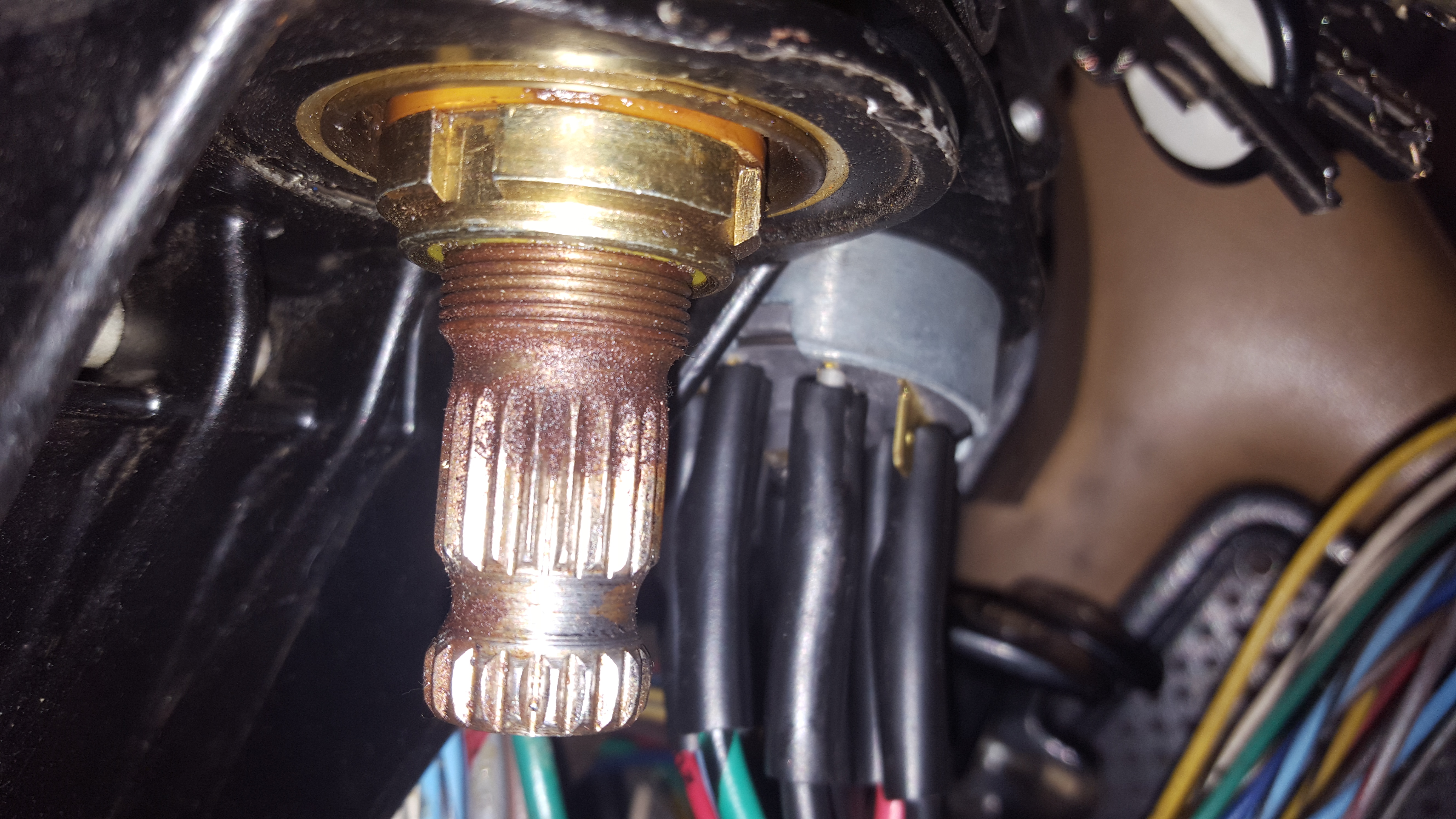

Hi Gary,
today I was trying to replace those cup bushings in my steering column too, but
I did not manage to loosen the lock nut shown on the picture attached to this post.
How can you loosen it? I guess that there is a special tool required, am I right??
And another question: do I also have to take out the ignition lock?
Bijan

Re: Wobbly Steering Column
I remember this being a simple procedure, But your picture introduces elements that seem unfamiliar to me. Perhaps the procedure you are using is producing, or trading off difficulties? I remember doing mine with the steering wheel support carriage on my workbench - not in the car. Did you remove the steering wheel? It is not apparent from the photo. But this needs to be removed - then the circlip and the rest should present itself as very basic. My recall is not great most likely because there were no difficulties encountered which applies to 2 cars, coupe and spider done at different times.

Hi Gary,
yes, of course I removed the steering wheel and the circlip you are mentioning.
The upper bearing is then easy to remove, the lower one is blocked by the lock nut
shown in the picture. Of course it is easier to do that on the work bench, but this involves
the removal of the ignition lock, which I actually wanted to avoid.
Looking at the generally poor quality of the cup bearings I asked myself if it doesn't
make sense to replace them by higher quality roller bearings. Has anyone done this
already?
Bijan
I unmounted the carriage yesterday and dismantled the whole assembly on the workbench
which was indeed quite easy. The lock nut can be removed by using a circlip
pliers - no special tool was needed here in my case -
@Johnharrill:
As Gary said already it is crucial that there is no clearance between the circlip and the
upper bearing. If there is clearance your steering column will wobble. You can adjust the
clearance with the lock nut shown on the Picture posted earlier OR you can use washers.
I have not followed the path of using alternative roller bearings for this purpose since I could
not find any bearings with the correct outer diameter. There are SKF standard bearings with the
outer diameter of 37 mm, but we actually would need 36,5 mm for a proper fit...
Bijan
