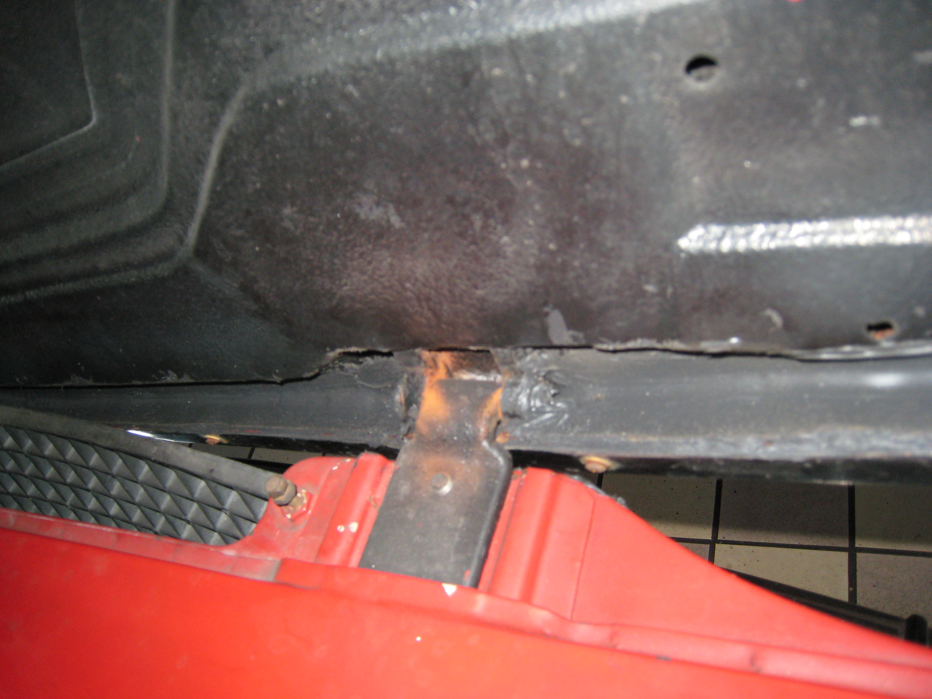

Hi Darren,
Unfortunately, I'm not at home at the moment and can check the Dino for more Infos, but I've found this picture. Maybe it helps a bit.
Regards,
71Dino
Posts: 26
Joined: Sun Jul 06, 2014 11:19 pm
Re: Bonnet/Hood Fixing
Post by 71Dino »
Thanks Tobi
Thats a start, it must be bolted from the bottom as the hole doesn't appear to be threaded.

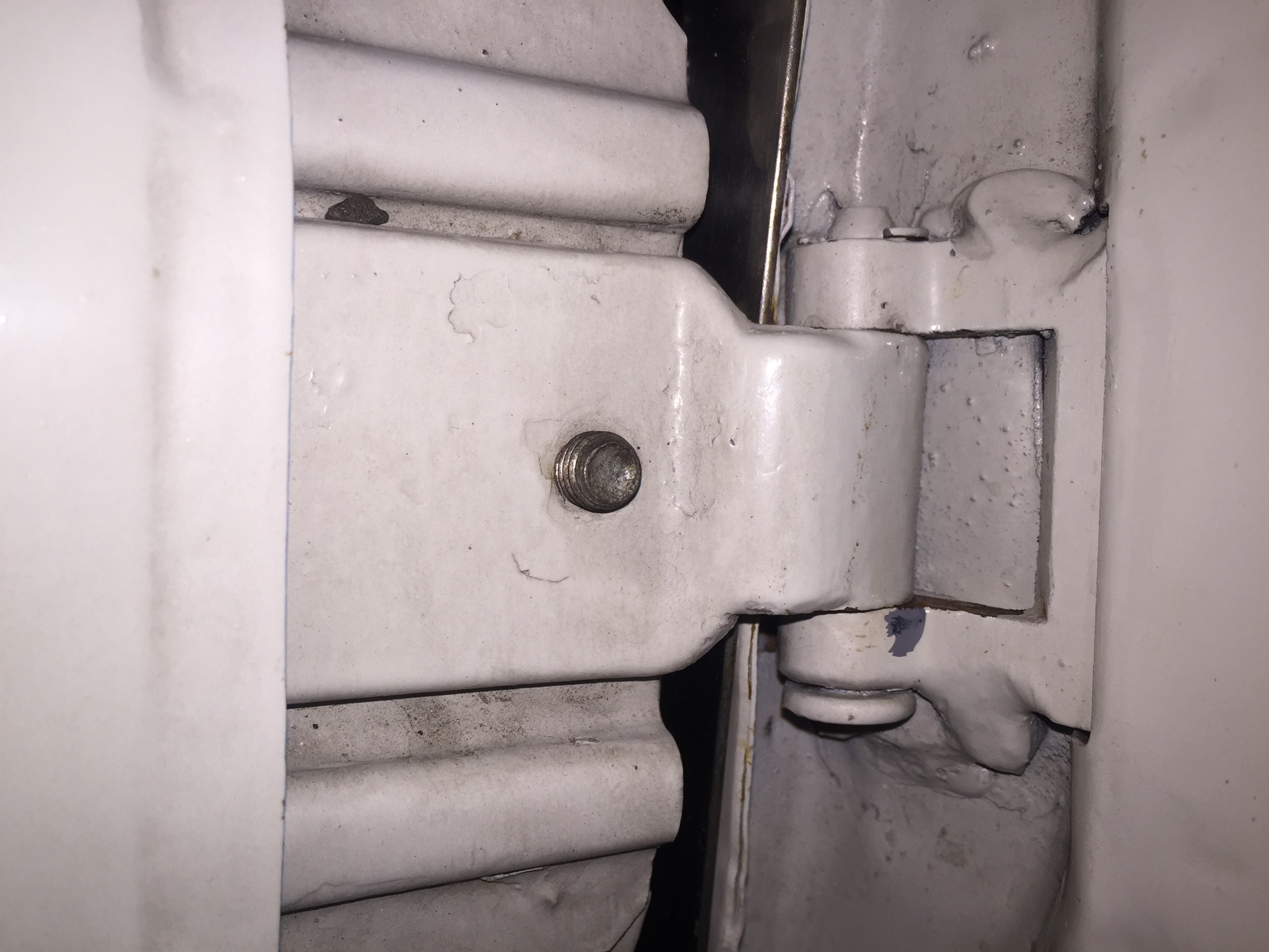

wabern
Posts: 2
Joined: Sun Apr 26, 2015 7:53 am
Post by wabern »
so its mounted in my Dino
hope this will be helpful
Hans
71Dino
Posts: 26
Post by 71Dino »
Thanks Hans
That makes sense now, its bolted from the bottom.
