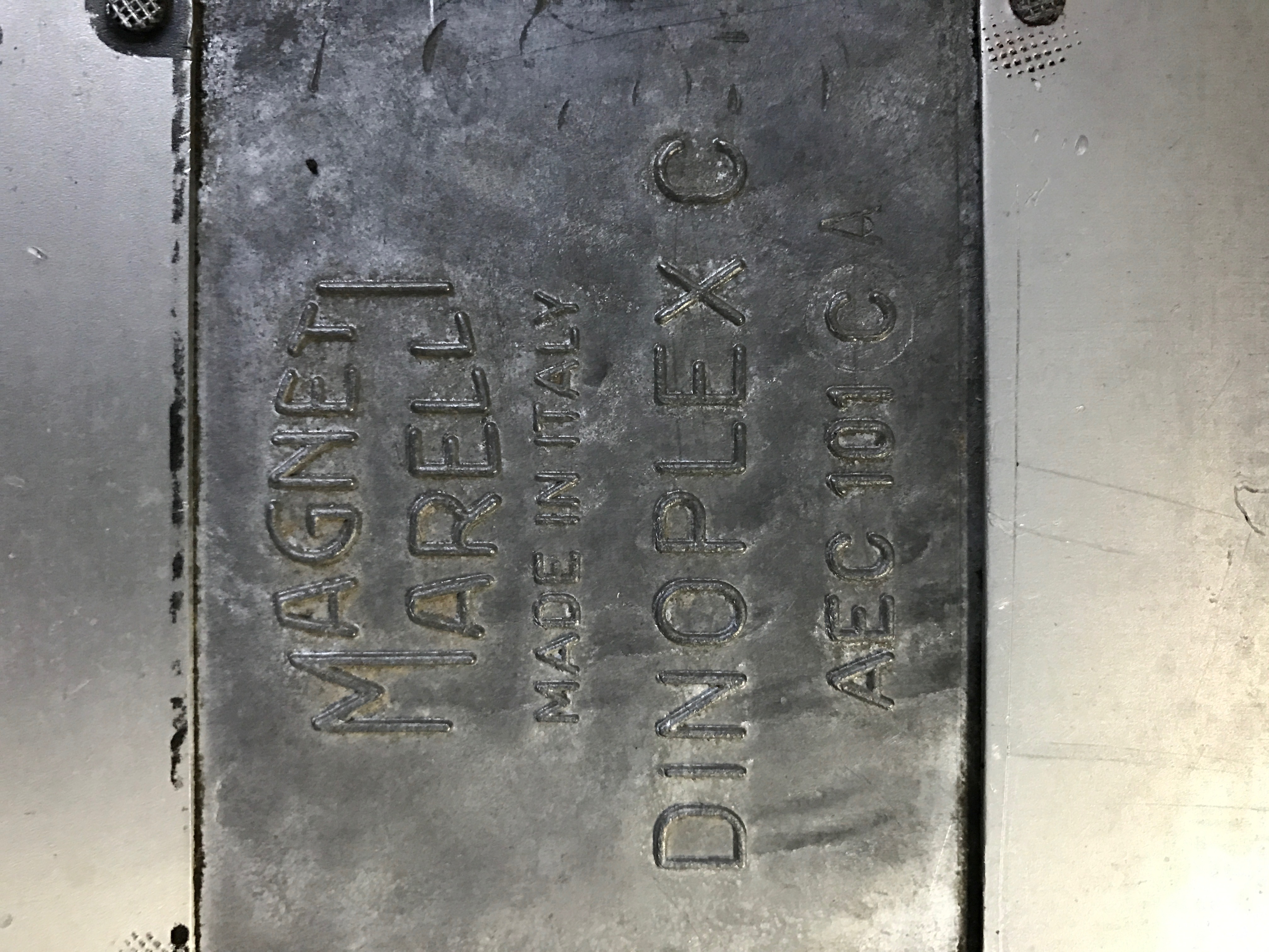

4) It appears that this unit is a AEC 101 CA...what is the difference between it and the model correct AEC 101 C?

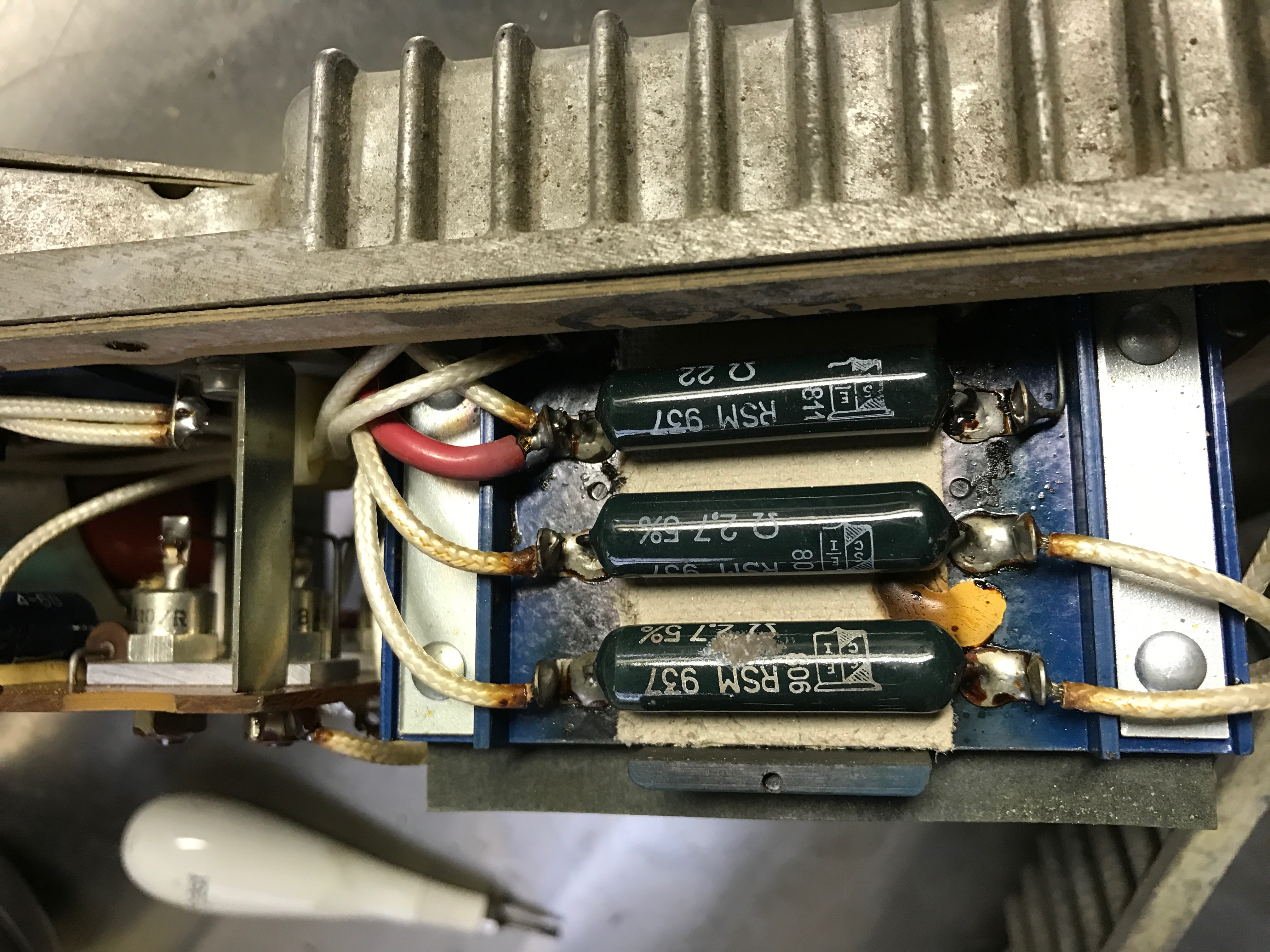

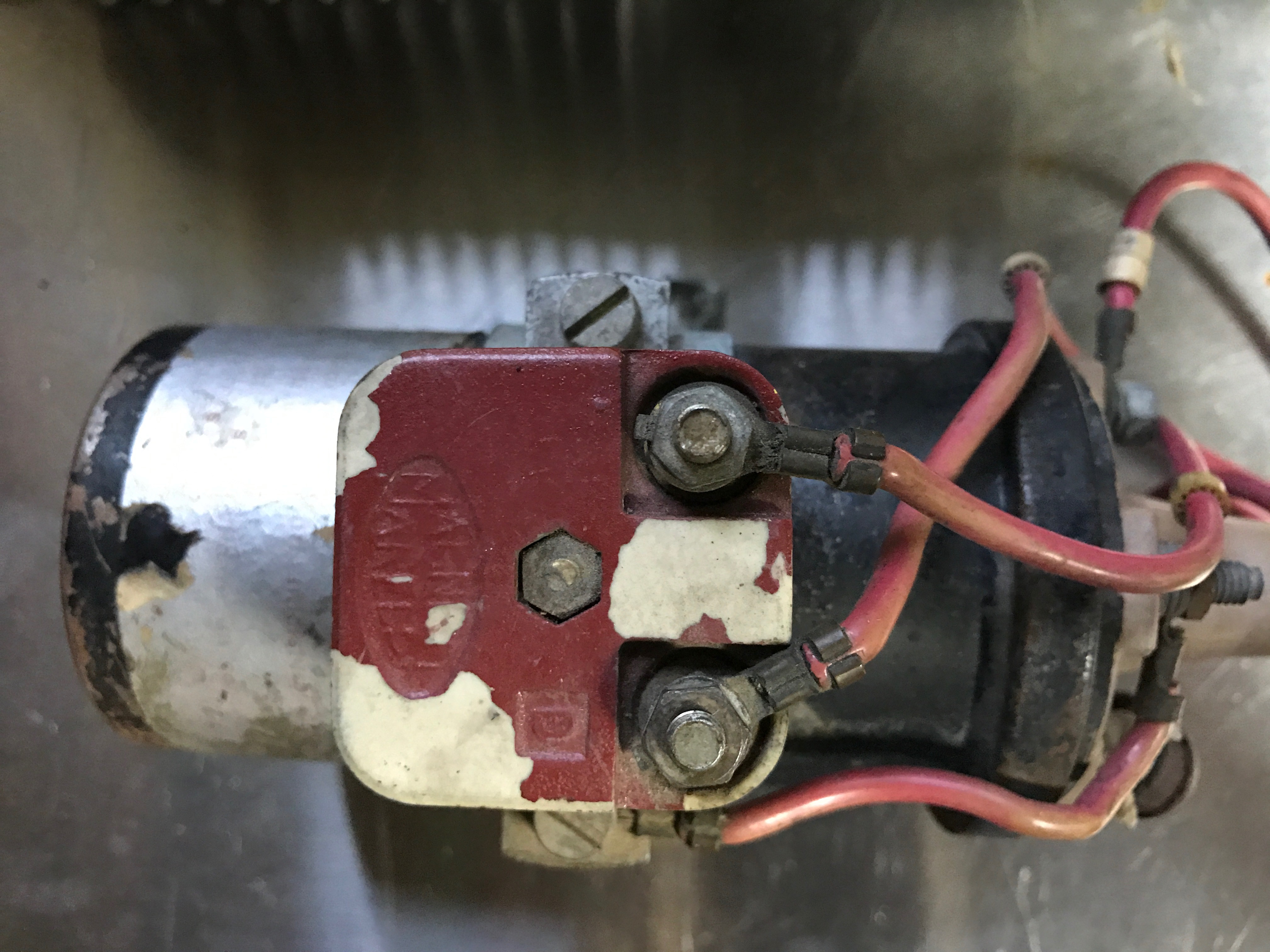

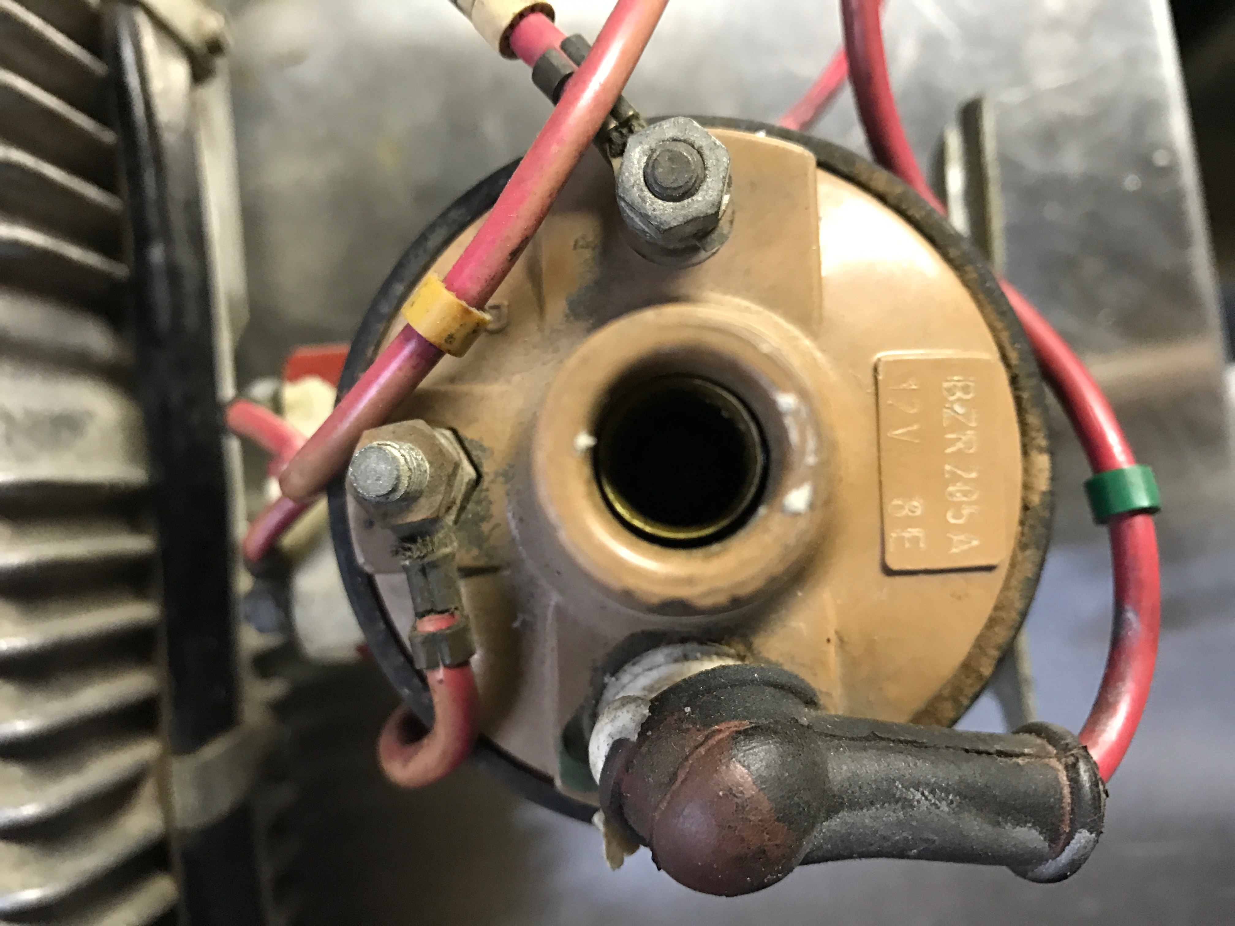

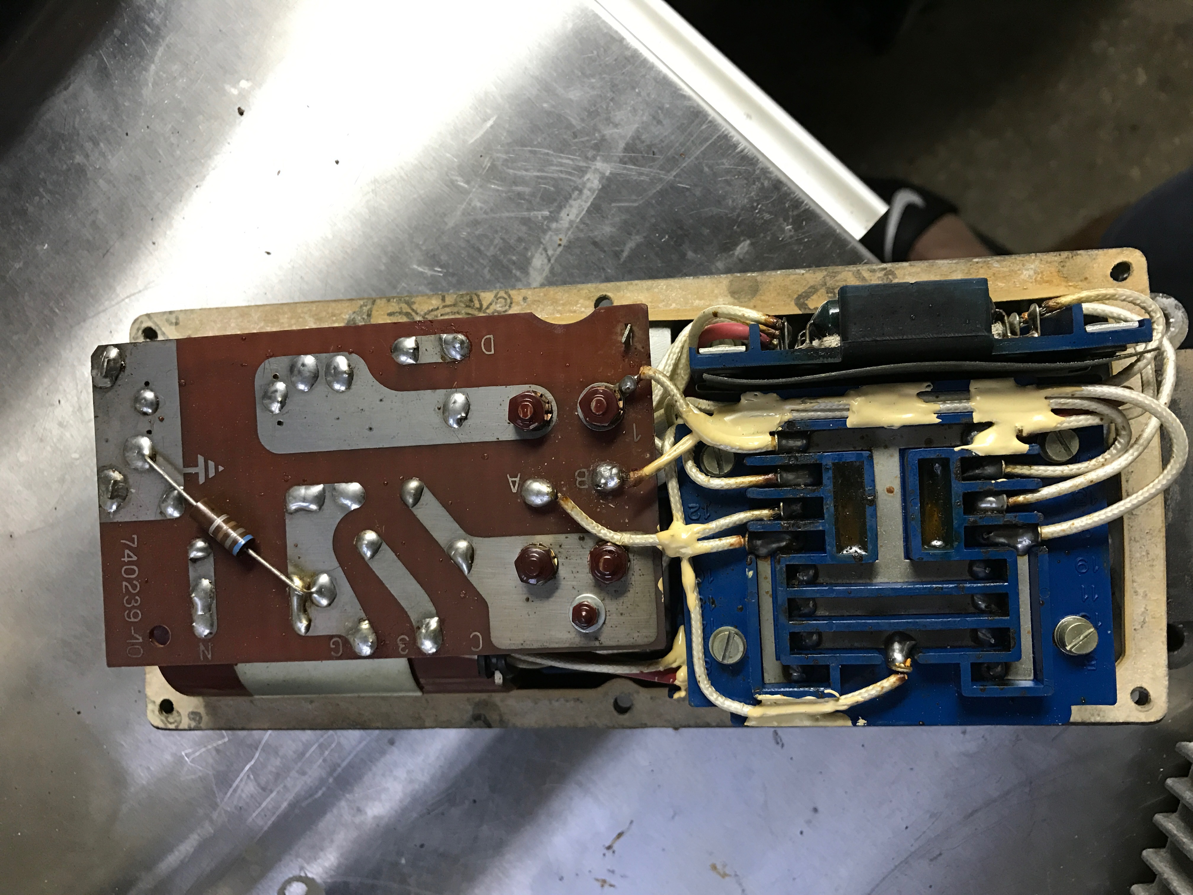

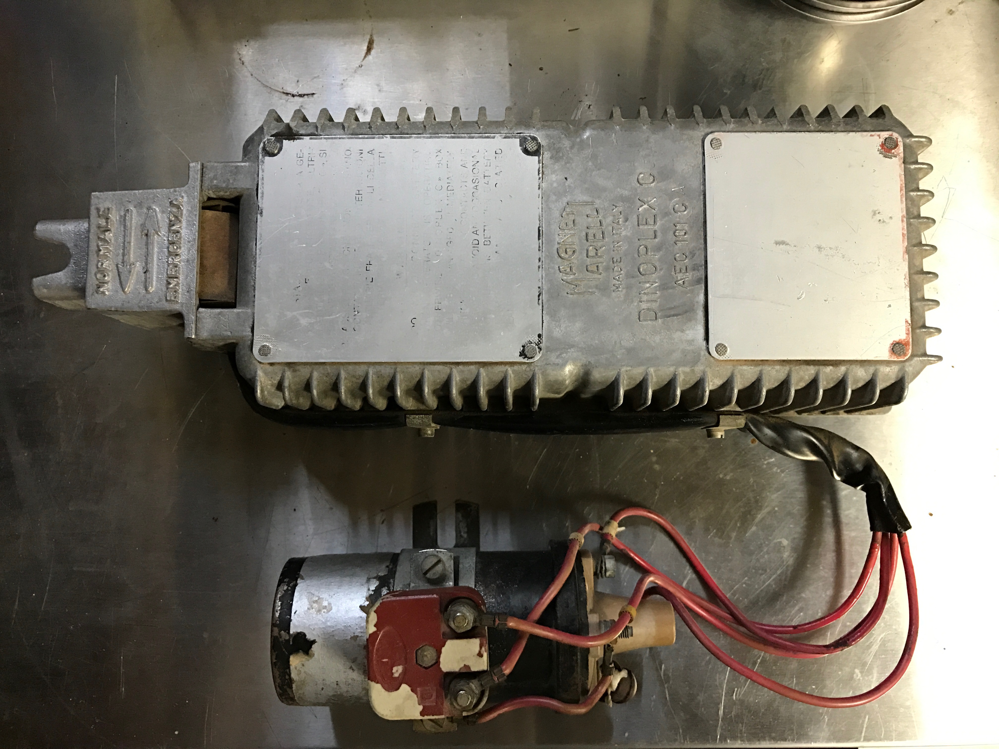

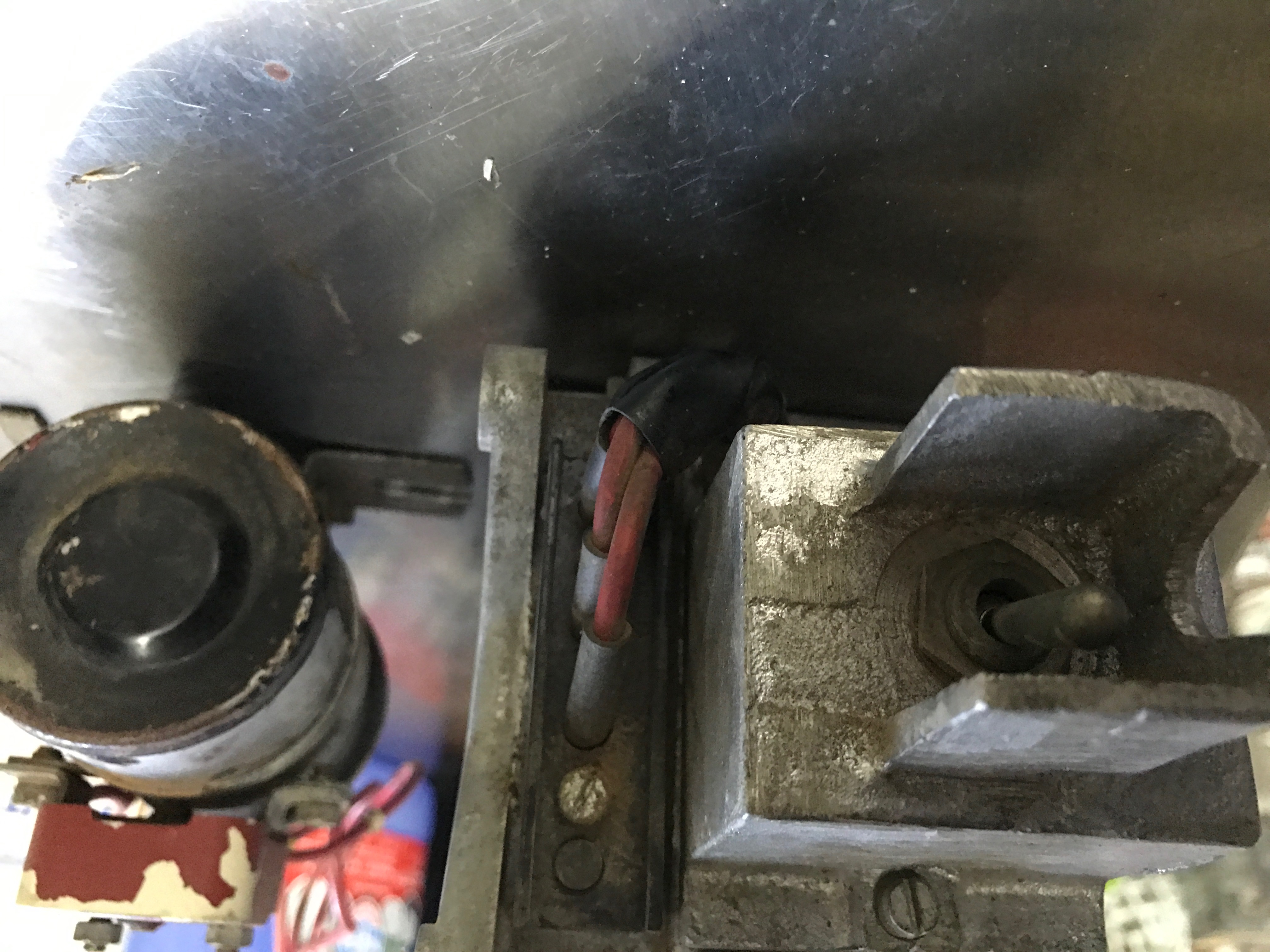

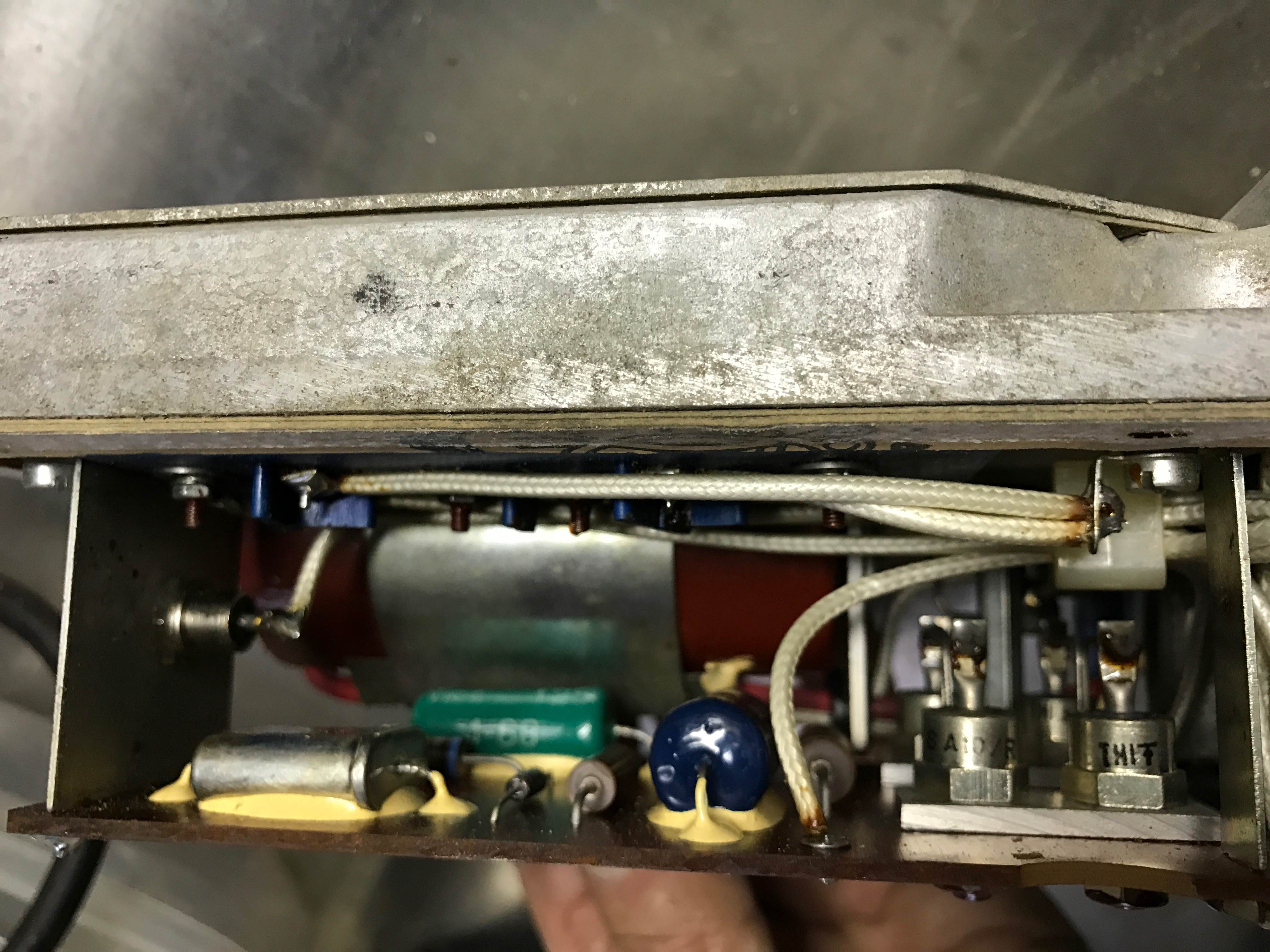

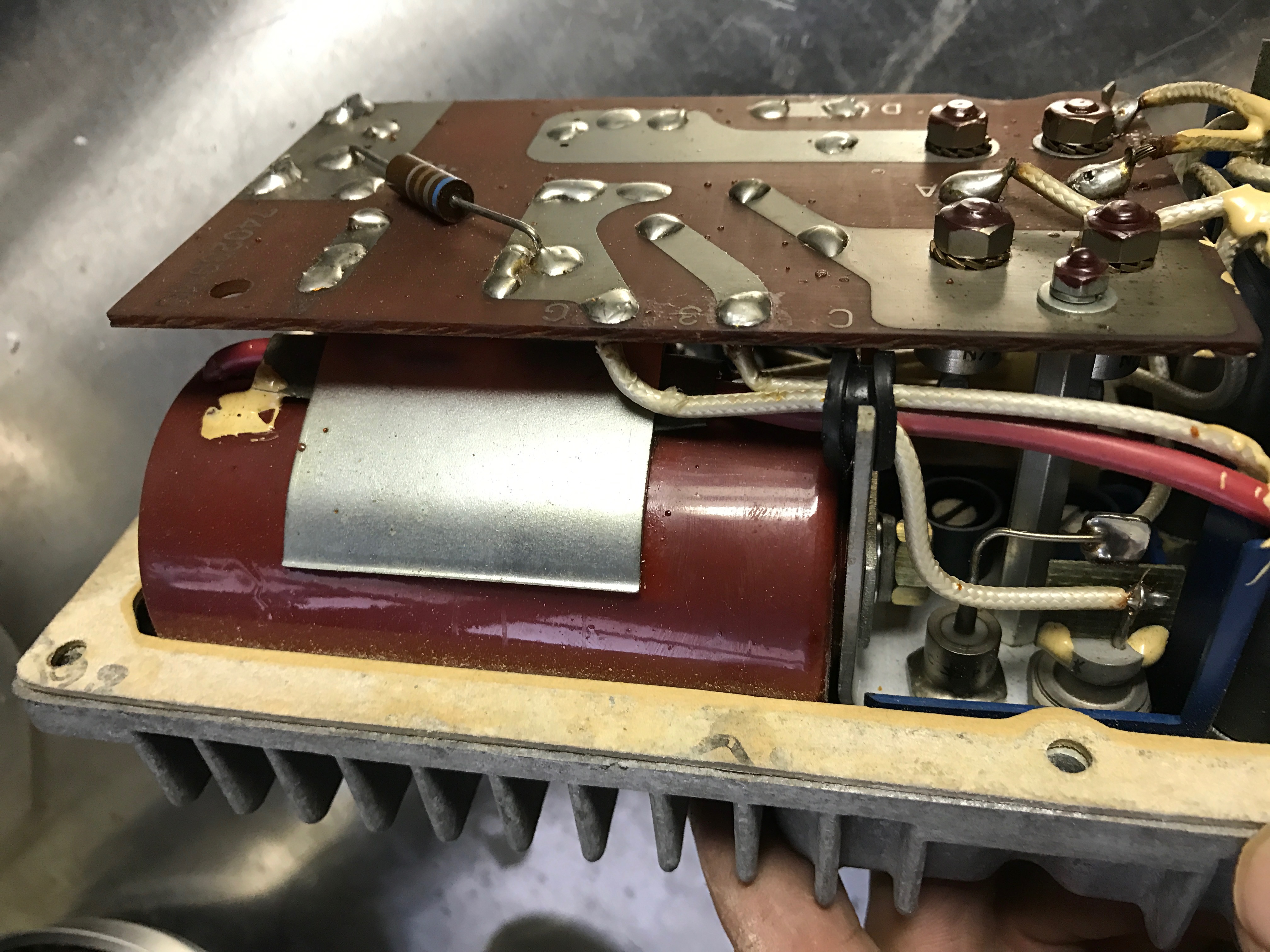

I am posting some photos of the unit and coil for reference.

1) Just install it (temprorarily) to check the function. It's wired in a few minutes. If you like originality, don't do too much cosmetic restoration. New type plates and stickers would be available from Superformance: http://www.superformance.co.uk/fiat/ignition.html
2) I don't know, but the Dinoplex should be intalled on the fender, not to the firewall.

4) http://www.dinolex.org answers this (and many other questions).

I agree, I don't want to overdo the cosmetic restoration. My goal is to make it look as period correct with some patina.
Does anyone know the correct color and/or paint finish for the coil itself as well as the top connector block?
If someone has photos of an original that is good condition that would be much appreciated.

Re: Guidance on Restoration of Dinoplex AEC 101 CA
Your coil and the attached ballast resistor still have the original colors. You may keep the patina or redo them with new paint and a new label. You also have the original cables with their marking rings. Clean it and keep it as it is as long as everything is working.
