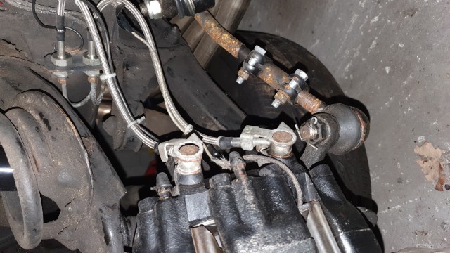

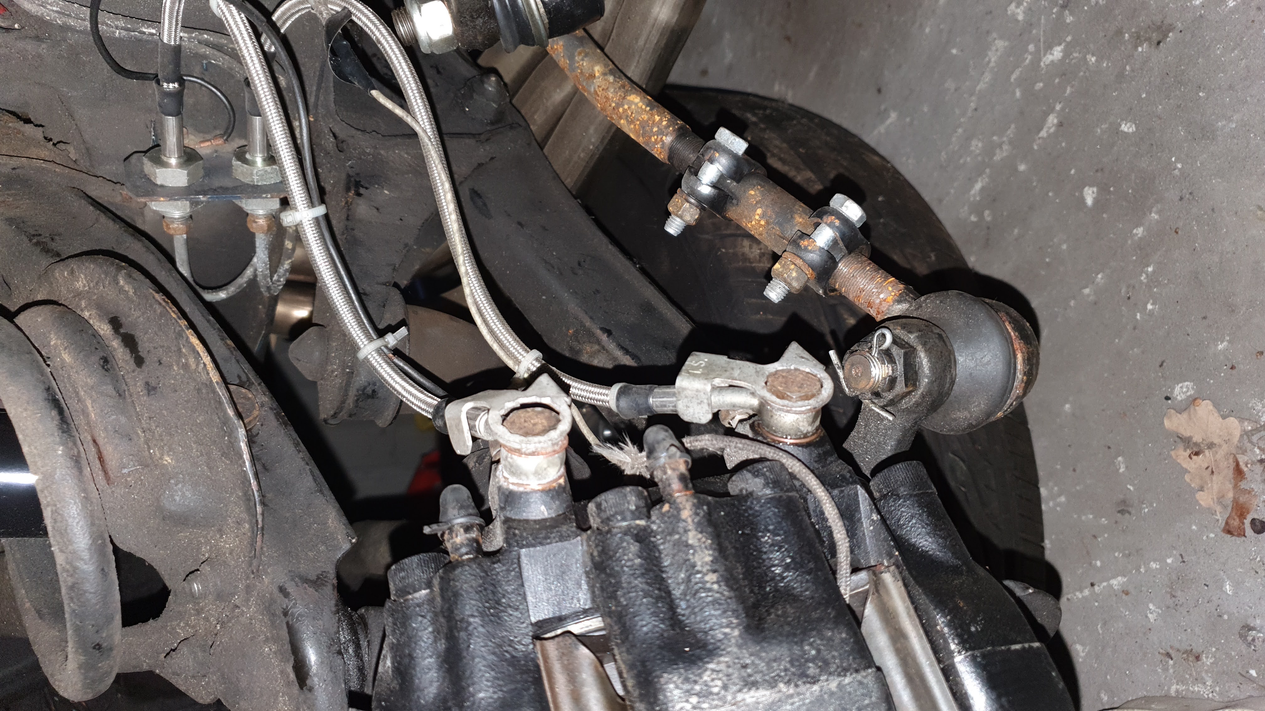

Bijan
Posts: 54
Re: Alignment brake hoses front, Fiat 2400
Post by Bijan »
...just coming back from the car. If I mount the brackets like this it looks like shown in the picture below.
As you see, no tension on the hoses at maximum angle which is fine, but I am a bit worried the hoses might touch the springs
once the car is standing on it's wheels again...
Cheers
Bijan
