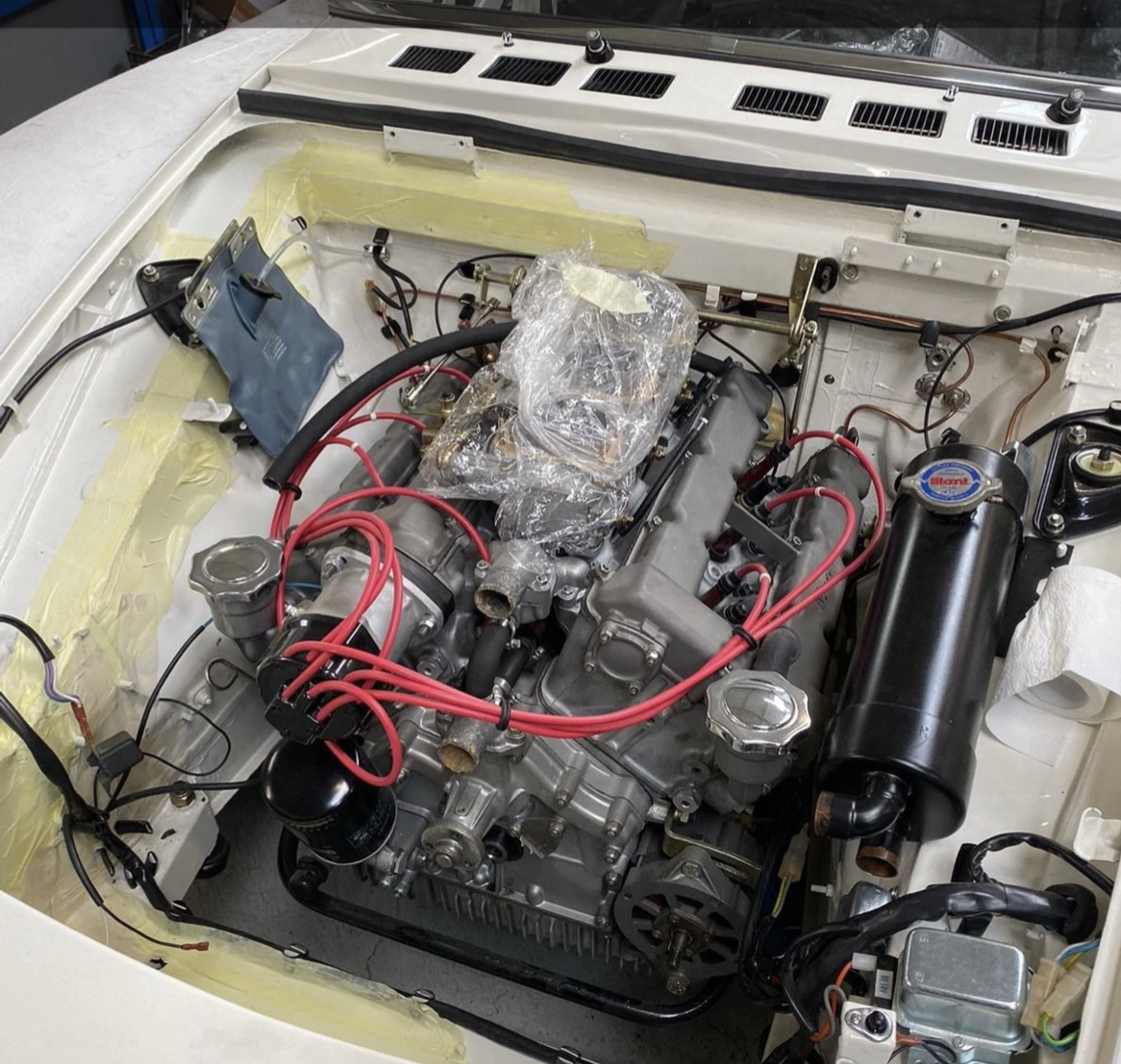

The lack of pictures of any structural repairs, is the thing that would concern me, although the other cars that are in the restoration shop, look pretty high end, so maybe they had the ability to do the job properly!

Looking at the inner water channels (e.g. thermostat housing ) in detail this does not look like a proper restoration, more like cosmetics.
Really concerning is the lack of any documentation of sills, A-posts and other structural areas.
