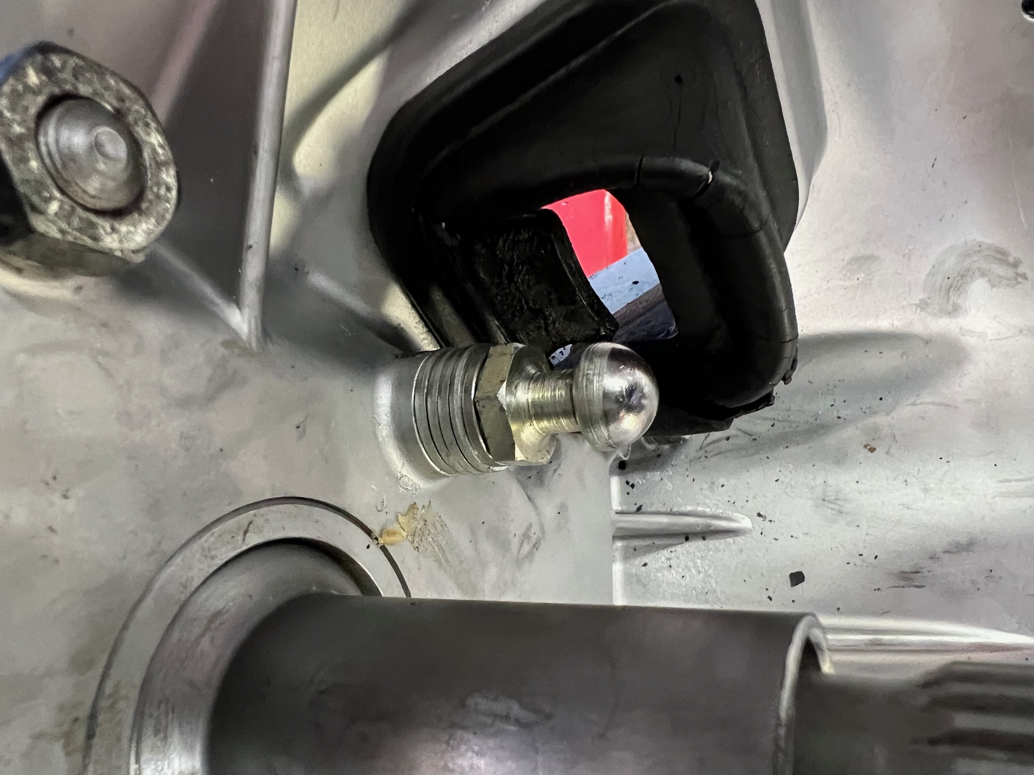

I have now completed the rebuild on my Fiat Dino 2400 Coupe - the engine and gearbox are back in the car and I've driven it a little.
So I thought I should explain what I did to make the Superformance (SF) clutch kit work in the car.
As a reminder from earlier in the thread:
1) the clutch pressure plate is about 10mm thinner than the original - i.e. the "fingers" where the throwout bearing engages are 10mm closer to the flywheel - this completely screws up the clutch-lever + mechanism engagement. You can't adjust out that much difference
2) The new pressure plate only has 3 holes for the 6 dowels used on the flywheel. And the 3 that correspond are the wrong size
1) I determined it wasn't going to work in the car - the clutch actuation lever would hit the gearbox casing before it disengaged the clutch. The best solution I could come up with was to re-position the ball inside the bell-housing on which the clutch lever pivots. See picture. This compensates for the thinner pressure plate. I did ultimately use a real spacer (not washers) and the thread is long enough.
2) I had to have the flywheel holes bored so that the bigger dowels could be re-positioned into the smaller dowel holes. But the holes in the pressure plate that corresponded were too small - so those holes also had to be opened up. I wish I had photographed all this better, sorry.
So, in short, if you buy a clutch kit from either Superformance or DinoParts or MrFiat, all of whom sell the same incompatible kits, you will have to modify the flywheel, the brand new pressure plate and the bellhousing.
Having done all that, it seems to work - but ask me again when I've done 2000 km.
Earlier in the thread, Georg suggests the best solution is to have the clutch plate rebuilt by ZF, I did make contact with Herr Lass at ZF and he offered to help, but because of severe wear on the fingers of my old plate, I opted to go the above route. Maybe next time I won't.
Thanks for all the help from everybody above and offline - and if i can answer any other questions then please ask.
