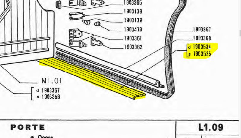

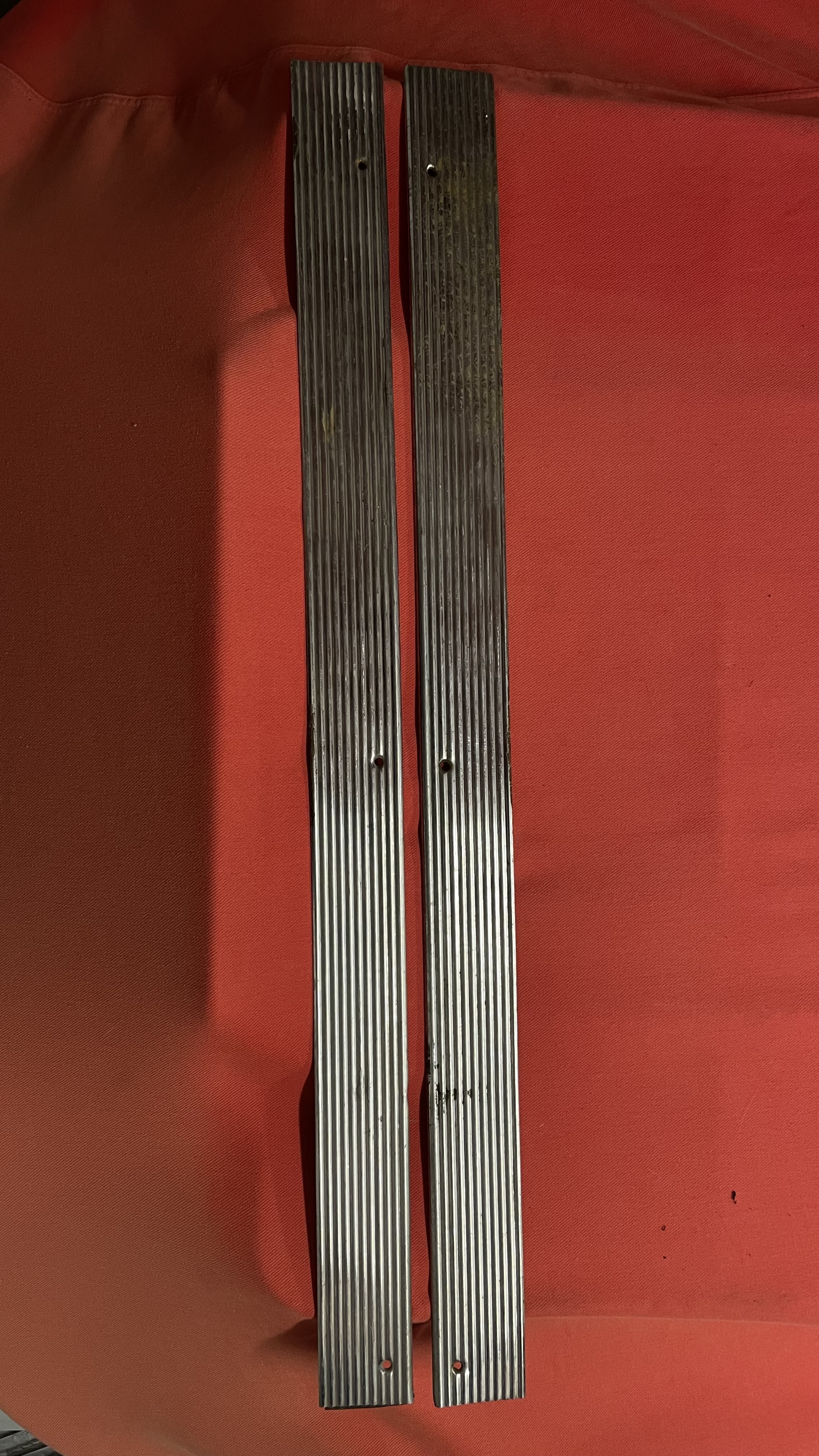

I'm looking for the two door sill plates for a Fiat Dino Spider..
Does anyone have any for sale or know where to get them?

Is there anything wrong with the two you have , besides appearance?
If it’s just appearance take them to a chrome plating shop and have them electropolished.
They will come back like new, I had the SS trim strips from the sills done. Not a single ripple left and gleaming.

there is nothing wrong with them..
but I have 2 Fiat Dino Spider 2000 and only one pair of sill plates..

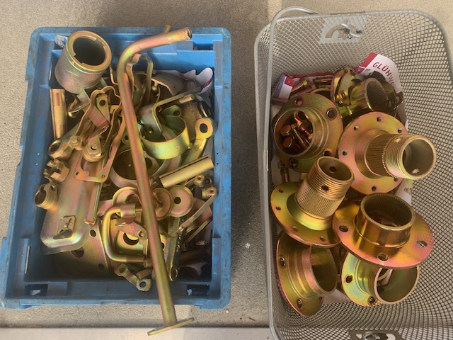

and I am a regular customer at a local electroplating company and have had most of the metal parts of my Dino either yellow galvanized or re-chromed

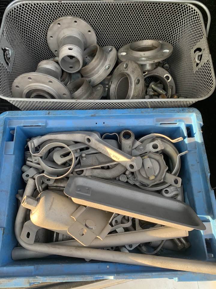

I believe all unpainted metal parts on the vehicle were delivered from the factory with a silver (light blue) galvanized coating...
However, it has become common practice for restorations to generally galvanize metal parts yellow... you probably mean gold CAD plating...
For example, I had my sandblasted metal parts yellow galvanized by a local company...
It looks a little more elegant...

Instead of cadmium plating, they'll likely use yellow galvanizing.
This is a two-stage zinc-based coating. First, a zinc coating is applied by electrogalvanizing, and then it is treated with a chemical passivation that gives it its yellow color.
I had most of my metal parts (brake calipers, bolts, nuts, wheel hubs, etc.) yellow galvanized. Many of my friends have also had this done on their classic cars, and some of the spare parts for the Dino Spider that I've bought from people were or are yellow galvanized.

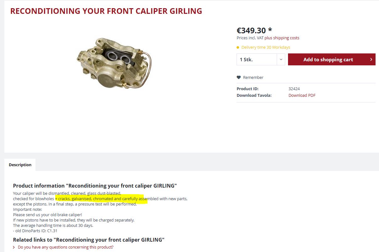

For example, at Dinoparts (the largest spare parts dealer for Fiat & Ferrari Dino in Germany) they will recondition your Girling brake calipers that will be galvanized and (yellow) chromated
https://www.dinoparts.com/en/parts-acce ... er-girling
nobody offers cad(mium) plating...

My coating guy is infact using Zinkagem ( Portuguese) It is the same electrolytic process as galvanizing, except the zinc base metal is more refined. He does 3 colours, silver, yellow and blue. Each glean like diamonds.
So I have decided to keep all the colours that the car came with. Everything in the engine, transmission and suspension is the silver cadmium colour. But I will do the brakes in the yellow. I’ll let you know the cost and quality when he has finished.
