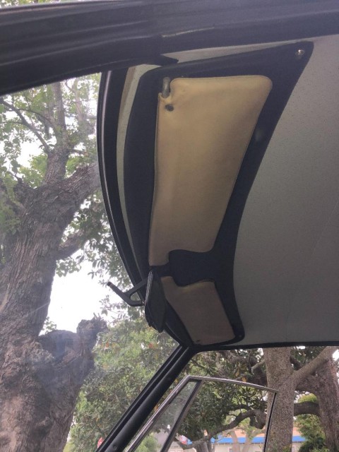

The original sun visor valence on my 2000 coupe was in sad shape. Cracked, discolored and even missing part of a corner. See photo.

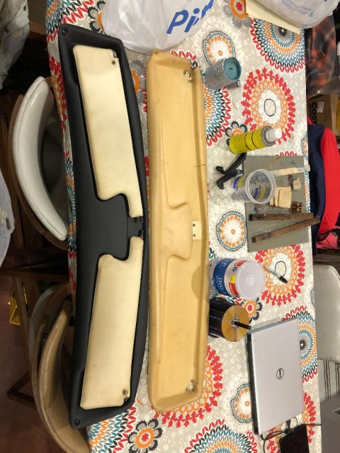

On eBay Italy, I found a vendor selling replacement valences. I bought one and installed it. The replacement is black, but my headliner is white.
I just repainted the tobacco stained headliner and it looks brand new.
The replacement sun visor valence looked identical sitting next to the old one on a table, but upon installation, it appears to be slightly narrower than the original as it took some minor modification of holes to make it fit.

Thanks, Ben.

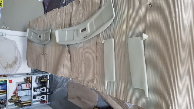

I made good experience with re-spraying them on my 2.4 but not white, I used a kind of beige. I first used primer for plastic and then the colour.

I resprayed the originals. Before I filled minor cracks with fine filler for leather and sanded again and again multiple times, spray fillered it, sanded and spray fillered again and then plastic primer and then colour. I don’t use bright white but a colour called in German „Kieselbeige“.
I personally prefer as original a light colour (white/beige) but I know some Dino owners have it all in black, incl. the rear vents, what also looks good.
Question of personal taste and how original it should be.
