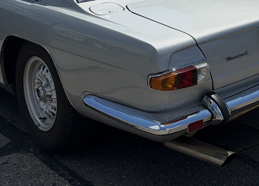

So to solve the problem I need to extend the exhaust pipes 1m off the rear of the car. :lol:

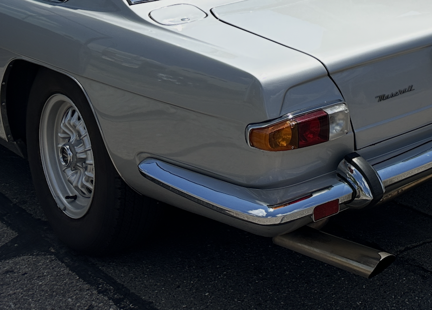

Posts: 571
Re: Overwhelming Petrol/Exhaust Fumes
This is really the reason why the pipes of a Mexico (and other cars) extend way beyond the bumper.
I'm always teasing a friend and ask him why he doesn't add a red flag to his pipes to comply with German laws :D

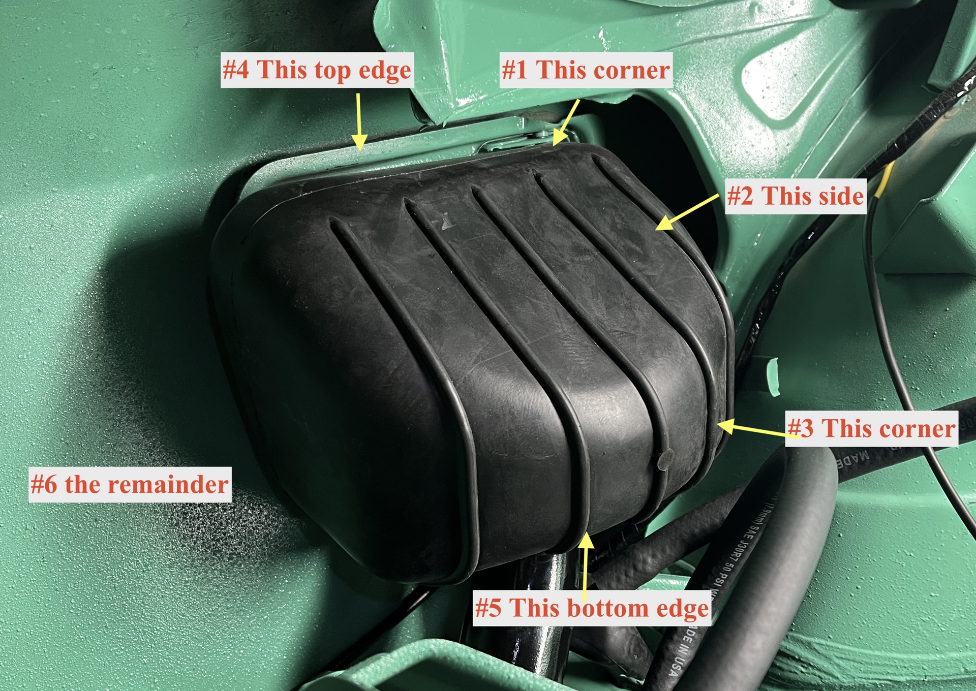

BTW: it is really a PITA to install the Bertone rubber boot. Works only when you heat it up in the sun or in hot water. On alfabb, I found an assembly procedure (thanks to Scott!)

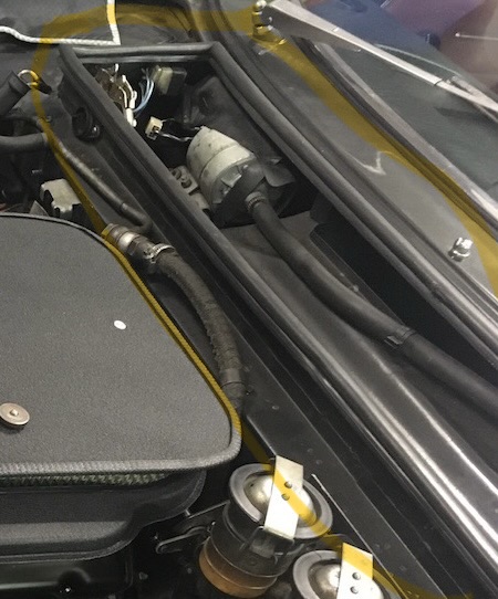

Posts: 138
Post by Ribolla_67 »
Next project is the replacement of the old air intake sealing:
