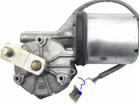

I think by a Spider it should be the same. Don‘t understand your problem. This are two plastic parts, one on each side from the cable connections......
vlad
Posts: 46
Re: wiper motor removal
Post by vlad »
should have a big white connector block ?

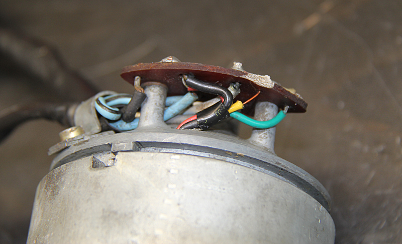

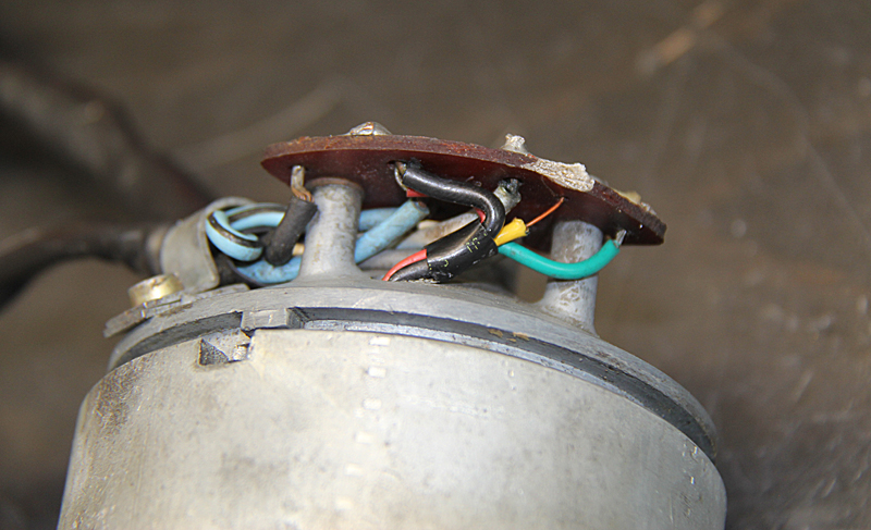

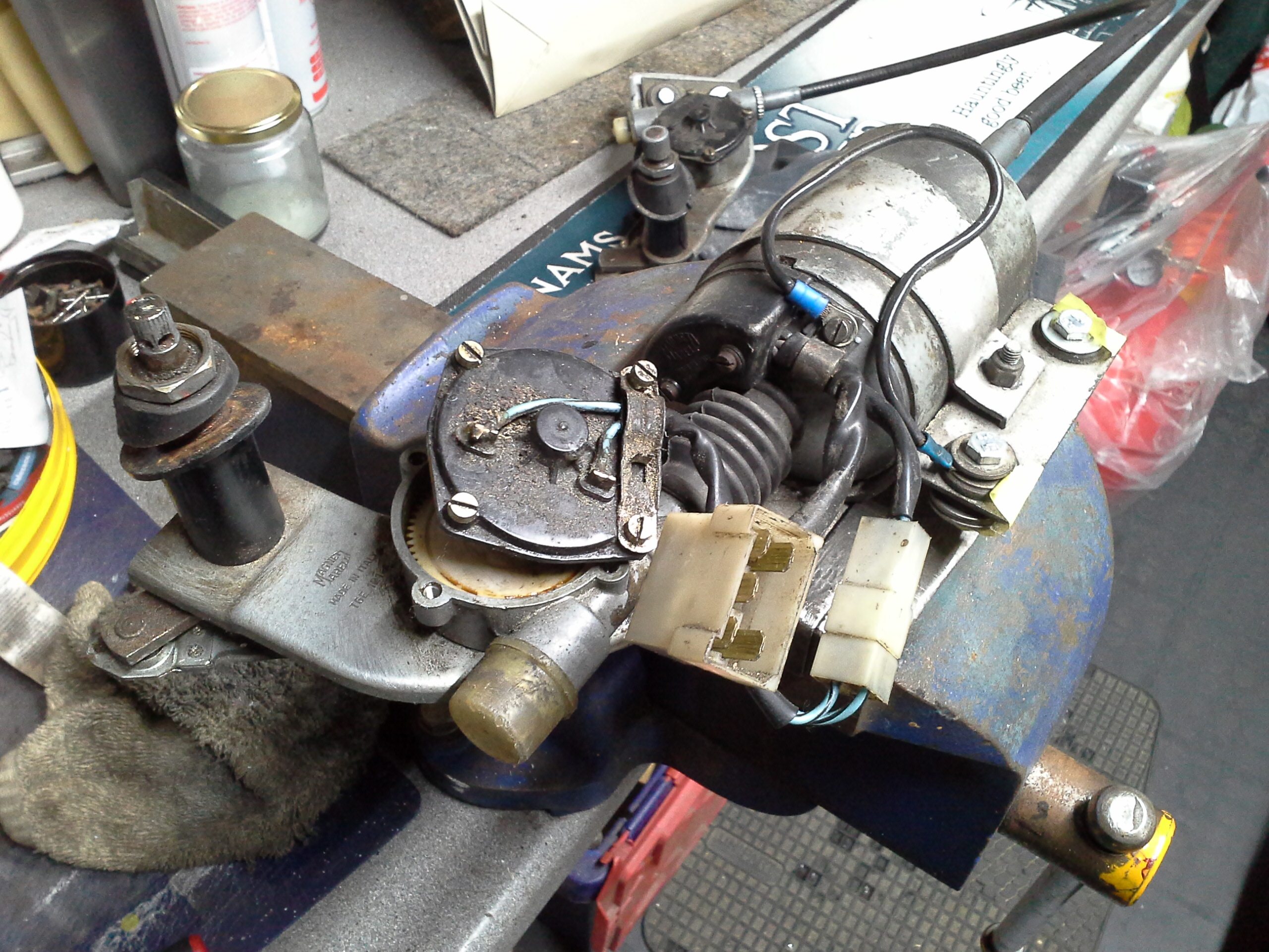

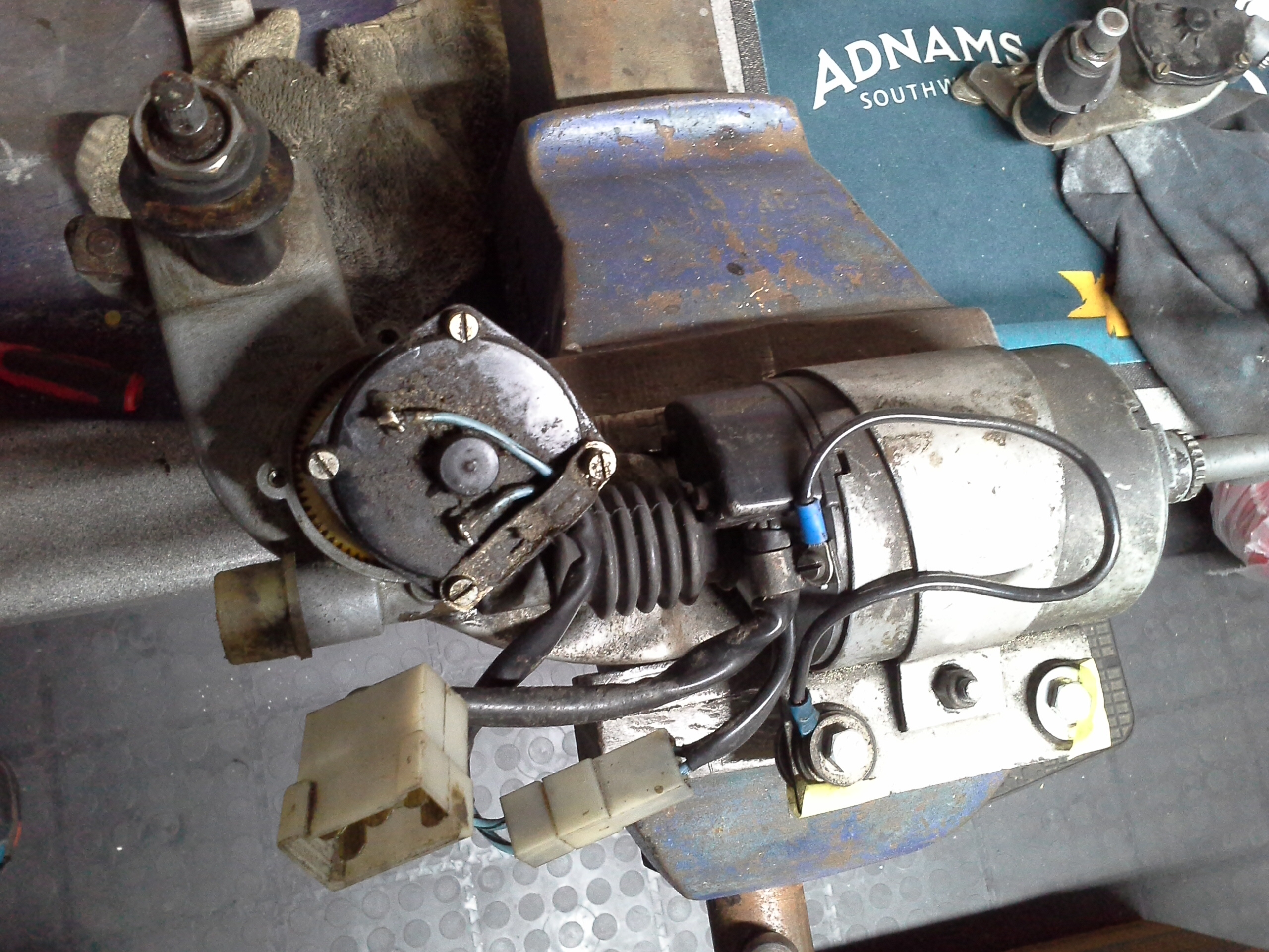

4cambob
Posts: 129
Post by 4cambob »
Like I said it does not have a white connection block,the wire come from the main loom and are soldered to the rear of the motor,similar to this photo.

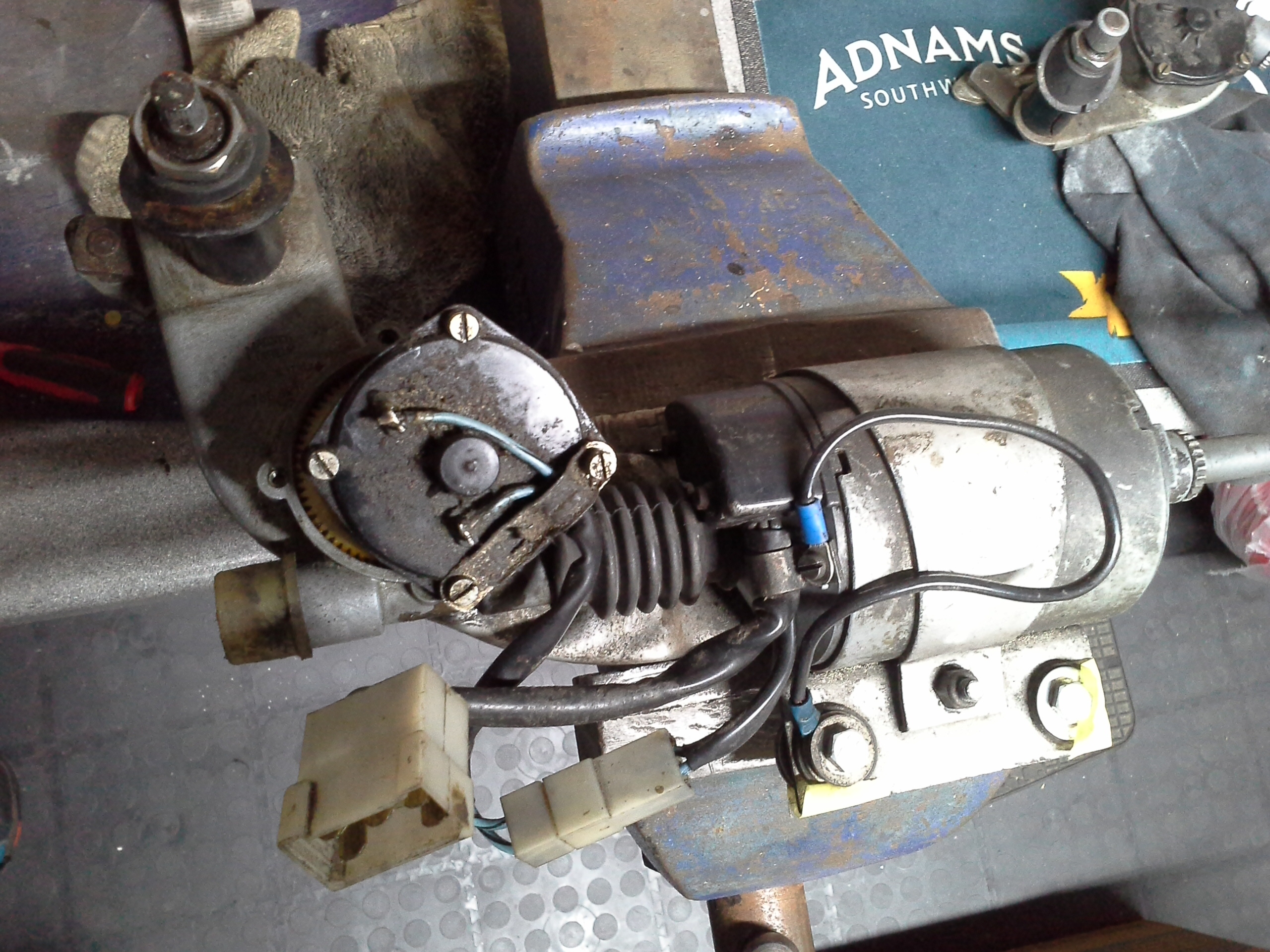

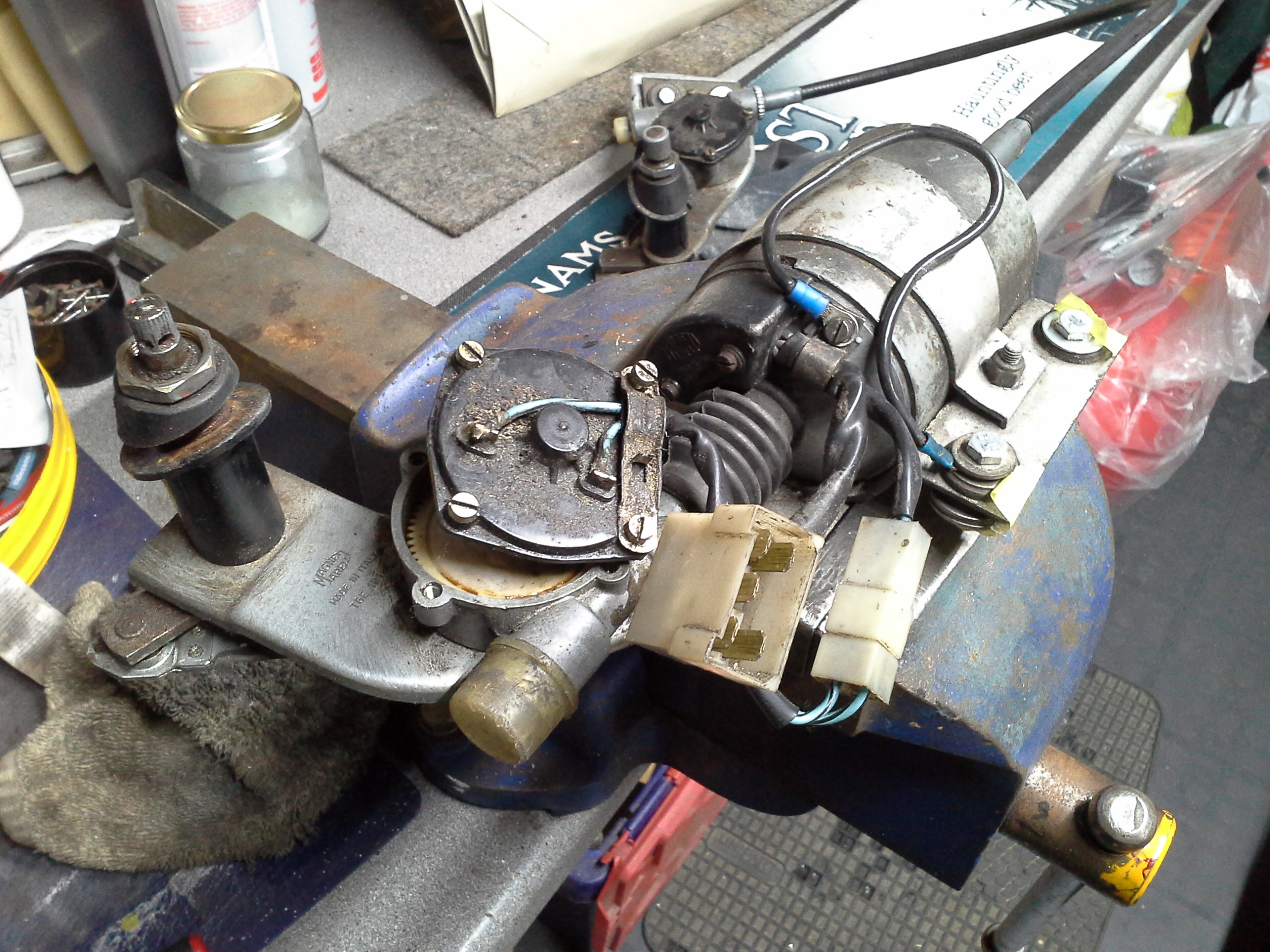

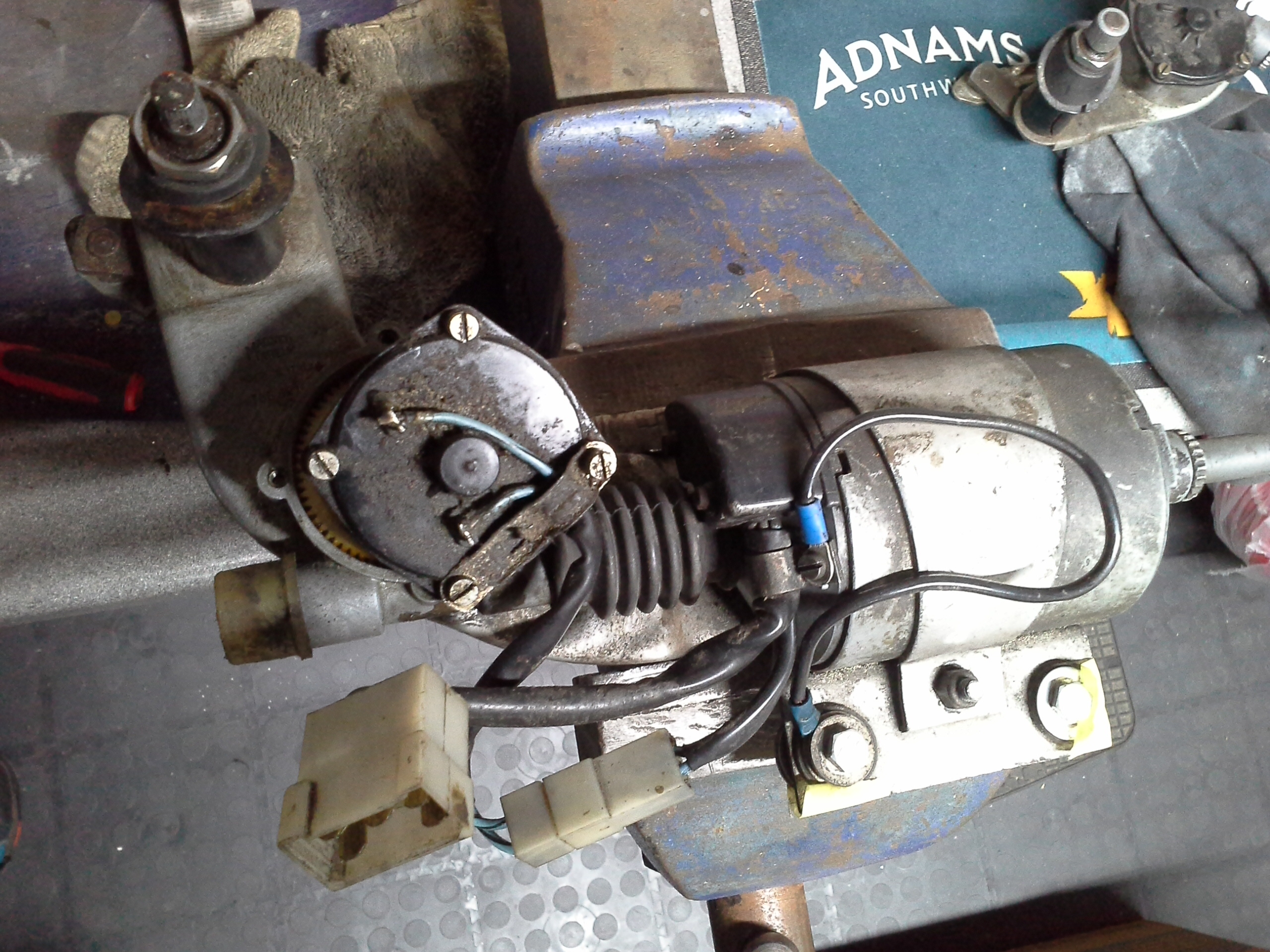

500 Dino
Posts: 19
Post by 500 Dino »
It looks as if you have a different wiper motor. Assuming mine is a standard Coupe fitting [I'm sure it is], I agree that it should just have the male/female white connector blocks.
regards
Graham
4cambob
Posts: 129
Post by 4cambob »
The photo I posted was similar, in fact mine one is exactly like in your photos and the only connection I have is like yours from the motor to the gearbox,but the one you have showing disconnected is simply not there. It maybe because my car is the 2.0 litre ?
Posts: 221
Spider and coupé have totally different wiper motors and mechanism.
Graham's wiper motor is a coupé version (2000 and 2400 are the same), whereas Vlad's wiper motor is the spider version (again 2000 and 2400 are the same).
Dario
Posts: 119
Post by Dario »
If it was me, I would cut the wires and instal the white connector plug as shown in Greg's picture. Will make life a lot easier.
