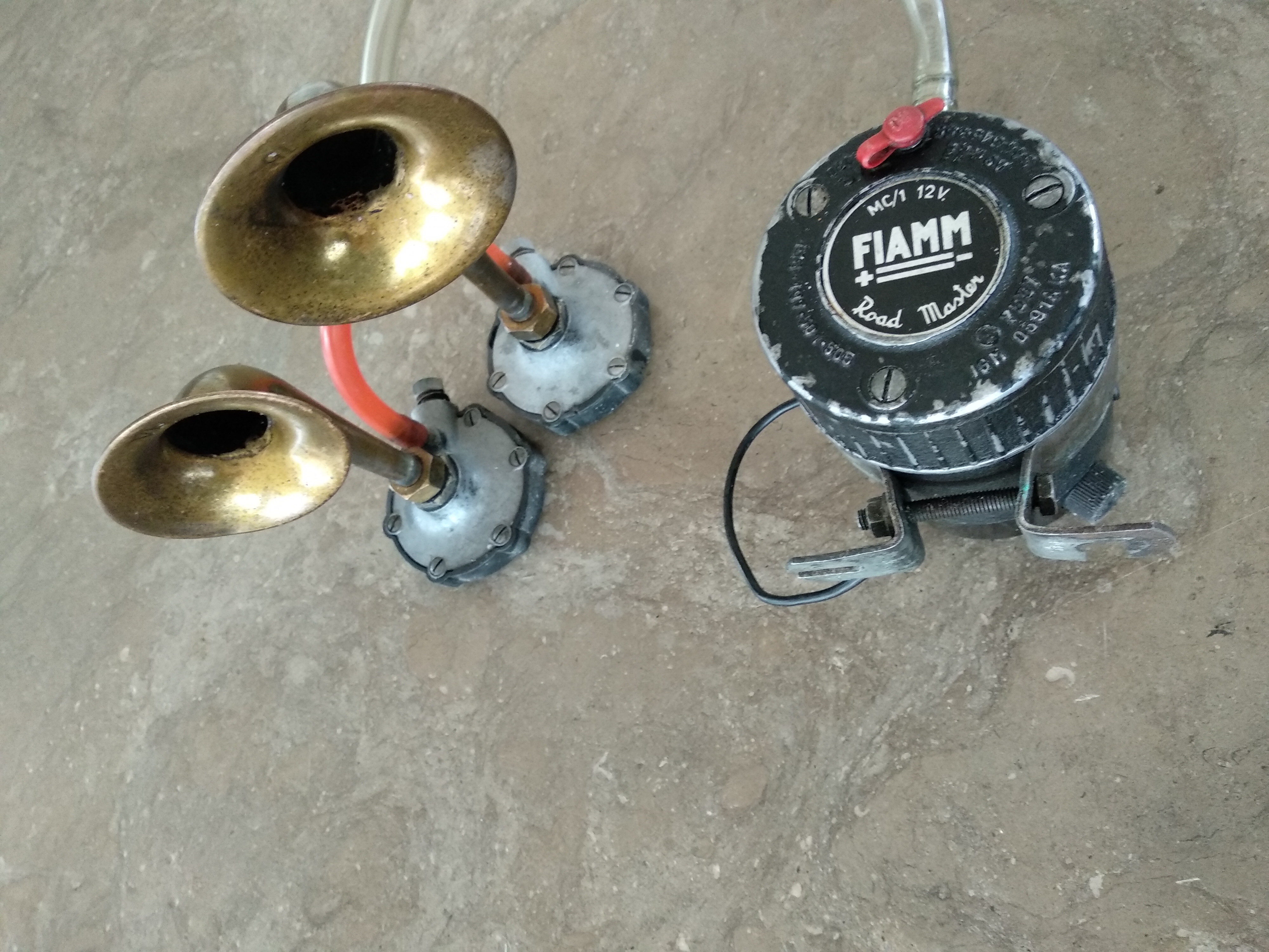

I have here an original set of Fiamm road master compressor and air horns. I attached to a battery, the compressor is working, but there came no sound...

@ThomasK, As a matter of fact the compressor is working, only it doesn't horn always, like it used to...

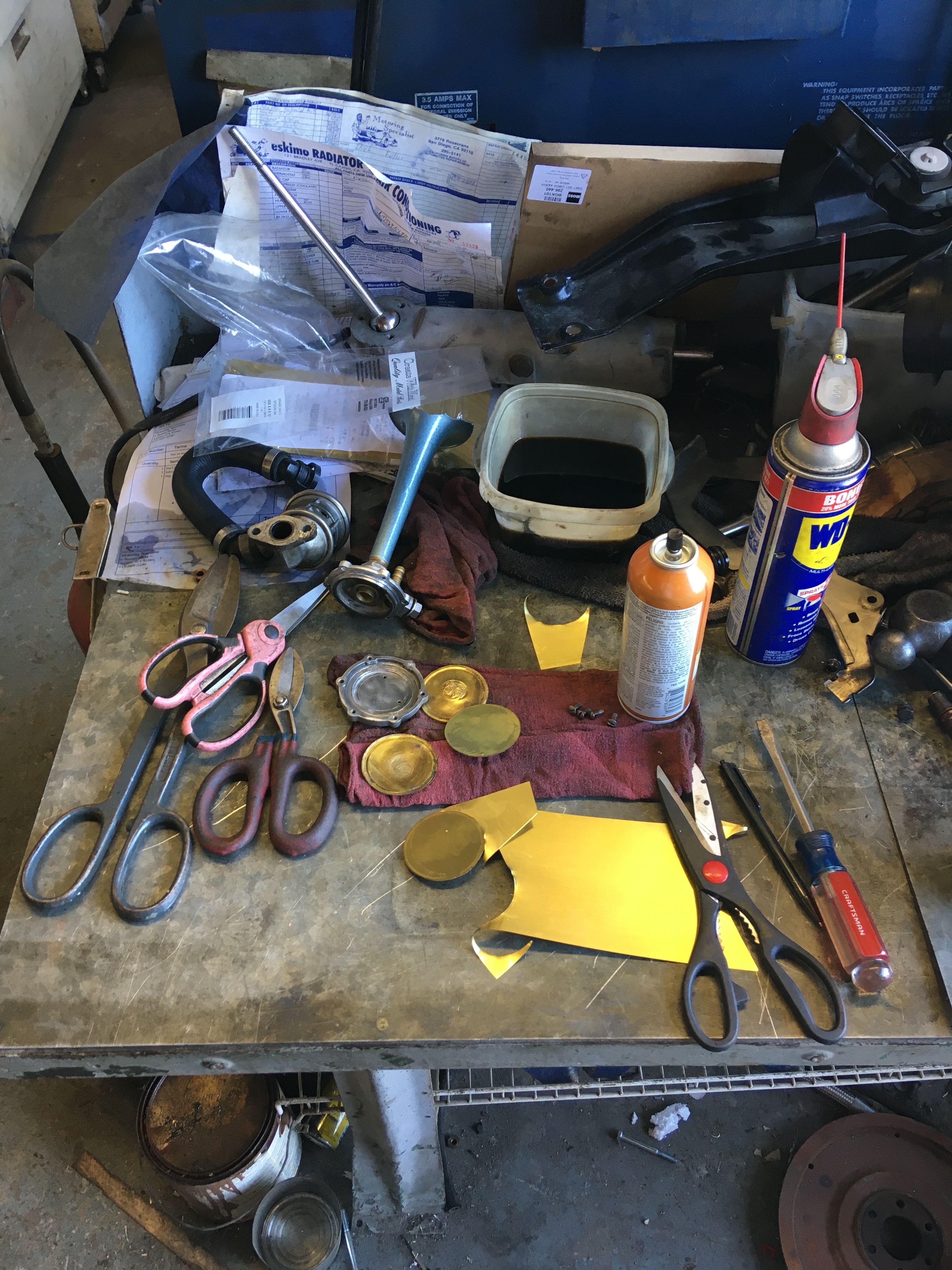

Ronen,
Be extremely careful to not over tighten the trumpets. You will damage the internal, very thin, brass shims which vibrate with the air pressure. Guess how I know! I managed to remake mine out of some very thin shim stock and they do work again.
Johnny Pergolizzi
