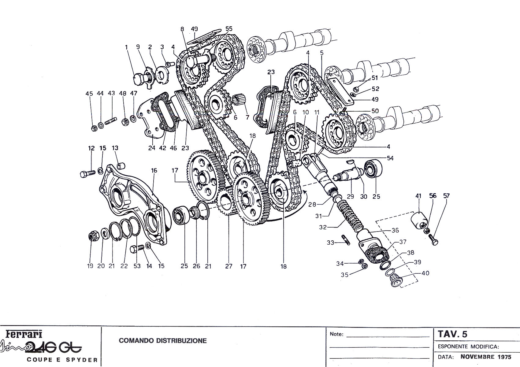

Can anyone tell me how to remove the cam sprocket pins? Part #3 on the attached photo. They have a 4 mm x 0.7 thread pitch, right hand threaded center. From photos and drawings, the exterior appears to be smooth. Are they just held in position by friction? If I pull them out with a slide hammer, are they meant to be re-used or discarded and replaced with new ones? Thanks, Ben.

Absolutely right!
The threaded center is there to remove and mount them. A long Screw or better a Slidehammer works, not very much force needed. Make sure nothing falls into the engine! Tighten chain tensioner before to avoid it falls into the engine. I always put pressure on the chain, then tighten the tensioner so the chain is „loose“ then remove pins and chain gears.
You can reuse the Pins.
