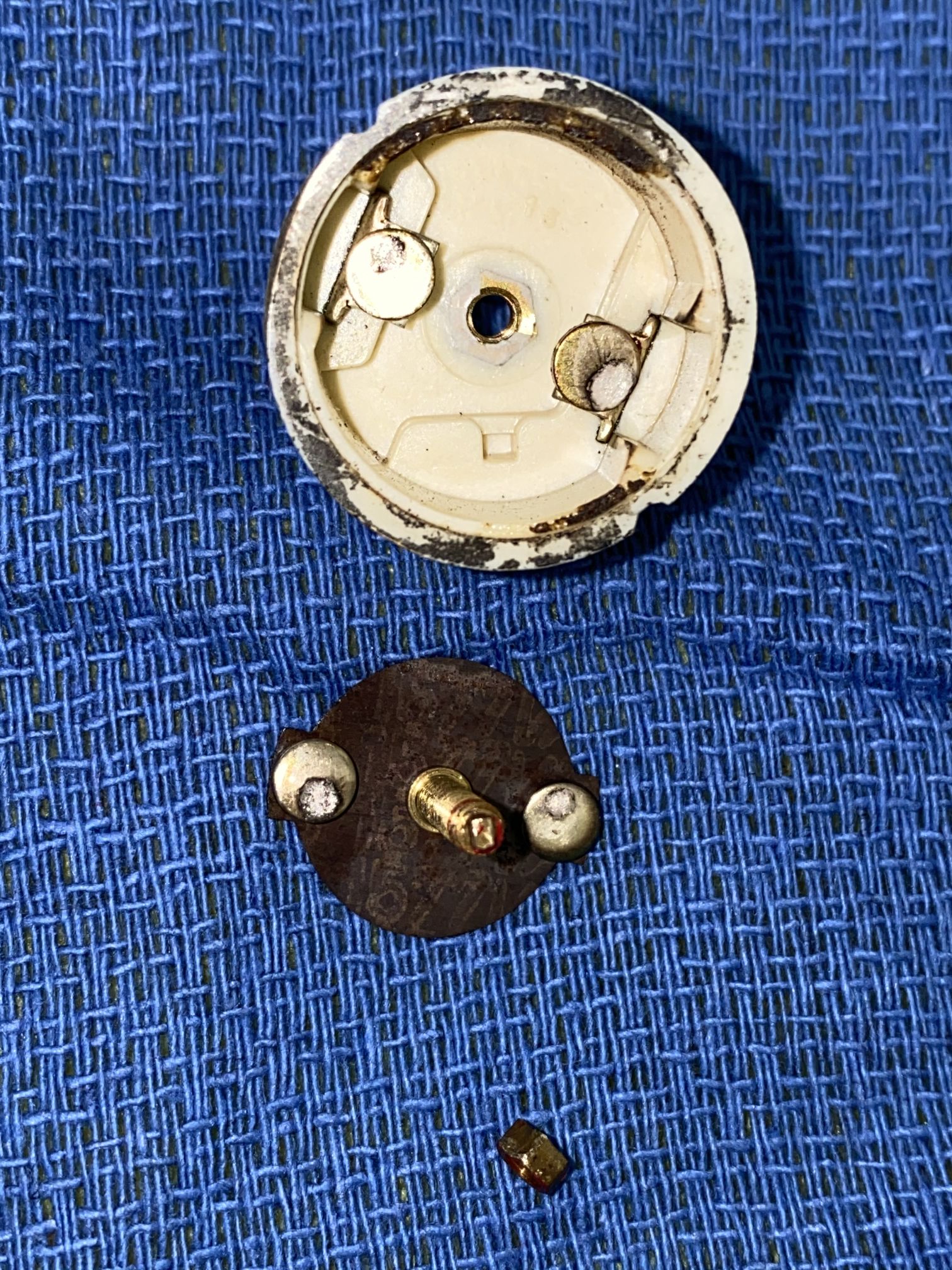

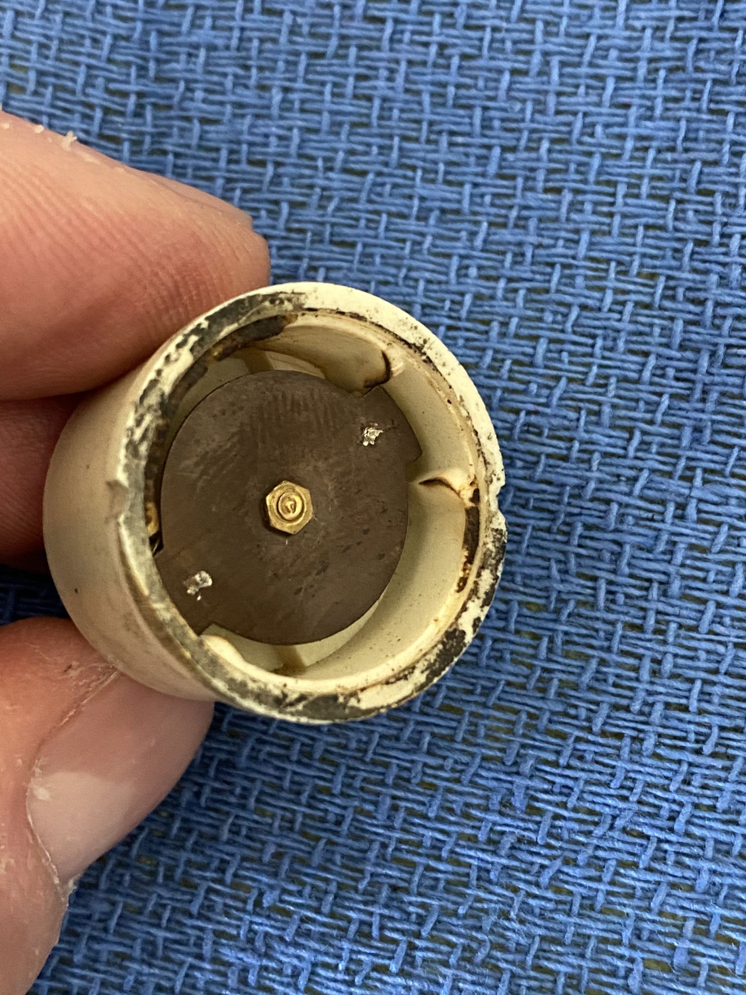

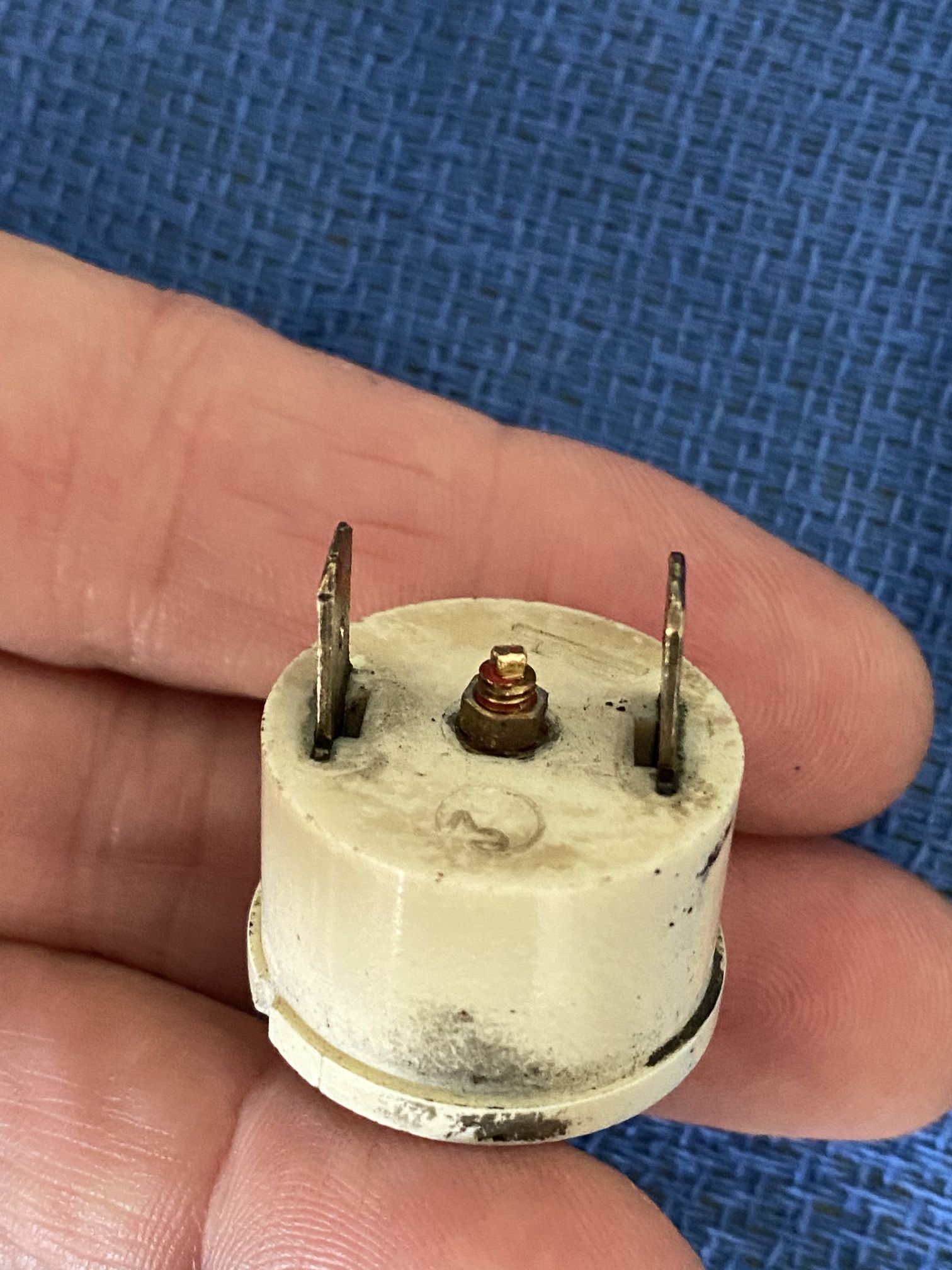

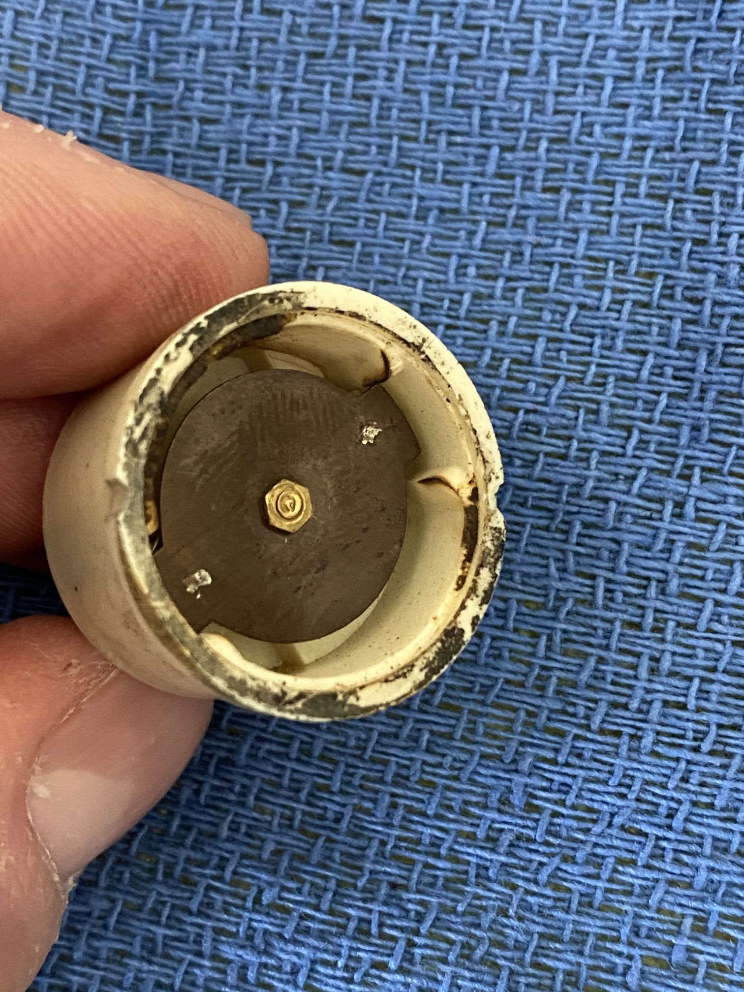

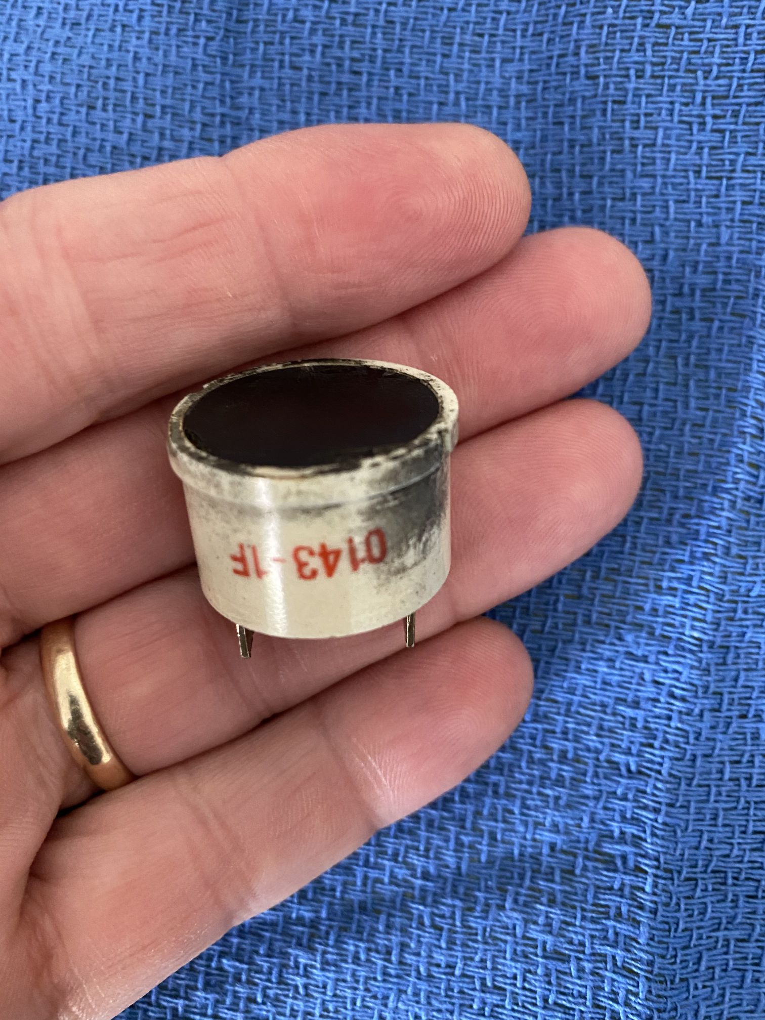

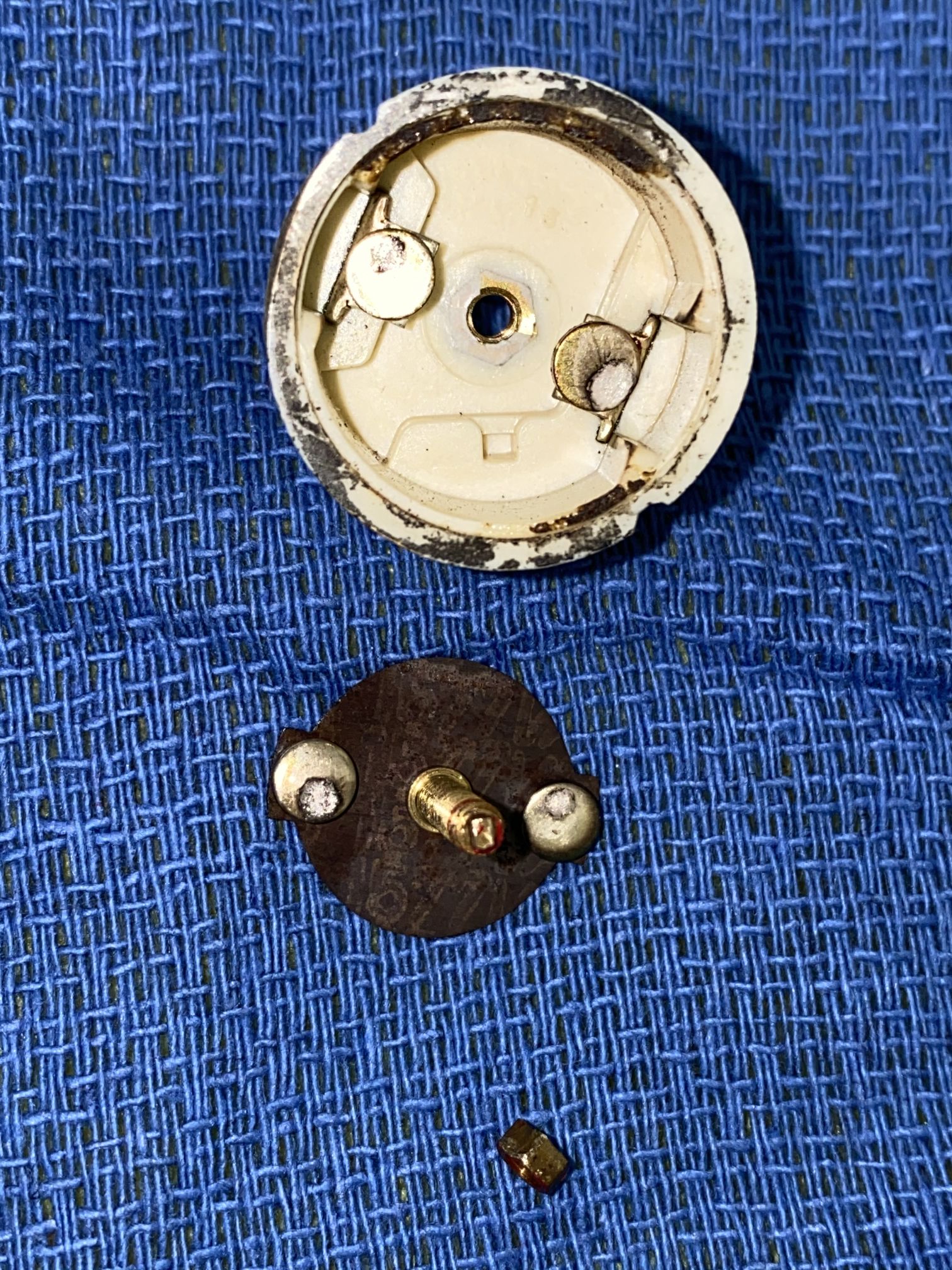

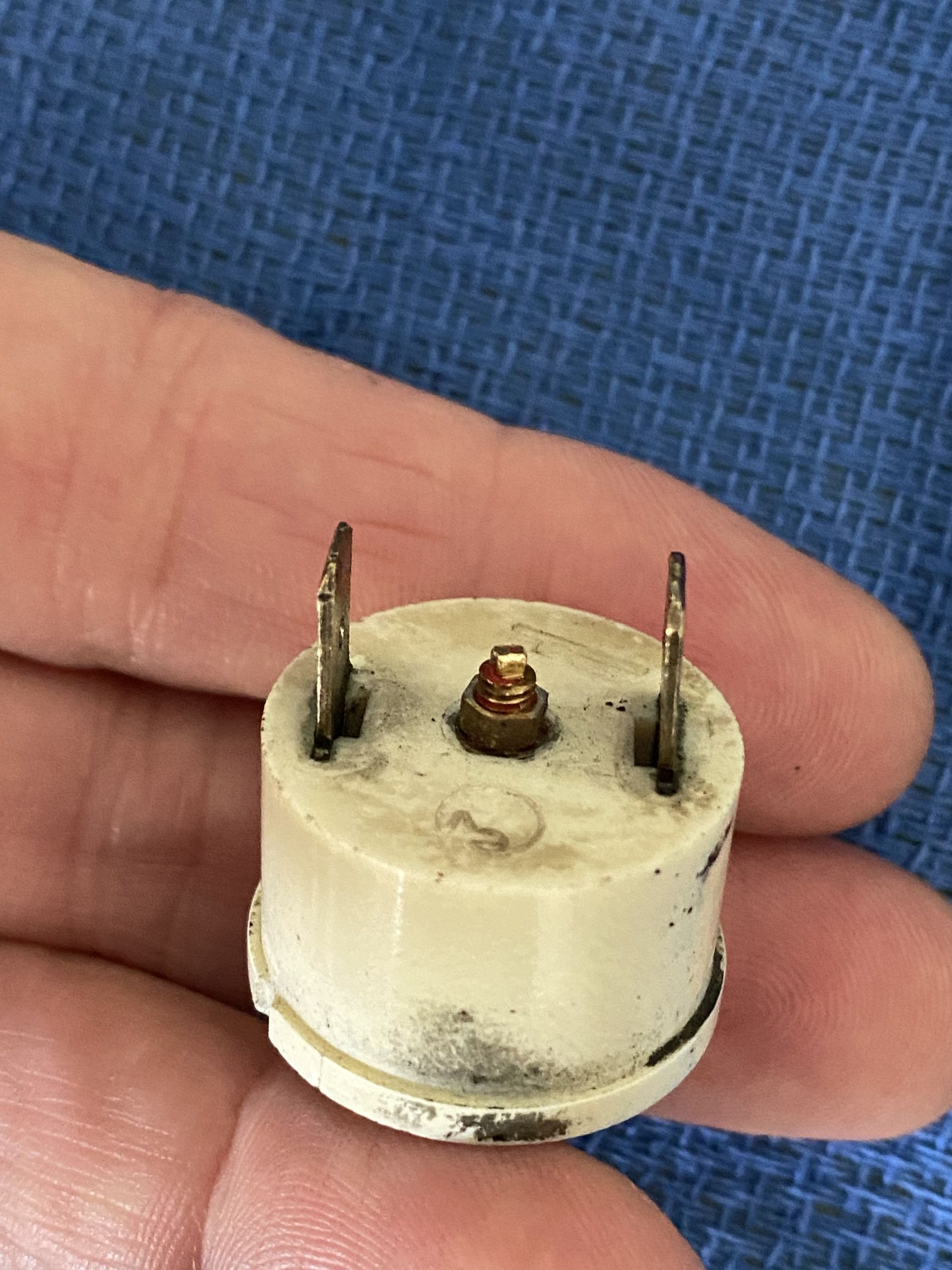

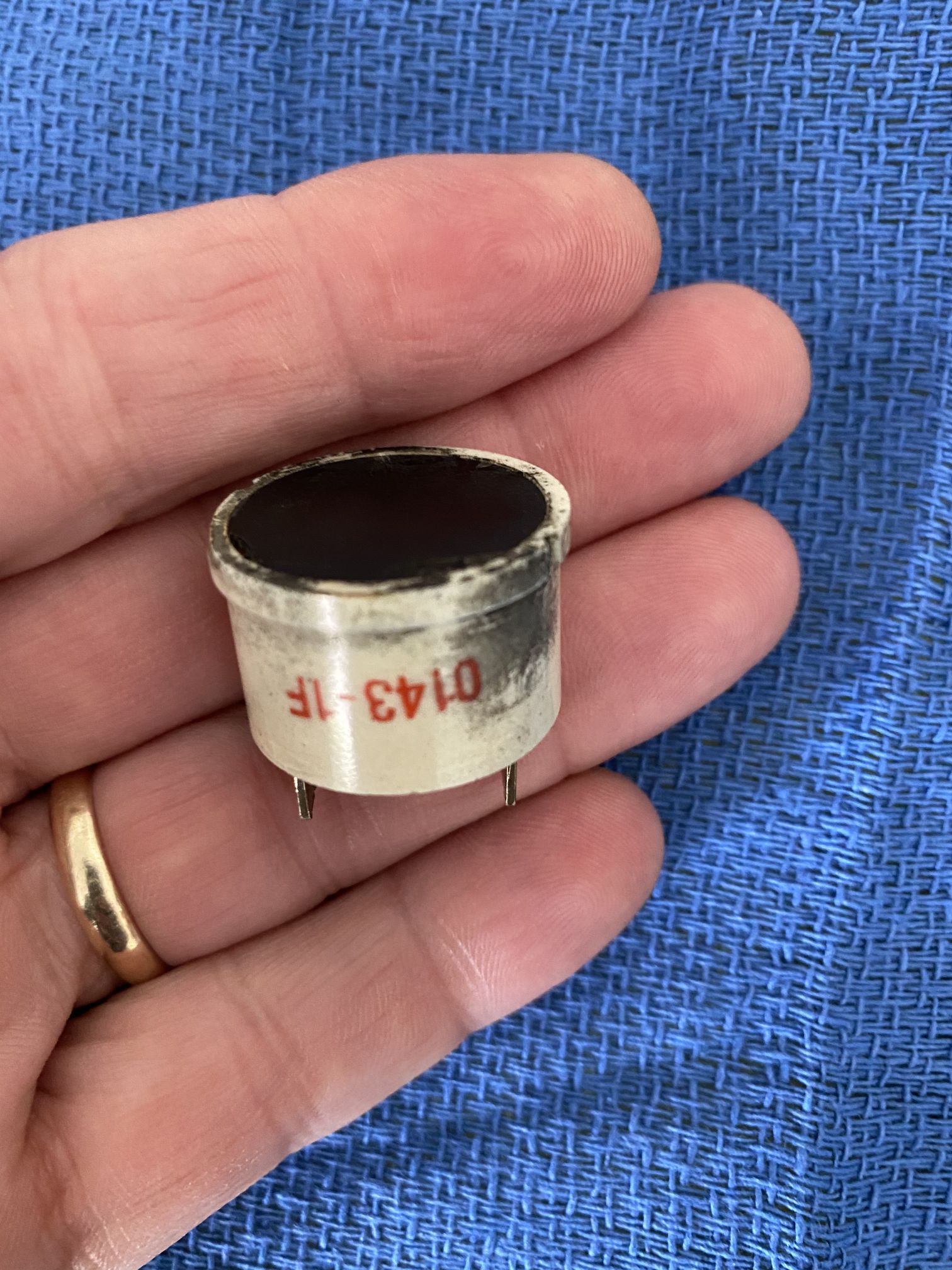

This is what the original circuit breaker looks like. It sits on the top of the firewall with two thick white wires going to it. The back has a small nut that in principle allows the bimetallic disk to be adjusted to set the trigger point (time). I was unable to adjust mine (it never triggered) so I decided to look for an alternative.
Inside, there is a bimetallic element through which the current travels, it then heats up and eventually it "clicks"; it goes from concave to convex and the contacts separate thus interrupting the power to the motor.

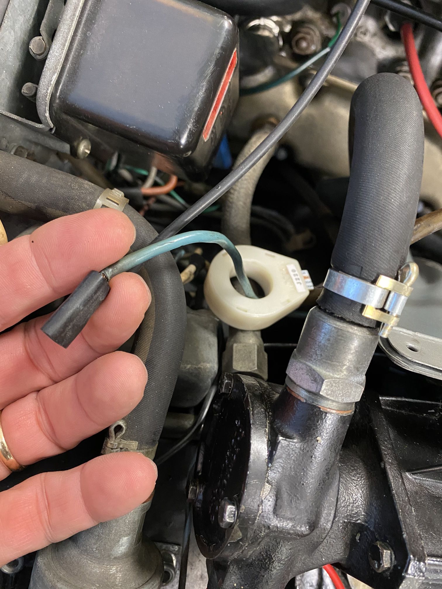

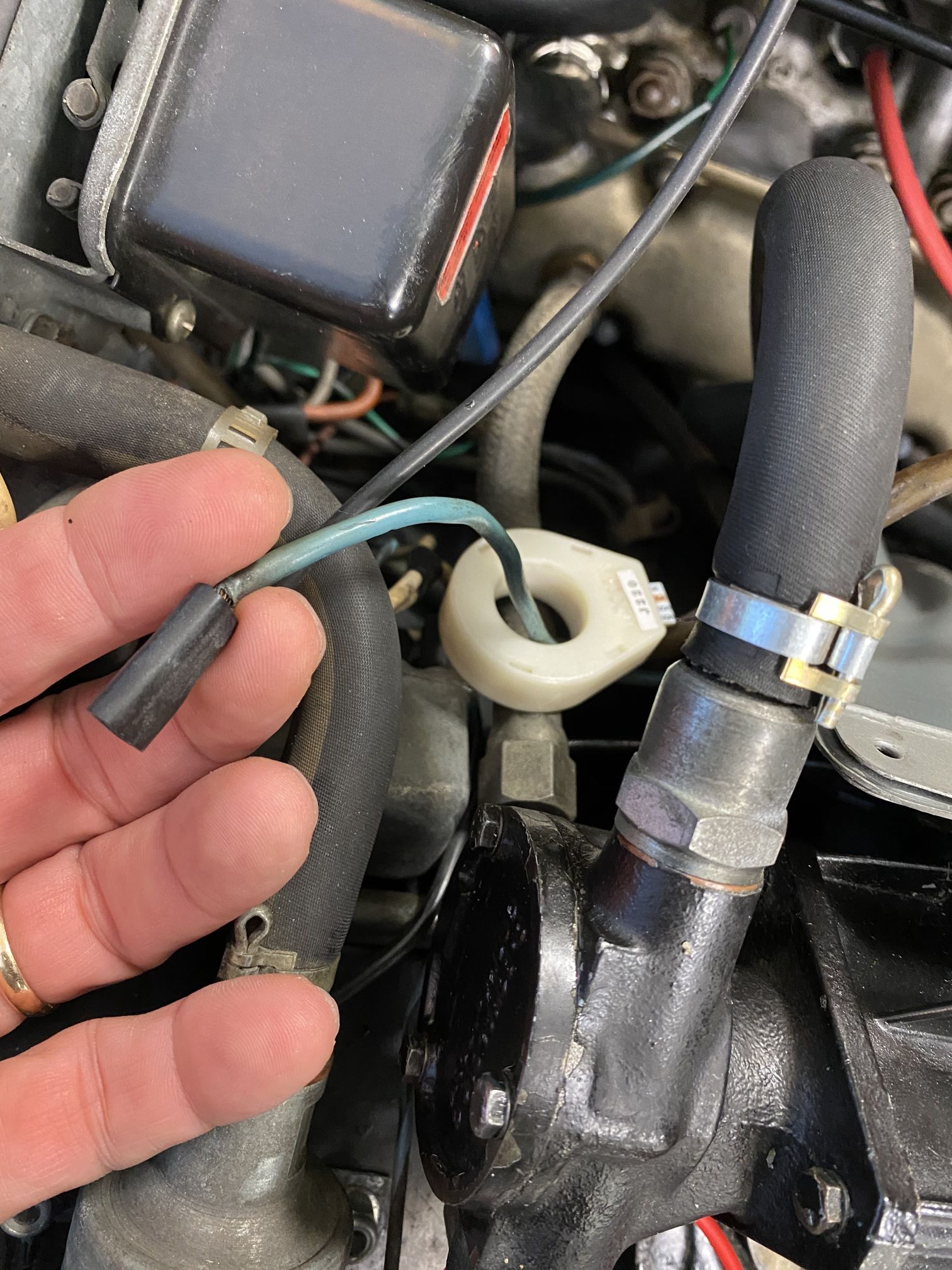

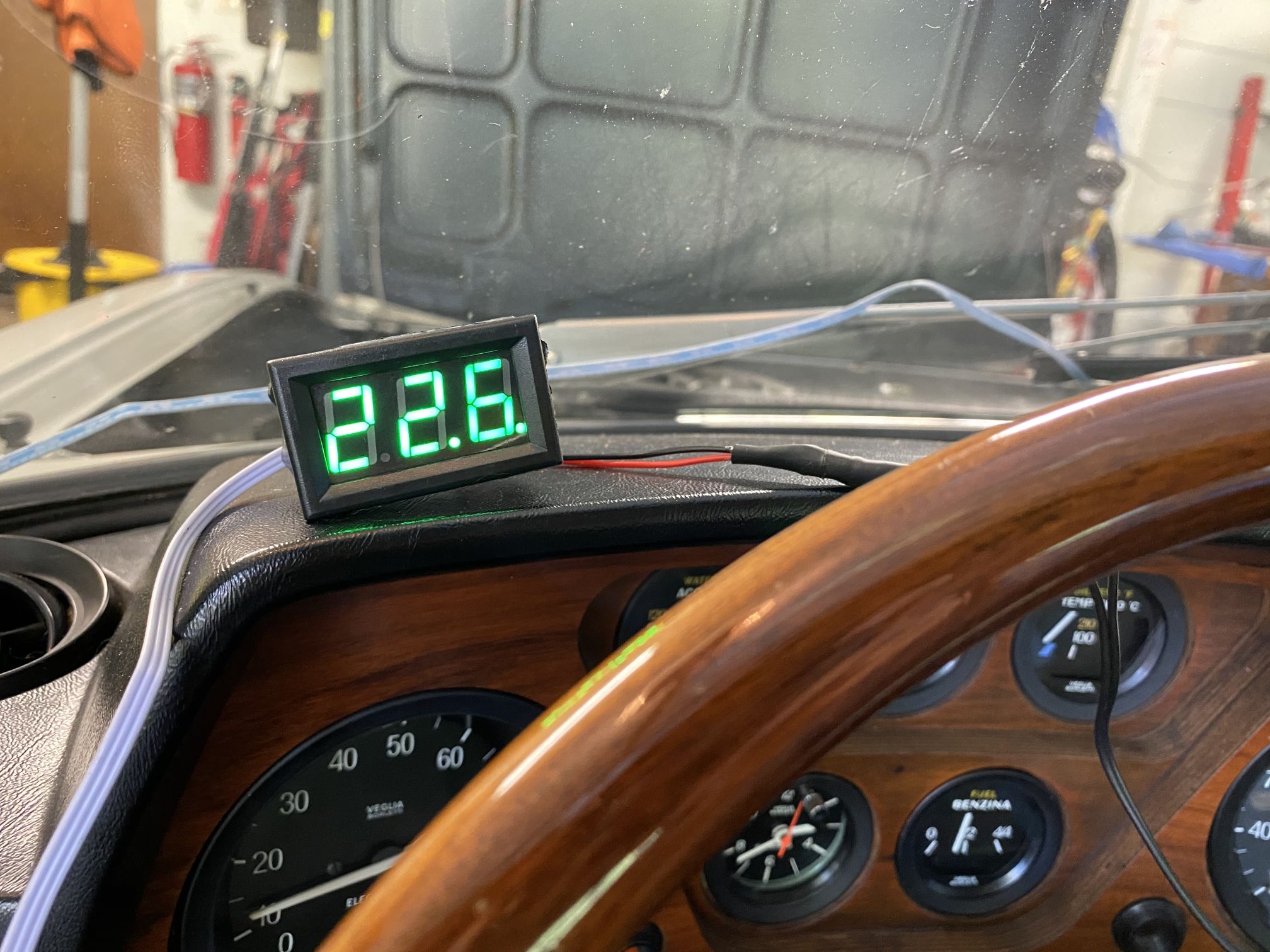

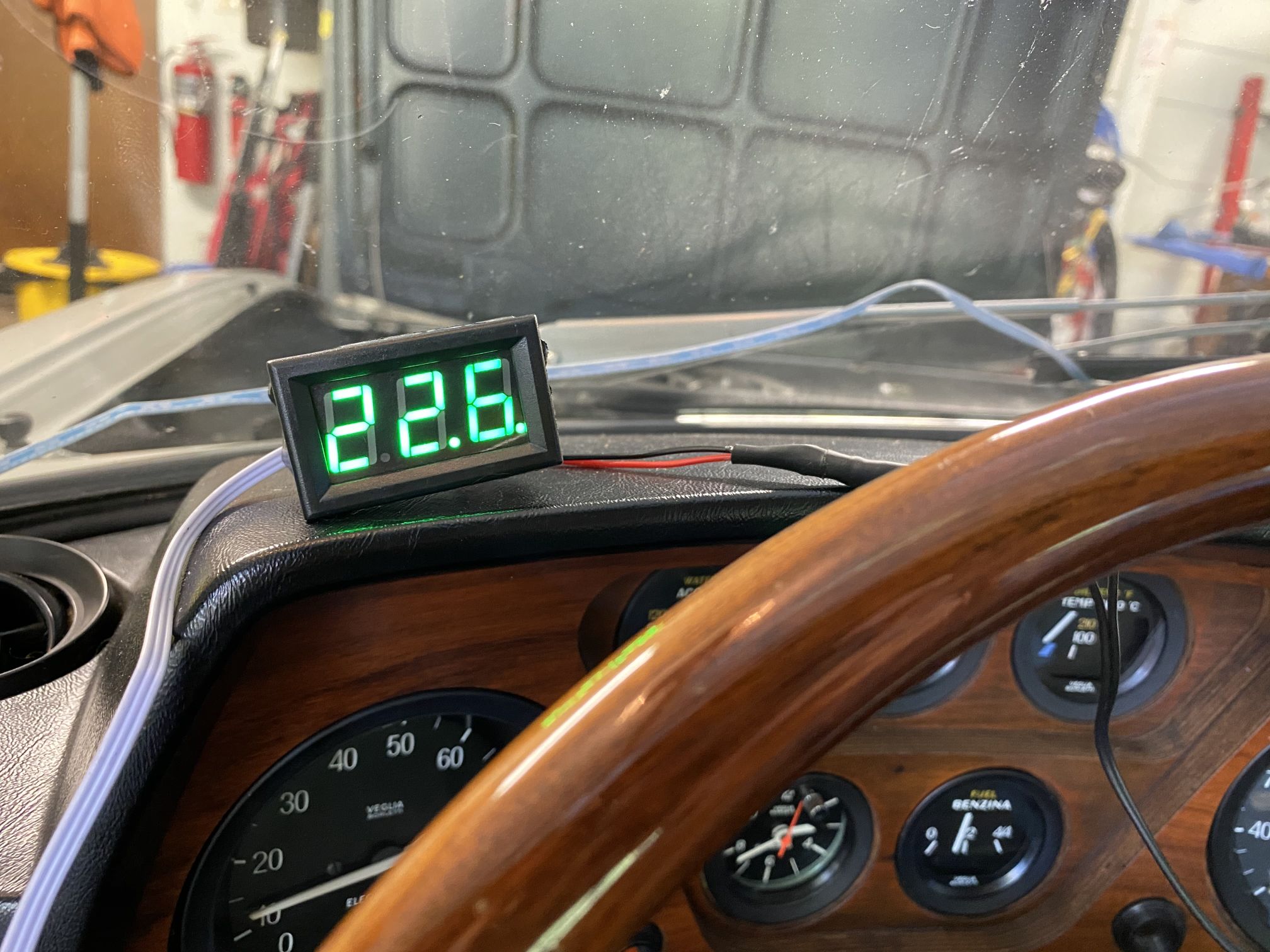

While the pump is specified to consume 10 Amps, when I put a hall effect DC current sensor on it, It showed around 21-23 Amps while running with a surge of around 28 very briefly when it started up. This is with the car running and the alternator producing 14.2 Volts.

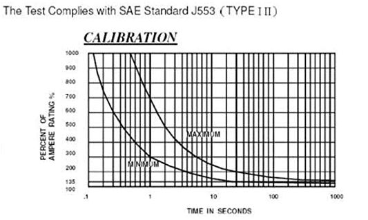

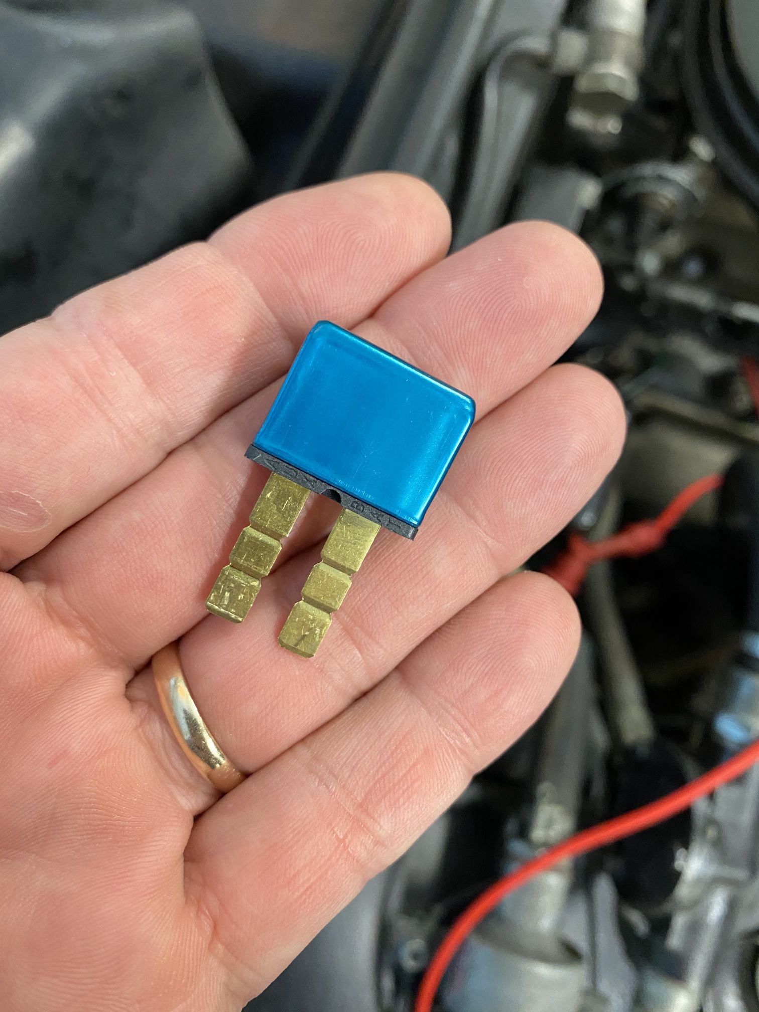

There are commercially available (Amazon) 12 V, self-resetting circuit breakers. They do not trigger instantly when reaching the rated current but rather it varies as a function of the amount of current. As seen on the graph, the 10 second point would be around a 200% load. This also varies with temperature so if it is hot, it would be shorter, colder it would be longer.
breaker curve.JPG (40.76 KiB) Viewed 5670 times

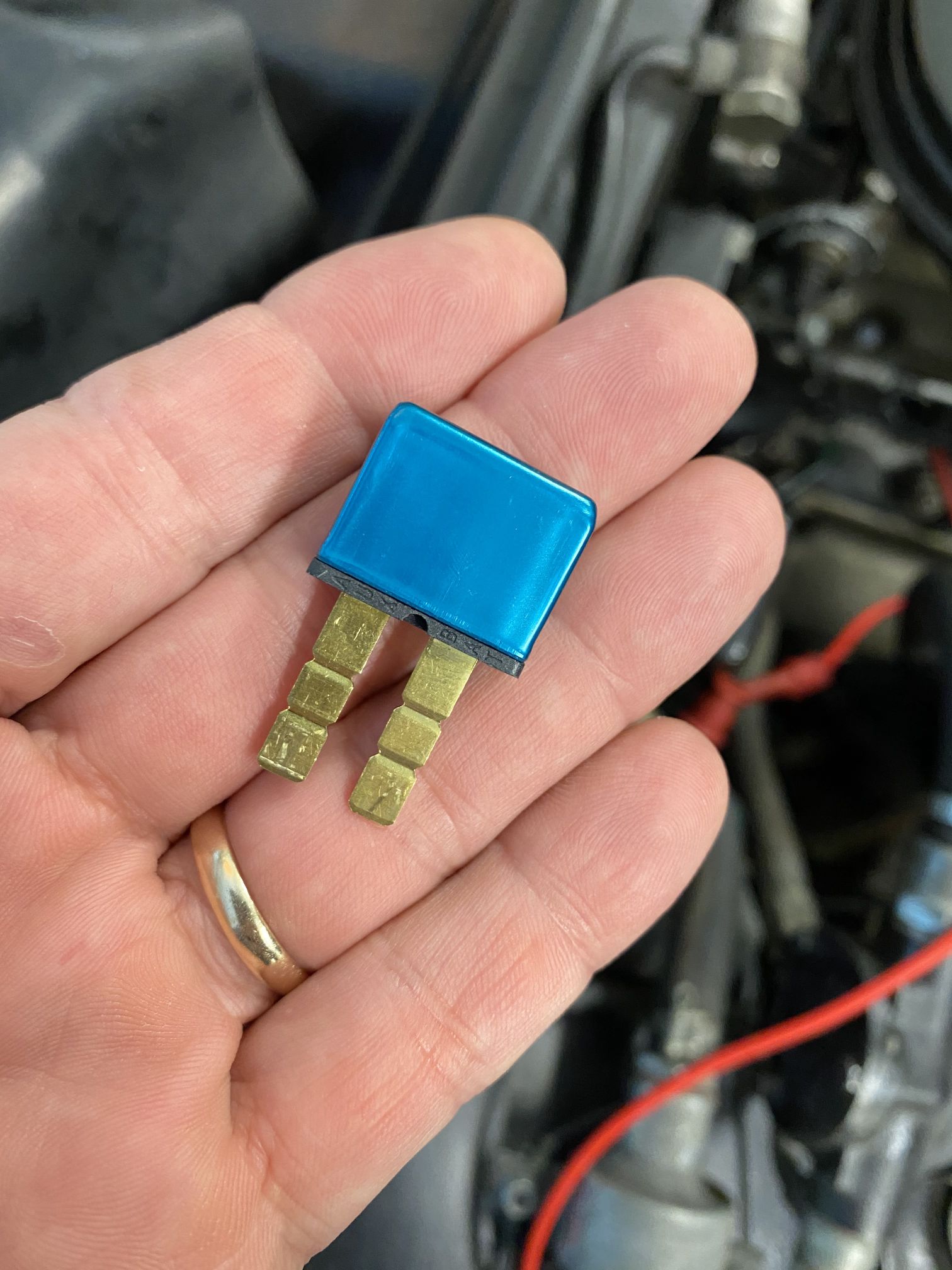

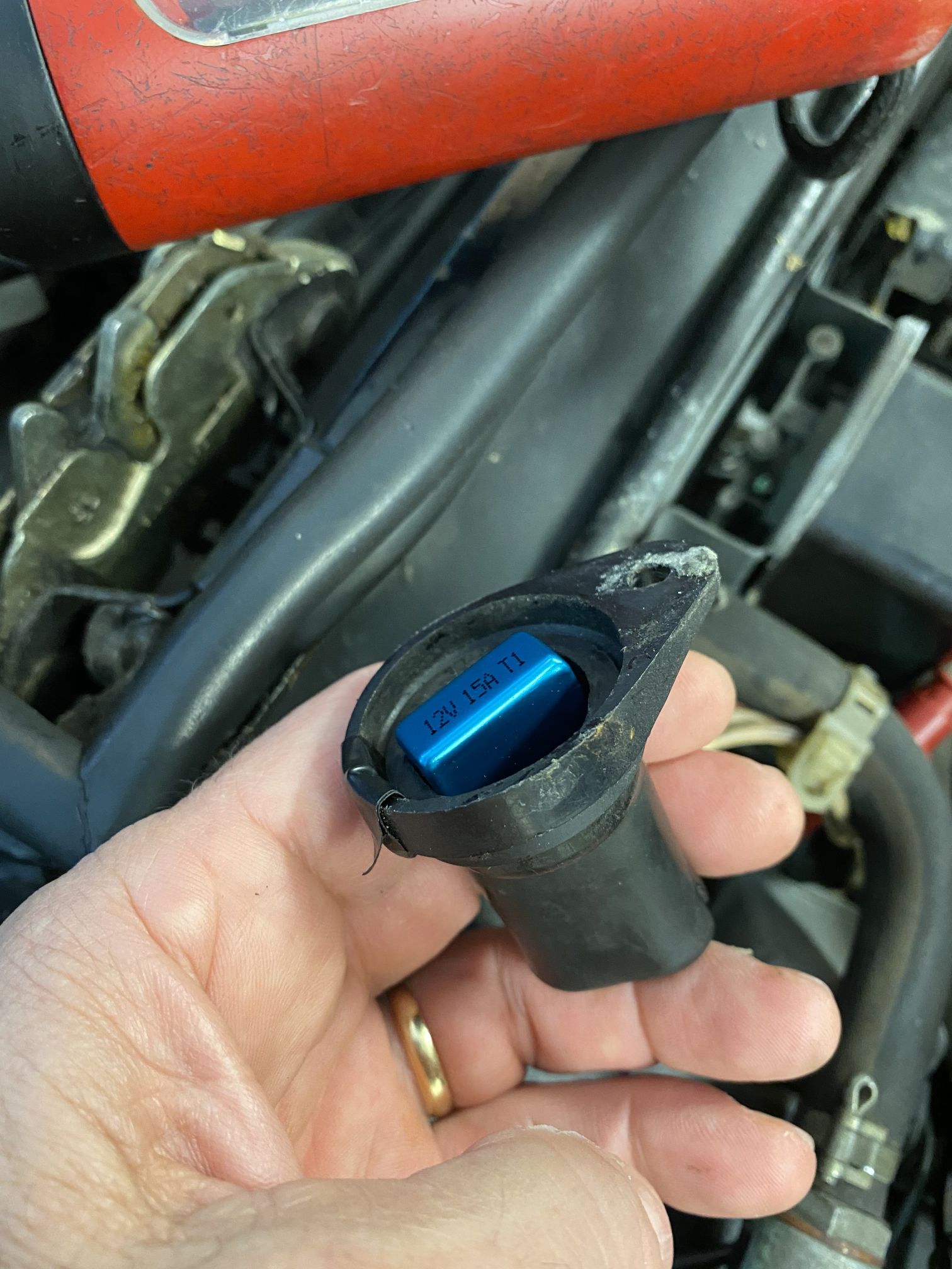

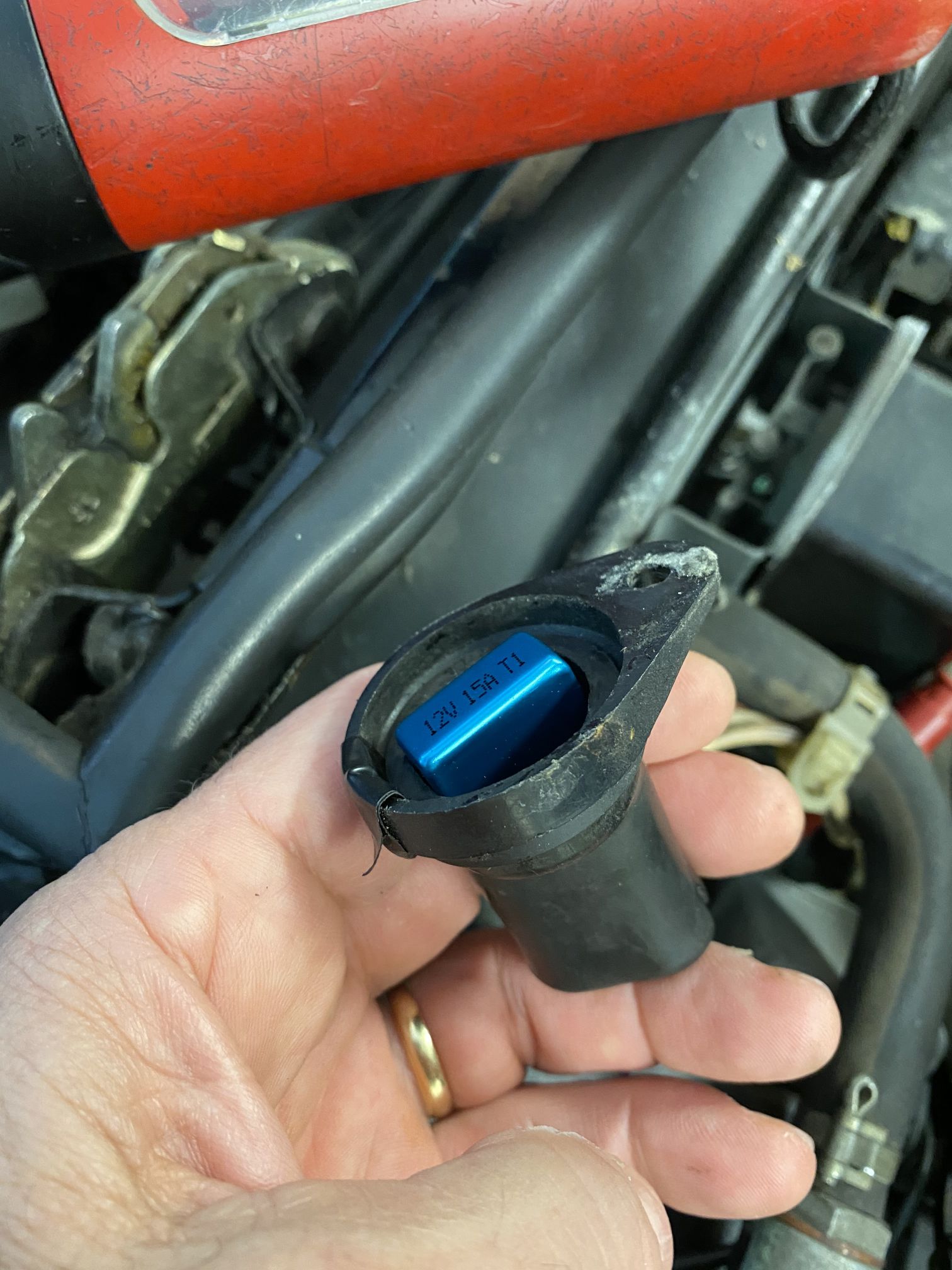

Since my vacuum sensor works, all I want is to prevent the pump from running "forever" and potentially damaging itself if I have a leak. So I selected a 15 Amp breaker and that has given me about a 10-12 second run time with the same time off, so a 50% duty cycle. The firs time it runs, when the breaker is cold, it runs longer, around 30 seconds but if it keeps running it settles into the 10 on 10 off mode.
Here is the breaker showing that it fits perfectly in the same location as the original one and is invisible thus maintaining an original look.
