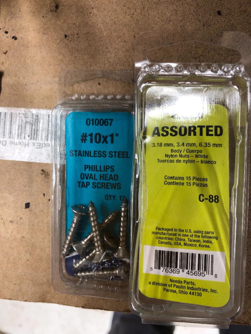

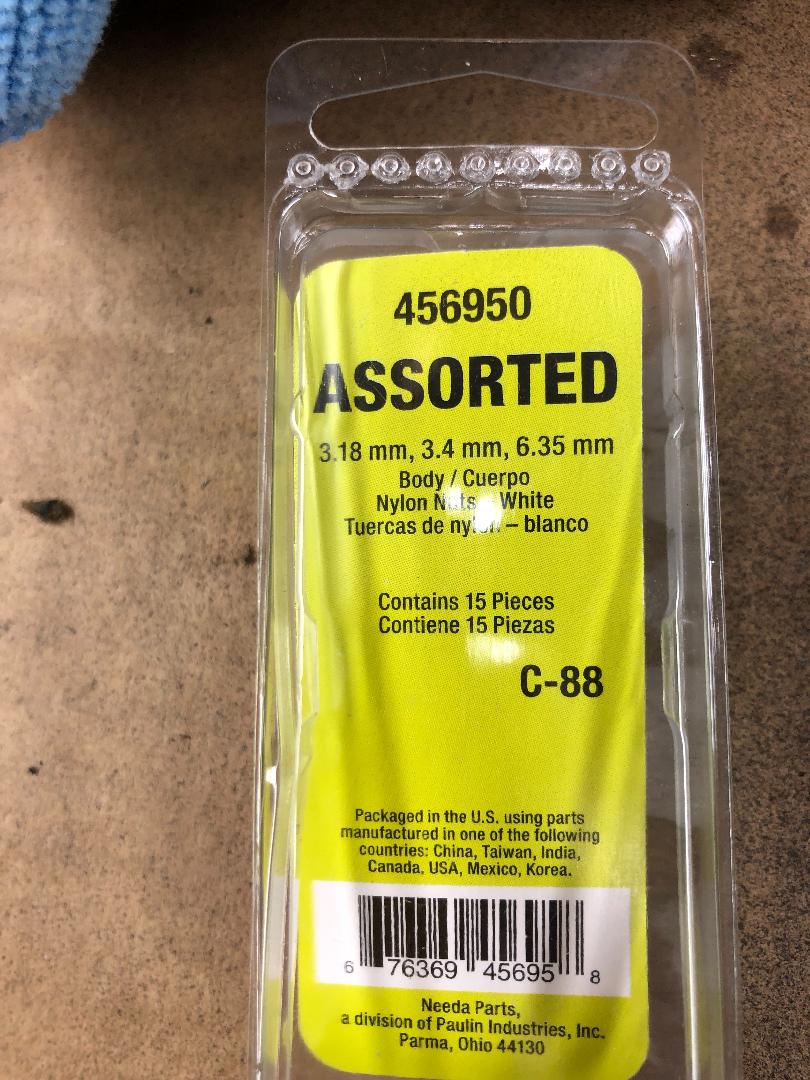

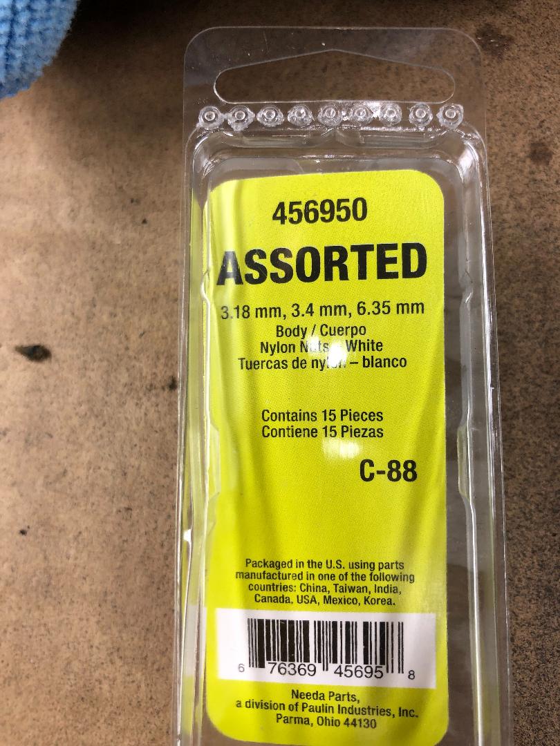

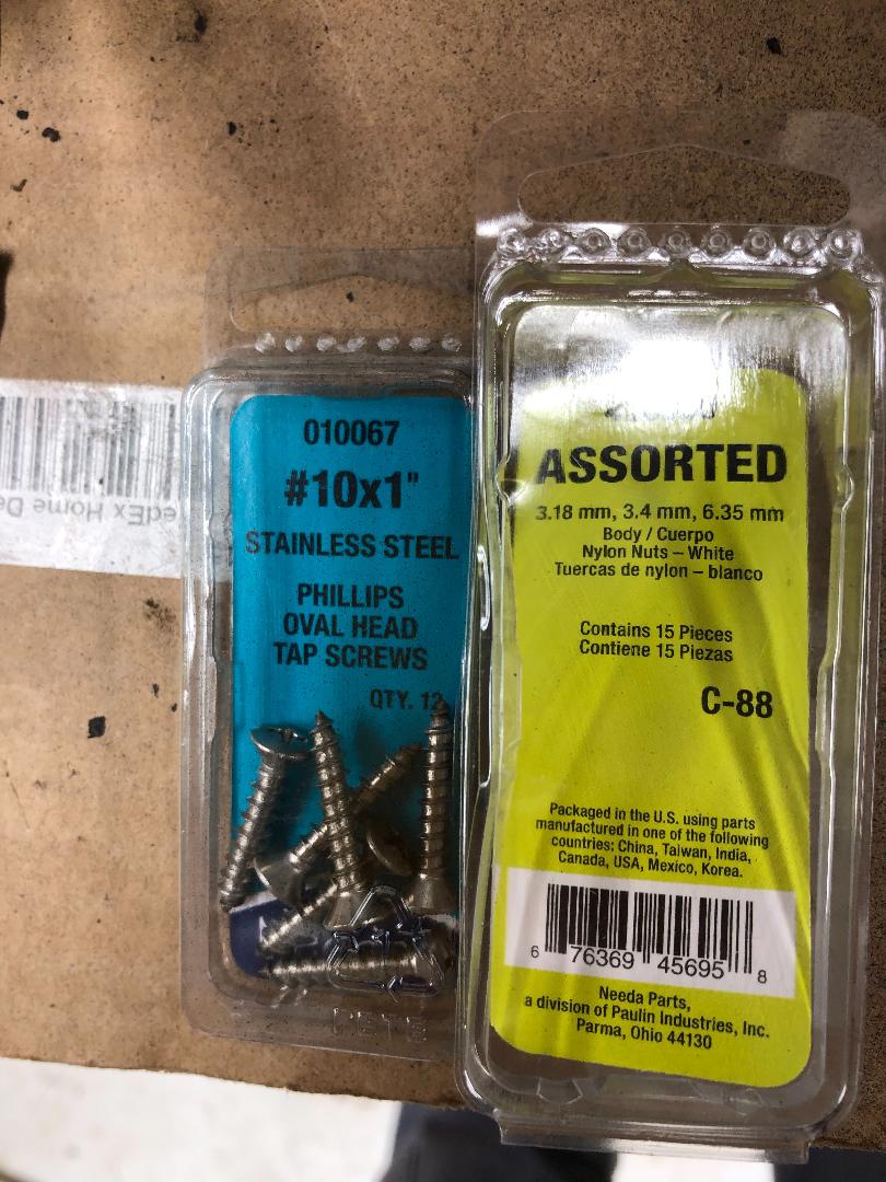

A trip to my local Autozone car supply store and I found these square body nuts.
I wasn't sure which size would fit, so I bought the assortment pack.
The 3.4 mm ones were a perfect fit.
A #10 stainless steel screw fit the nut nicely.
My license plate is now mounted on the car.
Ben.
