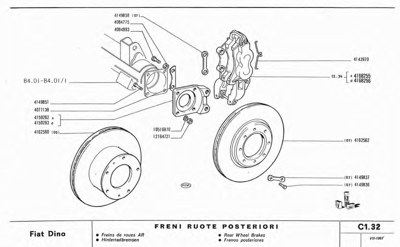

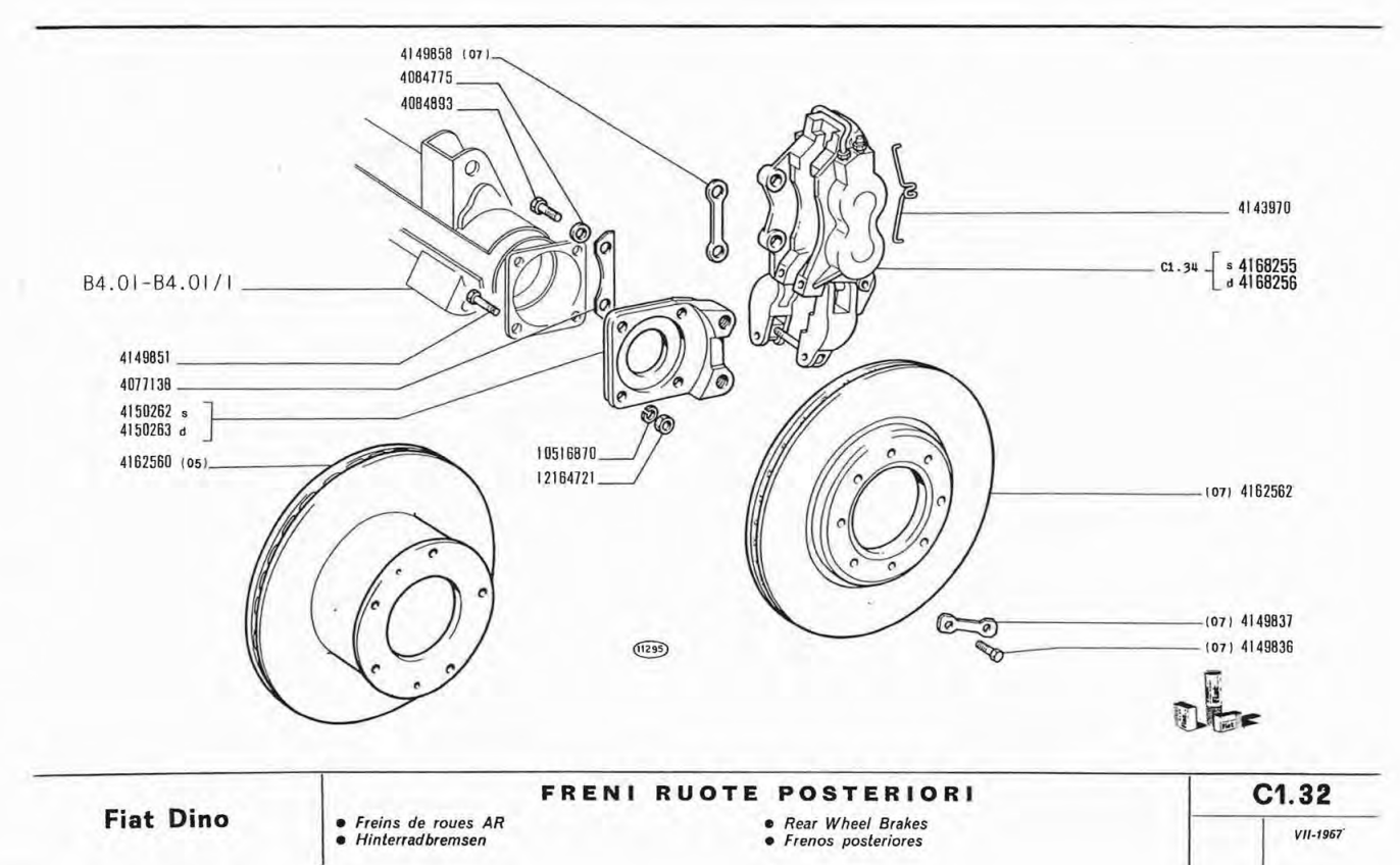

Assuming you don´t really need to separate the actual knock-off hub from the driveshaft, there is a way
withdrawing the driveshaft from the rear axle tube - with brake disc and knock-off hub still in place.
After dismantling the brake caliper from its bracket, only four bolts 4149851 are holding the brake
caliper bracket, which holds the driveshaft with the outer wheel bearing and brake disc in place.
With a suitible spanner, there is possible to undo the four nuts 12164721 and withdraw the driveshaft.
