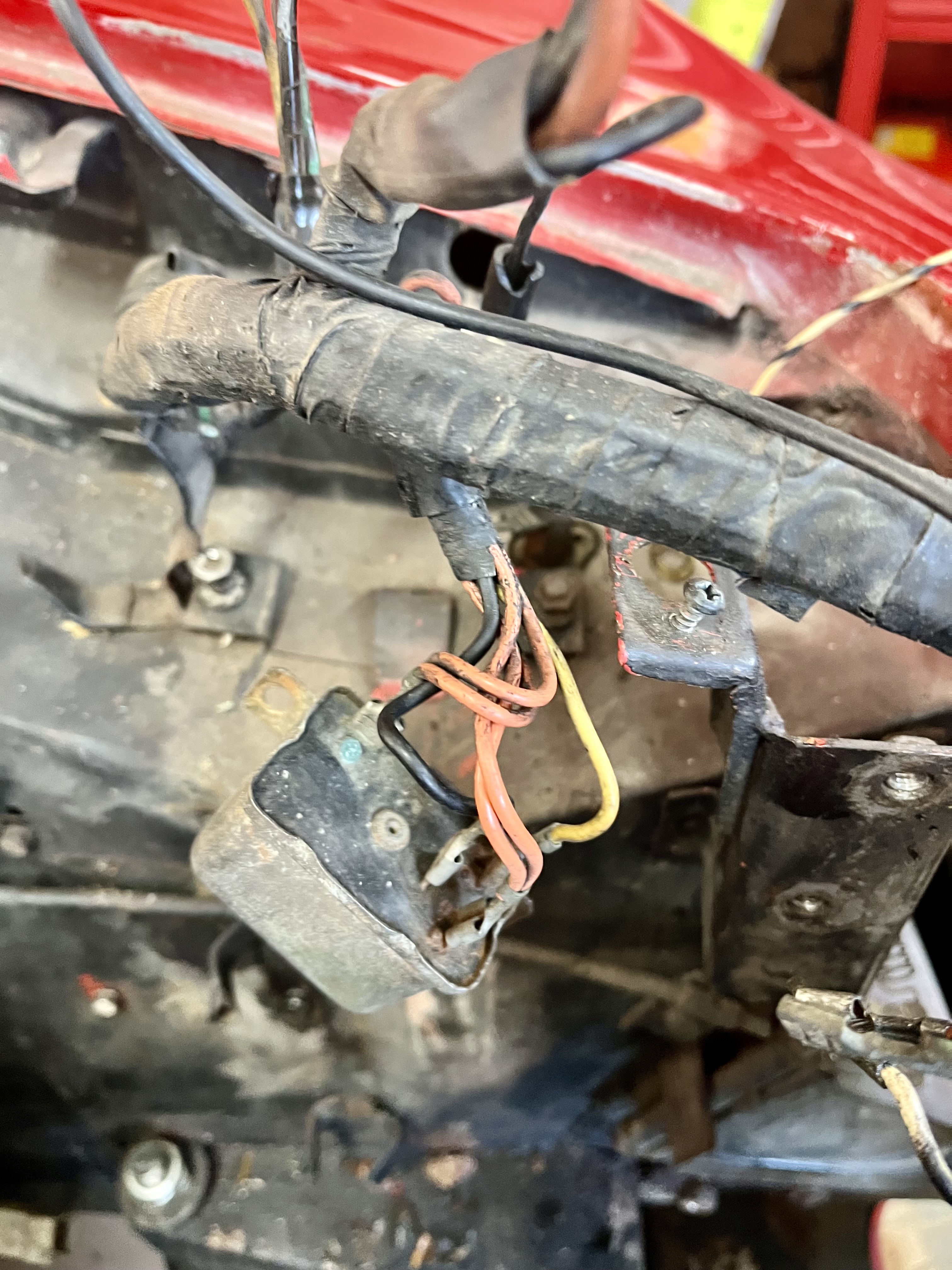

Boa tarde amigos,
I am continuing the complete strip down on my Spider. I’m working on removing the wiring harness. I’ve come across a relay that I can’t identify on any wiring diagram I have.
This relay is immediately above the relay for the cooling fan motor on the D/S at the front of the left wheel arch.
I’ve searched each diagram I have based on location and wiring colours.
The car is #000665, so early series 2.
Thanks in advance

It is the relay number 31, controlling the no-charge warning light, number 50.
In the electric wiring diagram, it is not shown placed-out as in reality!
