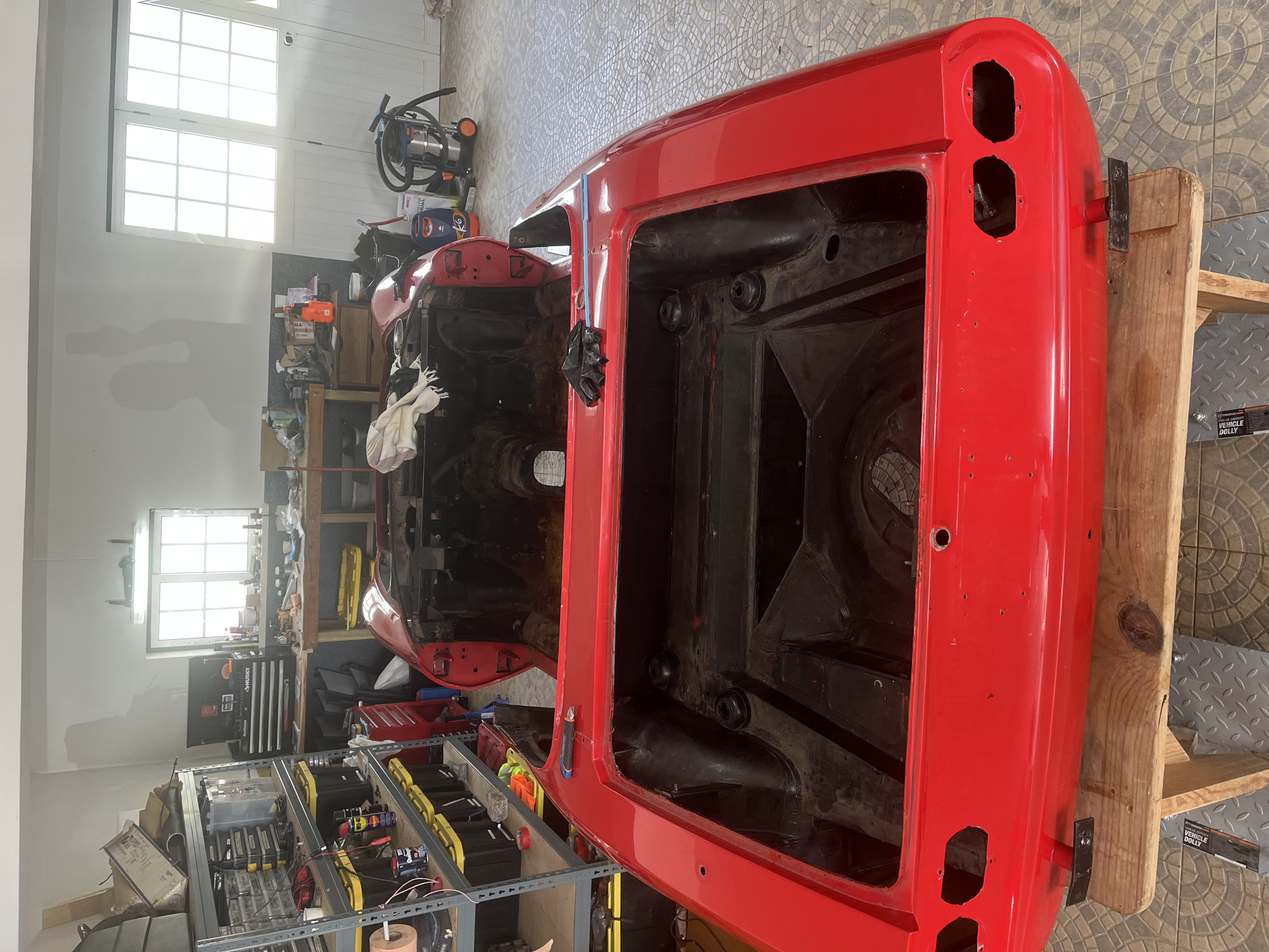

Now this is how the car looks, getting ready for restoring the body.

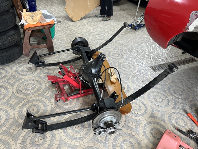

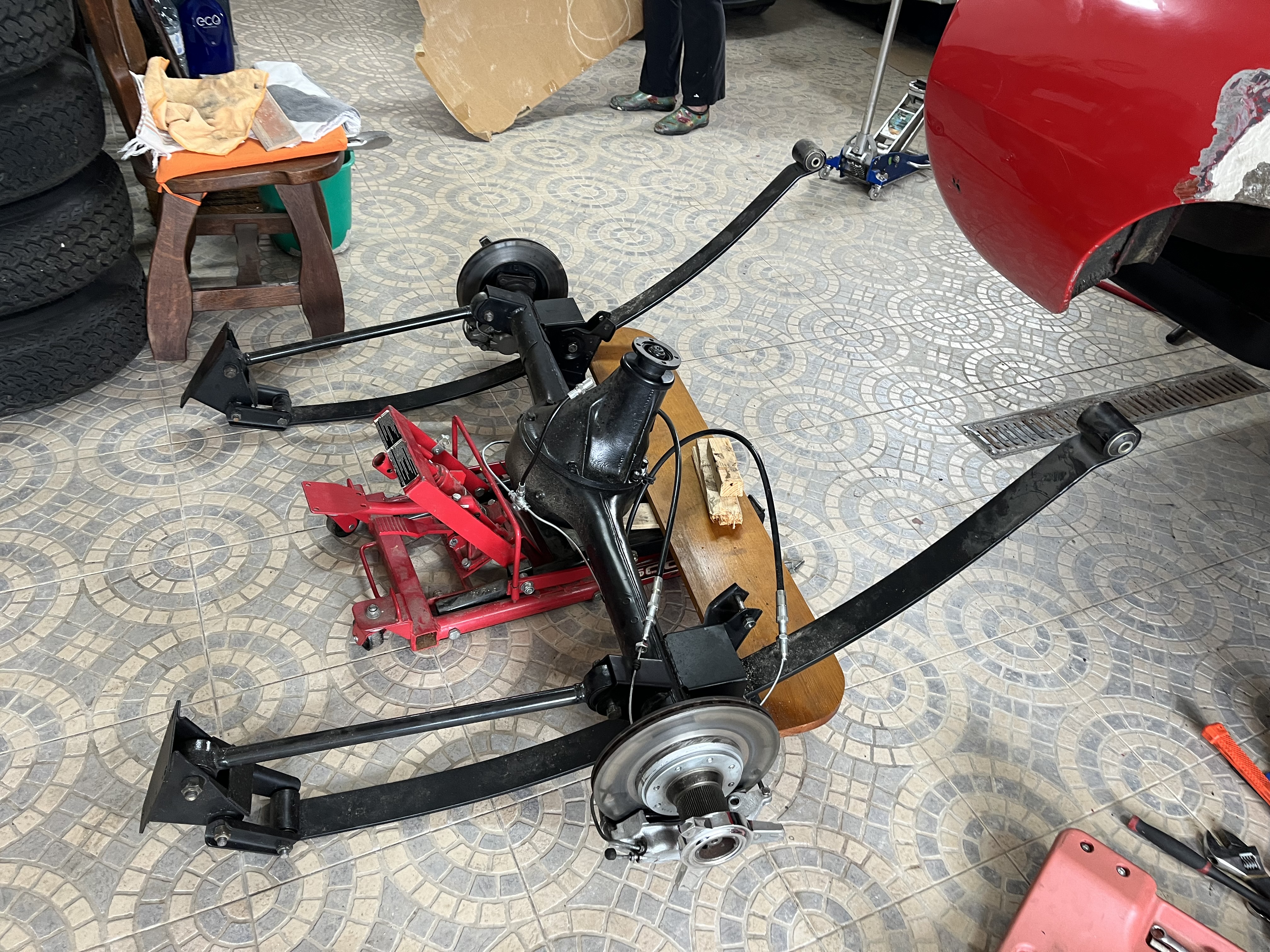

Dropping rear suspension in one piece. I restored this last year.

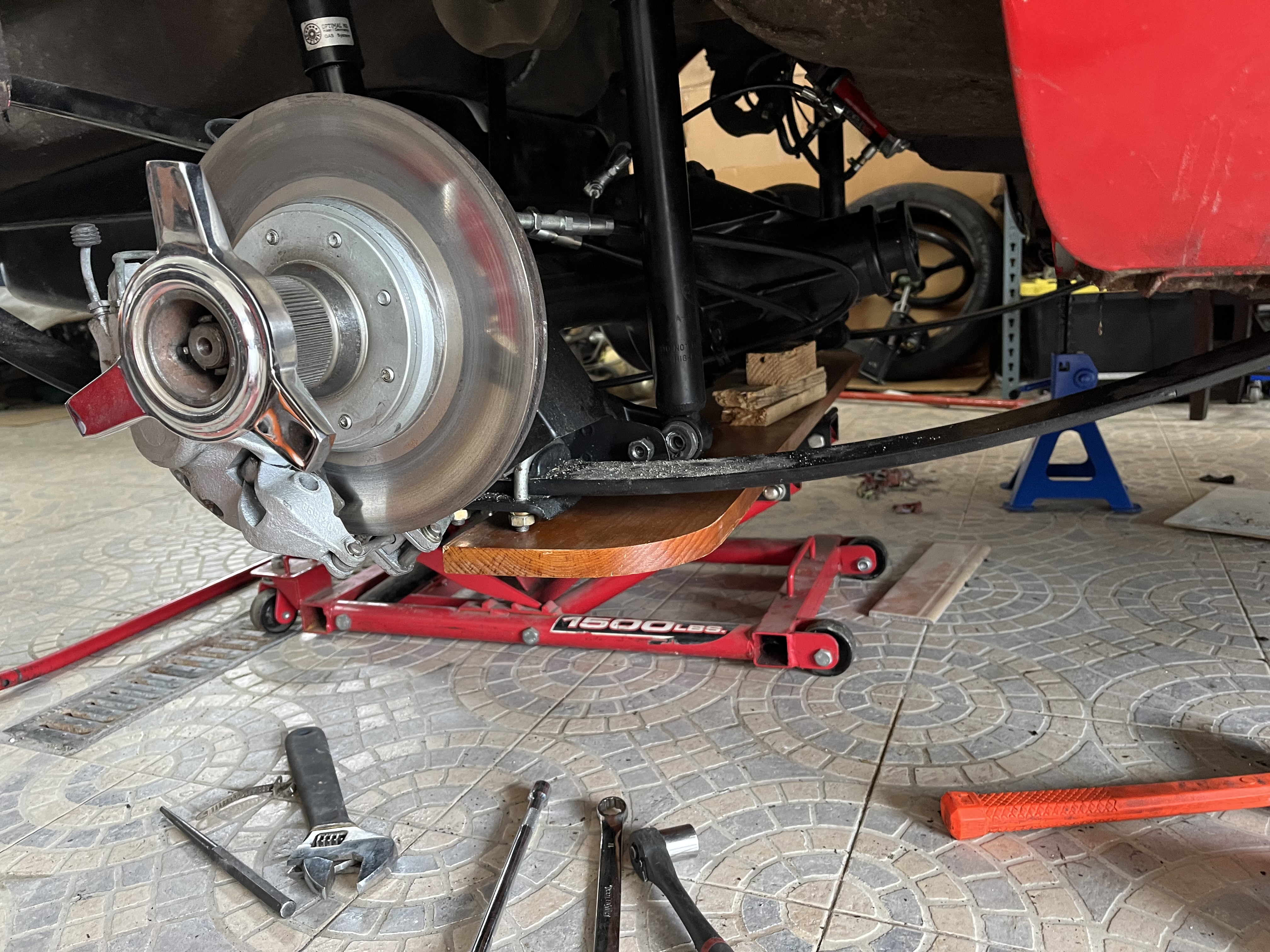

Just missing the shocks

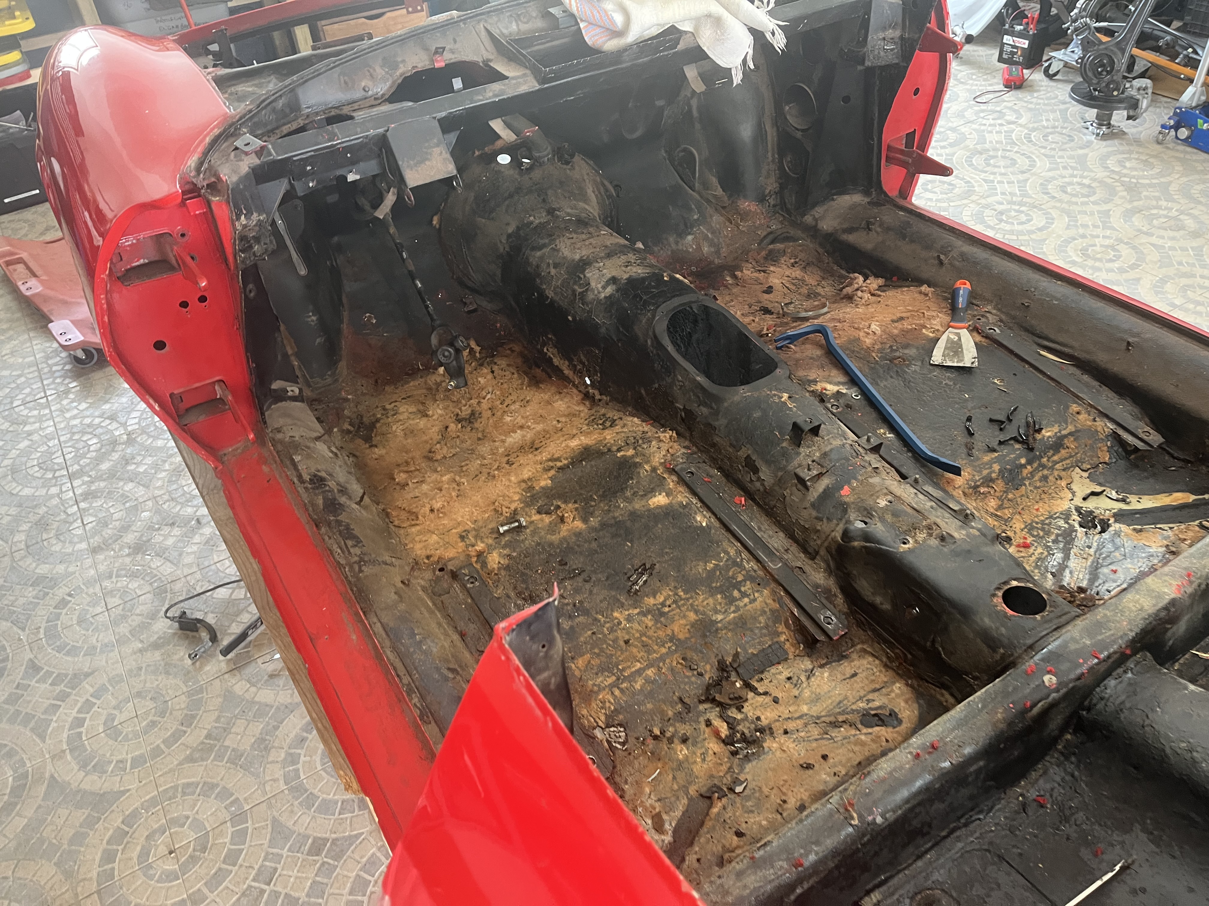

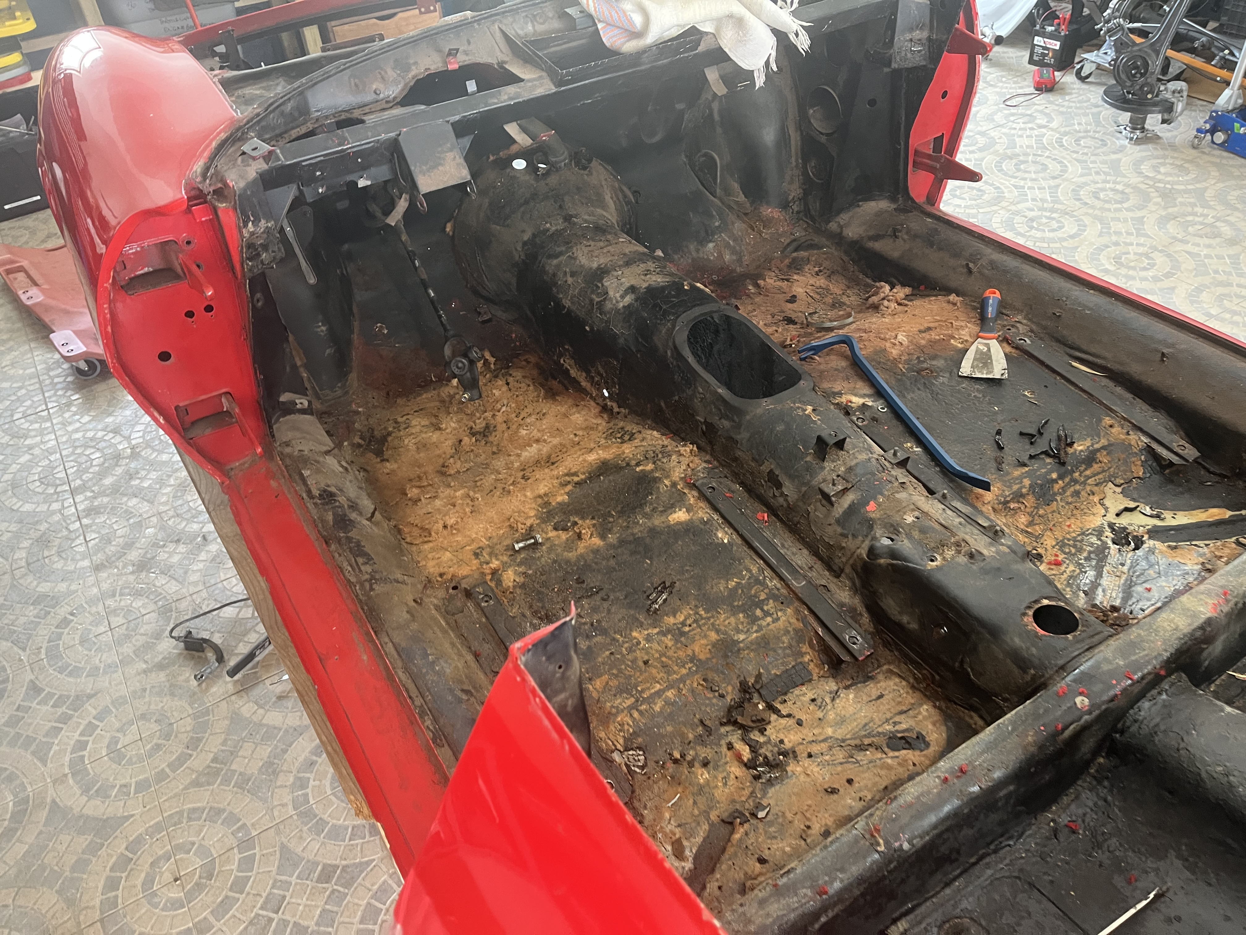

Totally bare shell
Totally bare shell
