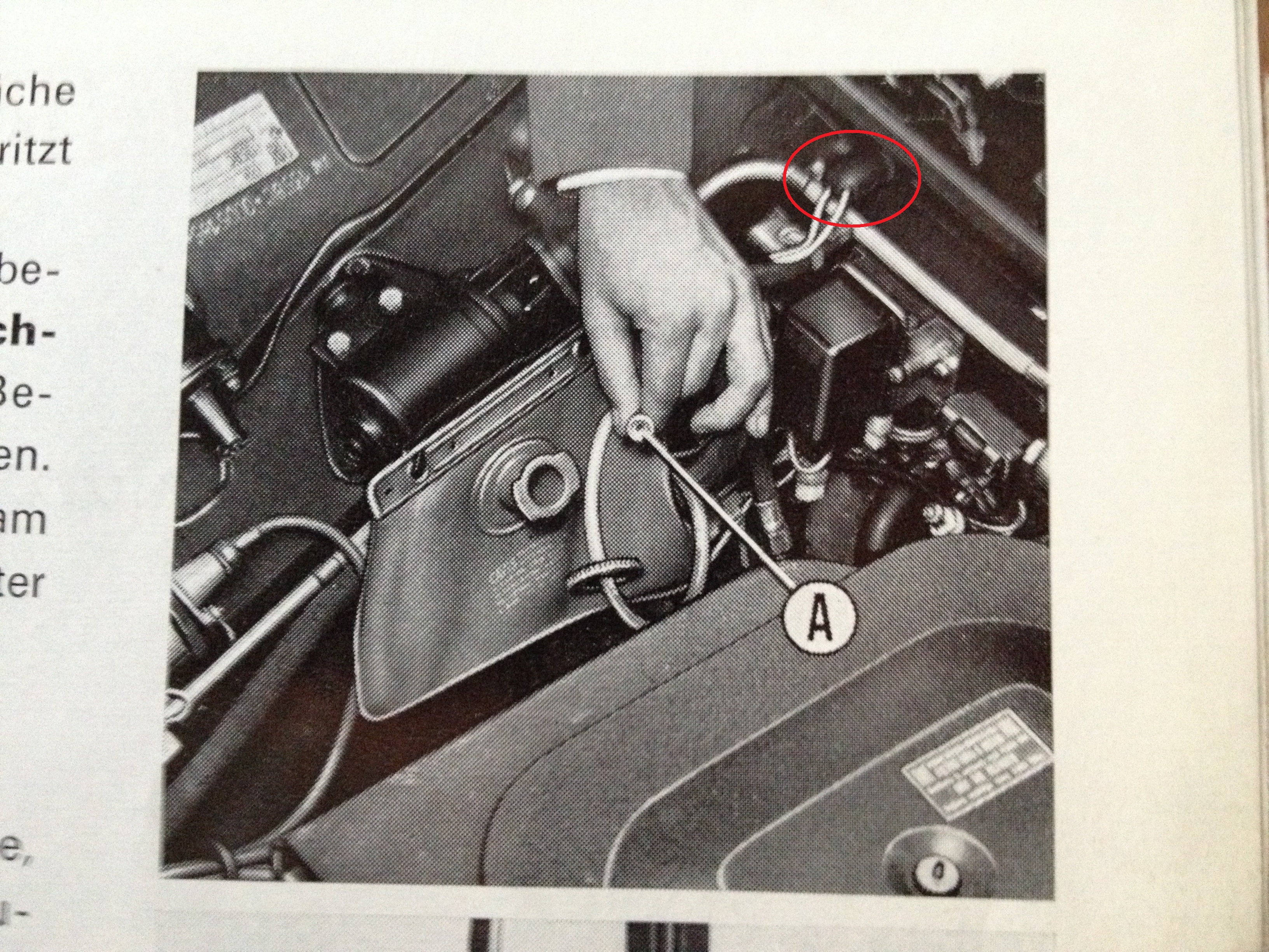

Please take a look at the attached picture, can you tell me what that fuse(?) is that I've marked with at circle? In my DIno it's replaced with a standard 10 amp fuse. I've looked at the wiring diagram but can't figure out what it is. The problem is, when I turn on the ignition, that fuse blow and I'm not sure if that is a small or big problem...

I drive since 6 years without this fuse (when I remebder correct the white wires are linked together). Don´t know what this is for, I suppose for the vacuum pump, as this is also not part of the wiring diagram. KR, Thomas

That would explain it, haven't found anything in the wiring diagram with two bianco wires attached.ThomasK wrote:I drive since 6 years without this fuse (when I remebder correct the white wires are linked together). Don´t know what this is for, I suppose for the vacuum pump, as this is also not part of the wiring diagram. KR, Thomas

I just had a quick look at my car. I still have this fuse connected (I didn't knew that this is a fuse). One of the two wires seems to go to the bulkhead and the other into a relay just around the corner of the bulkhead. This relay has also blue and black/blue wires. I also don't have a clue of the function.

The fuse and relay provide current for the vacuum pump for the brake servo. Normally, with the engine in operation, there is enough manifold vacuum and the pump is off thanks to a vacuum sensor (there is a small screw in the back for adjusting the cut-off, behind the rubber cap). It's there in case you loose engine power while driving. If it keeps blowing, check the relay and pump!

Many thanks! I'll check that.Dario wrote:The fuse and relay provide current for the vacuum pump for the brake servo. Normally, with the engine in operation, there is enough manifold vacuum and the pump is off thanks to a vacuum sensor (there is a small screw in the back for adjusting the cut-off, behind the rubber cap). It's there in case you loose engine power while driving. If it keeps blowing, check the relay and pump!

I think I know what the discussed "fuse" is for. It is a safety cut-off switch, according to the Fiat original spare parts list (no 4235474). In the wiring diagram it has
no 73. It is supposed to protect the vacuum pump to break down in overheating, caused by a leak in the vacuum tubing and servo system. Normally, if the system
is without leaks, the vacuum sensor (no 4216460) starts the vacuum pump if the vacuum pressure is too low, and cuts the power off when it reaches normal value.
If a leak somewhere in the system letting air in, the pump will obviously start, trying to compensate for the vacuum loss. But the vacuum pump will get very hot
after a while, so for protection, the discussed cut-off switch will stop the pump after some 10 seconds or so.
I have personal experience of this. I owned a 2,4 Coupe during the 80´s, and I once noticed a humming noise, that I did not recognized. It was the vacuum pump
going on and off, in short periods of 10 seconds, because of an air leak in a hose. The cut-off switch did its job, but I can assure you all - the vacuum pump was
VERY hot!

Does anybody know of a modern version of this "motor-protector" that could be purchased and adapted for use in the Dino? I imagine it's some sort of "bimetal strip" device (like a flasher relay but with far different properties) that heats up, disconnects, cools, reconnects etc. I've never seen one for a motor, however.
This circuit is the worst aspect of my Dino's electrics - the motor seems to require very heavy current, and draws it from a circuit that includes the fuel pump, which is susceptible to voltage drops - I'm thinking of re-wiring with a separate fuse. or disconnecting altogether.
