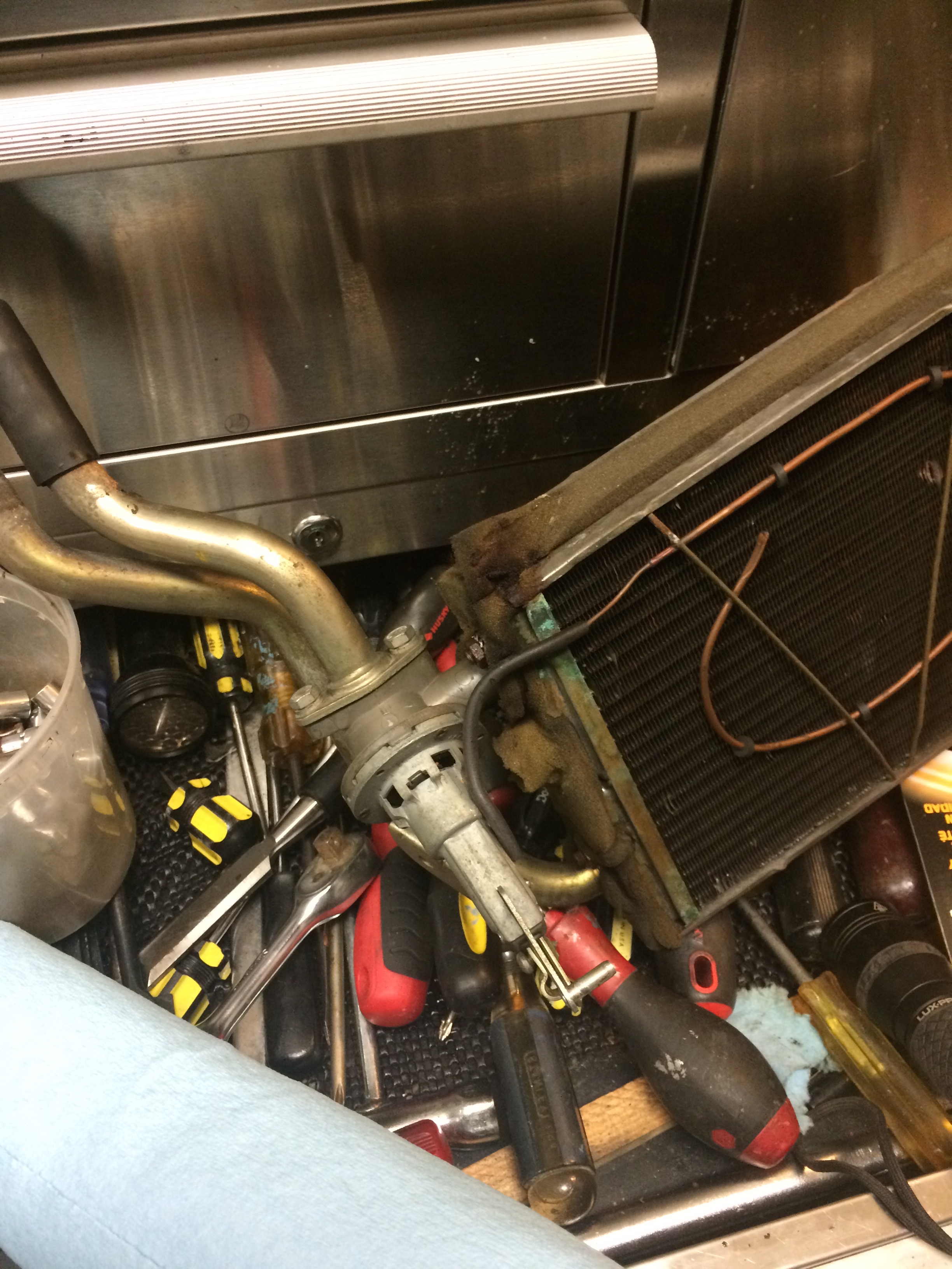

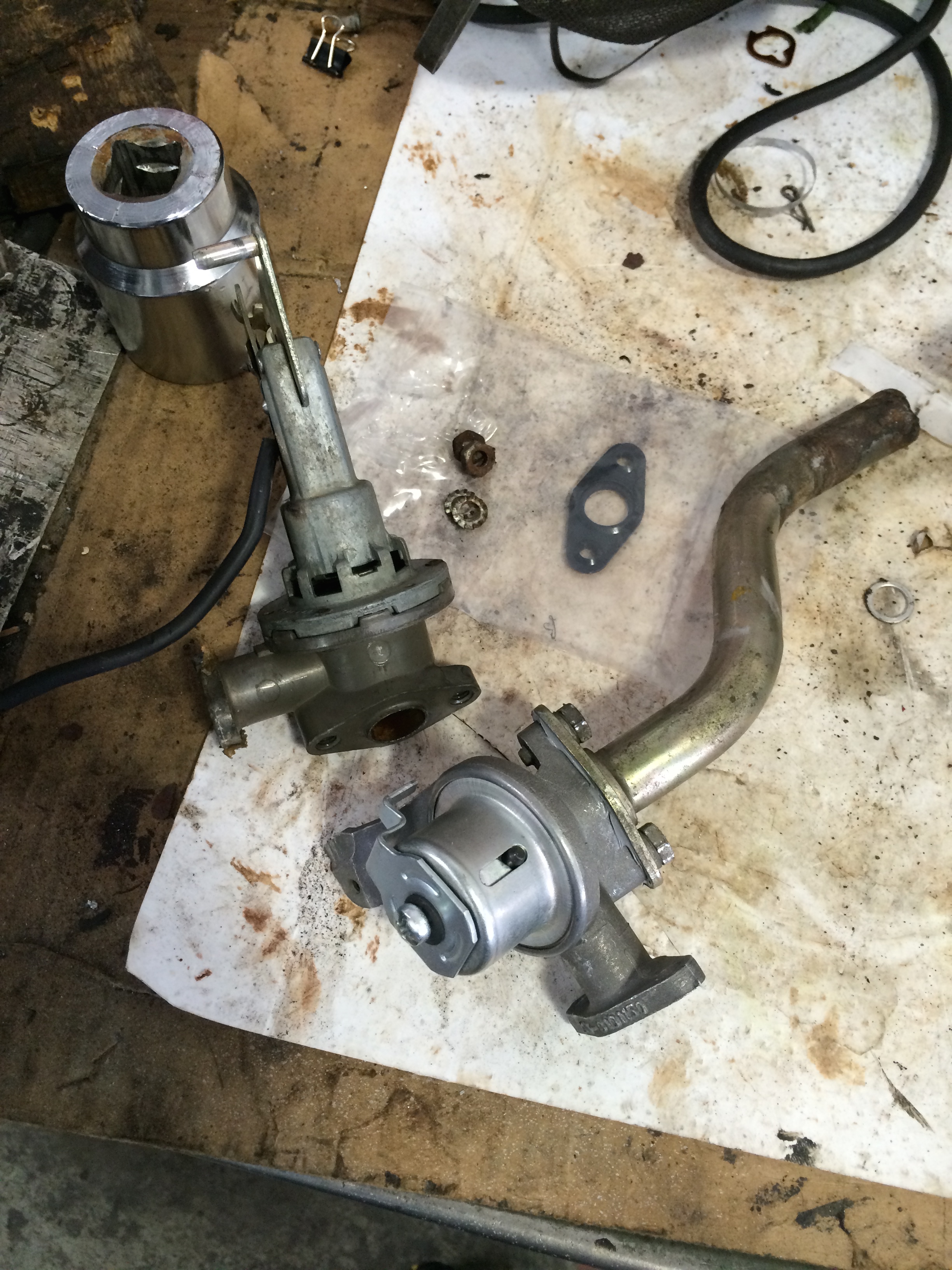

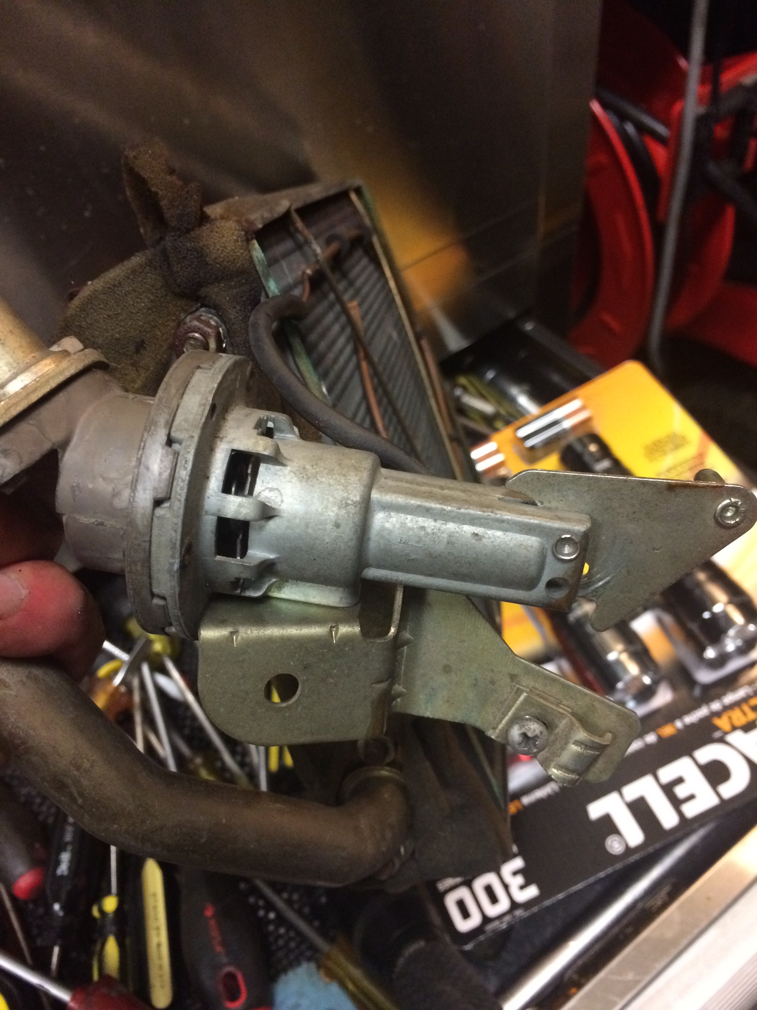

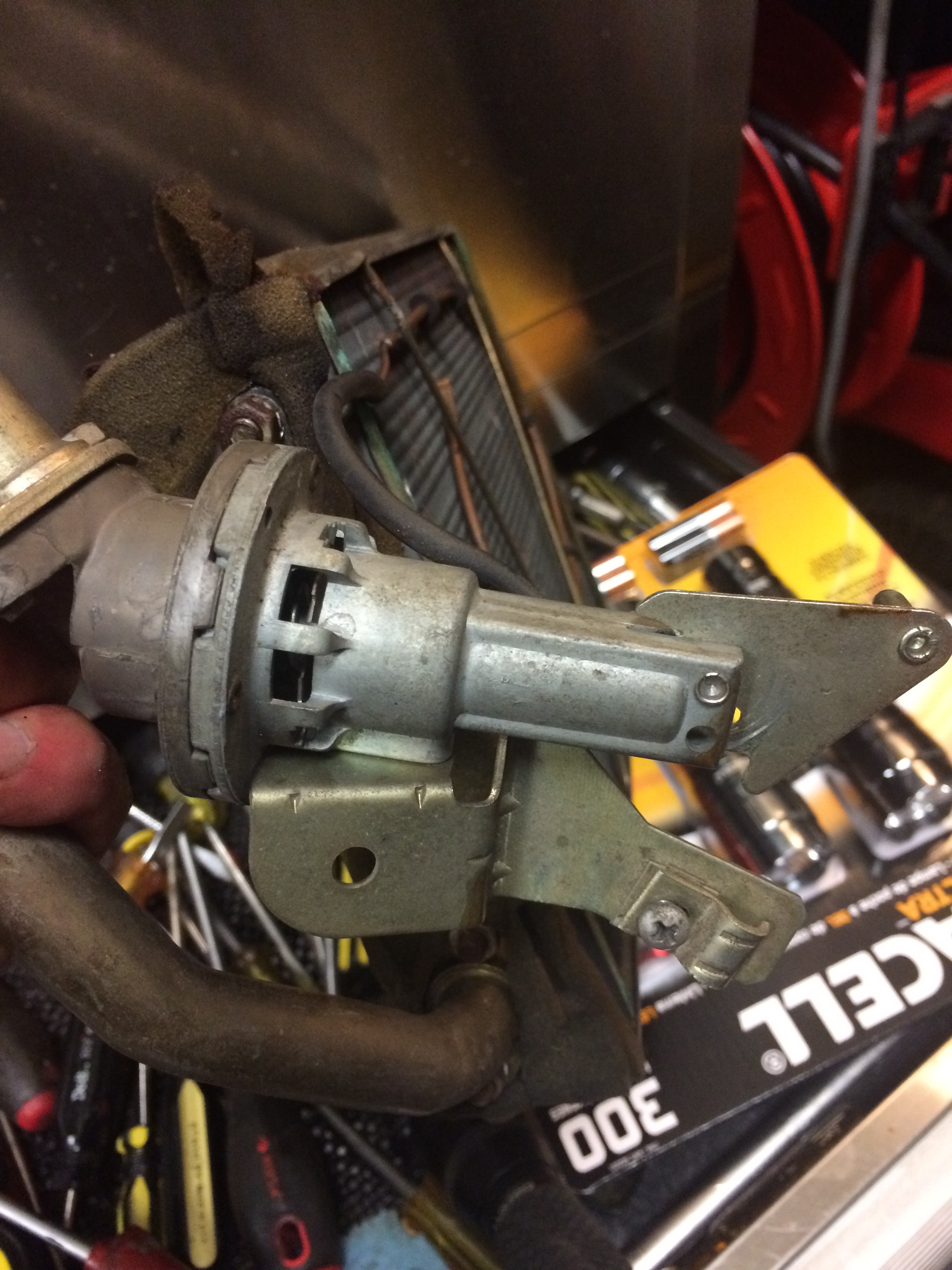

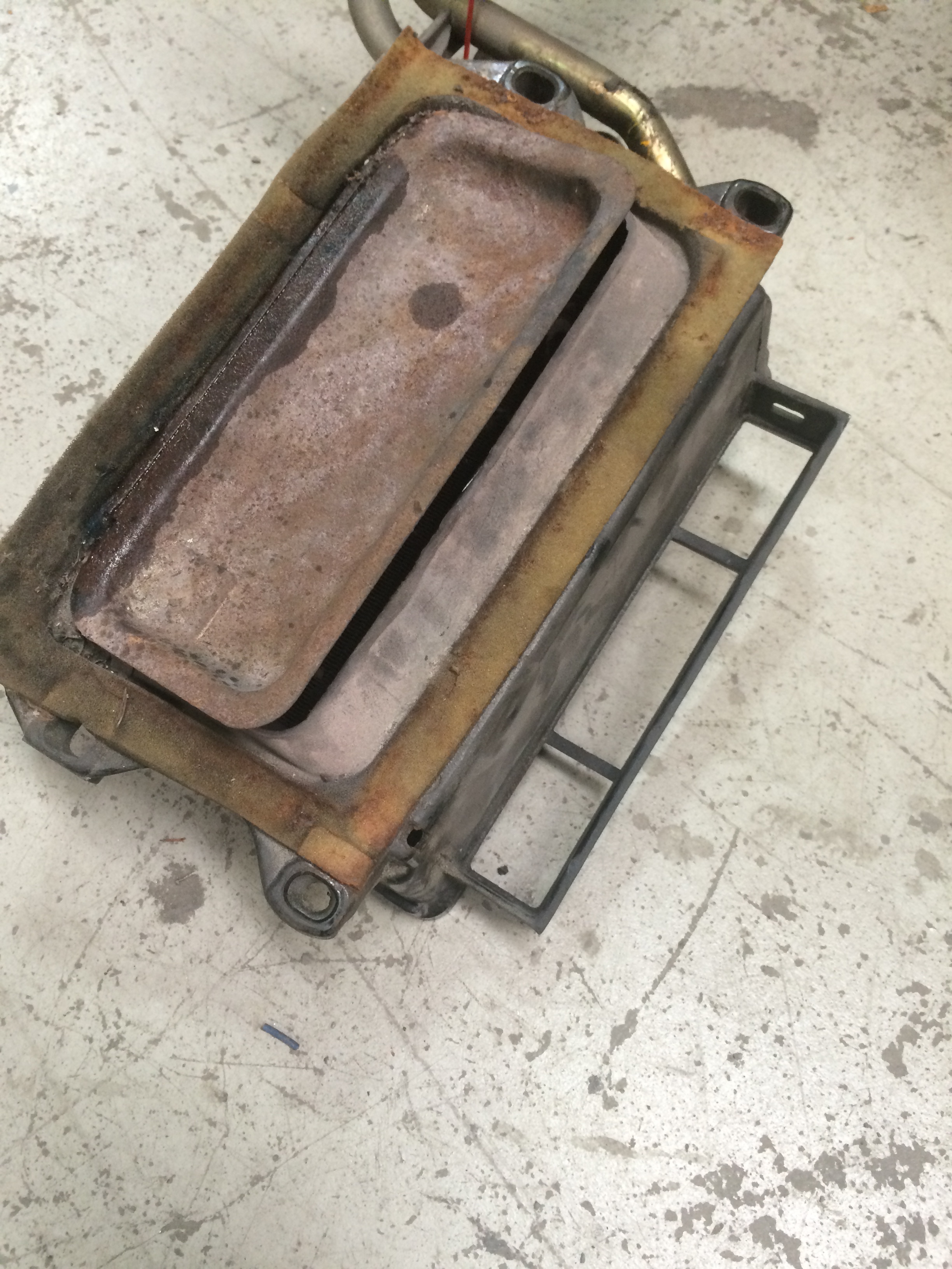

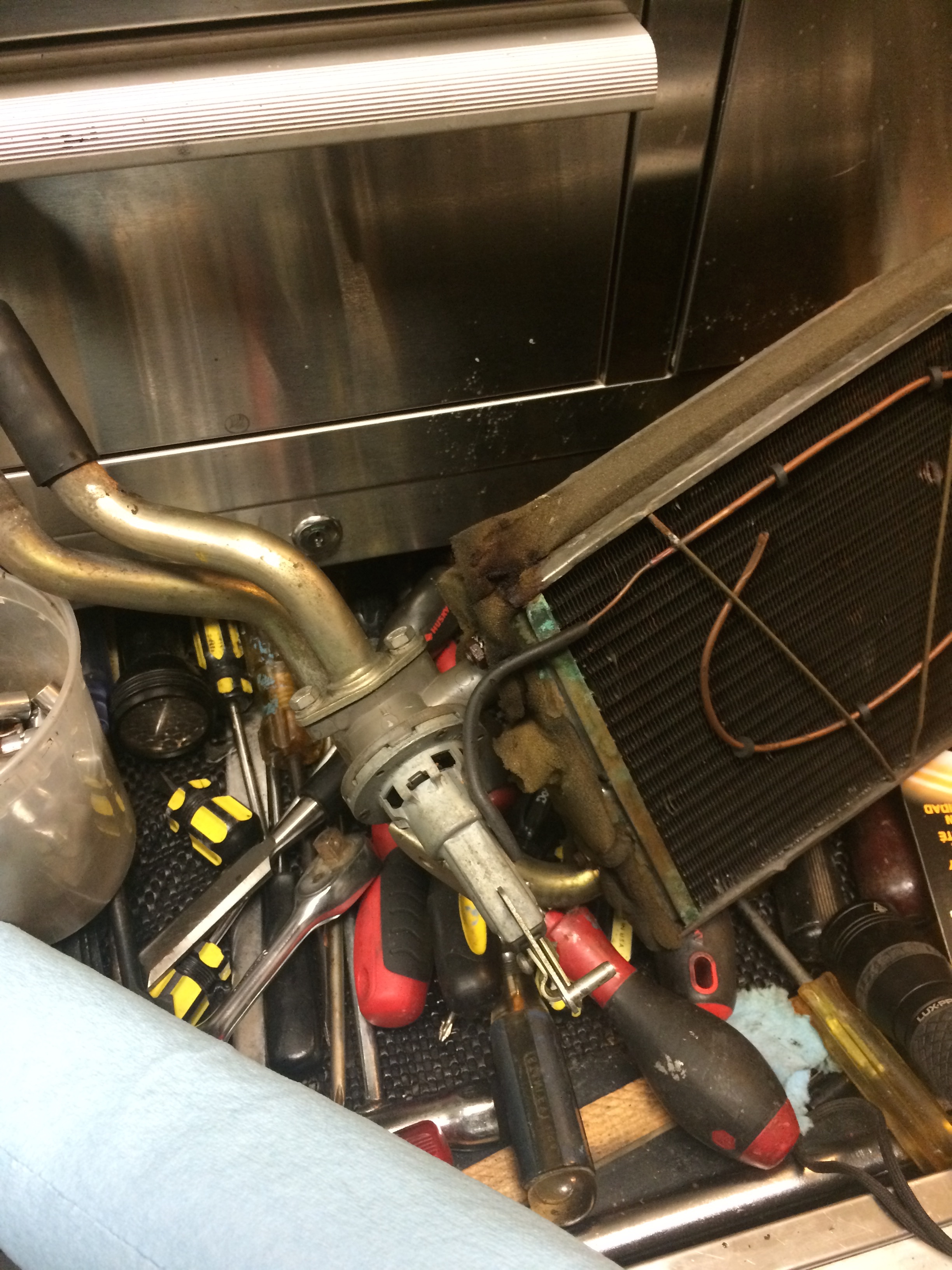

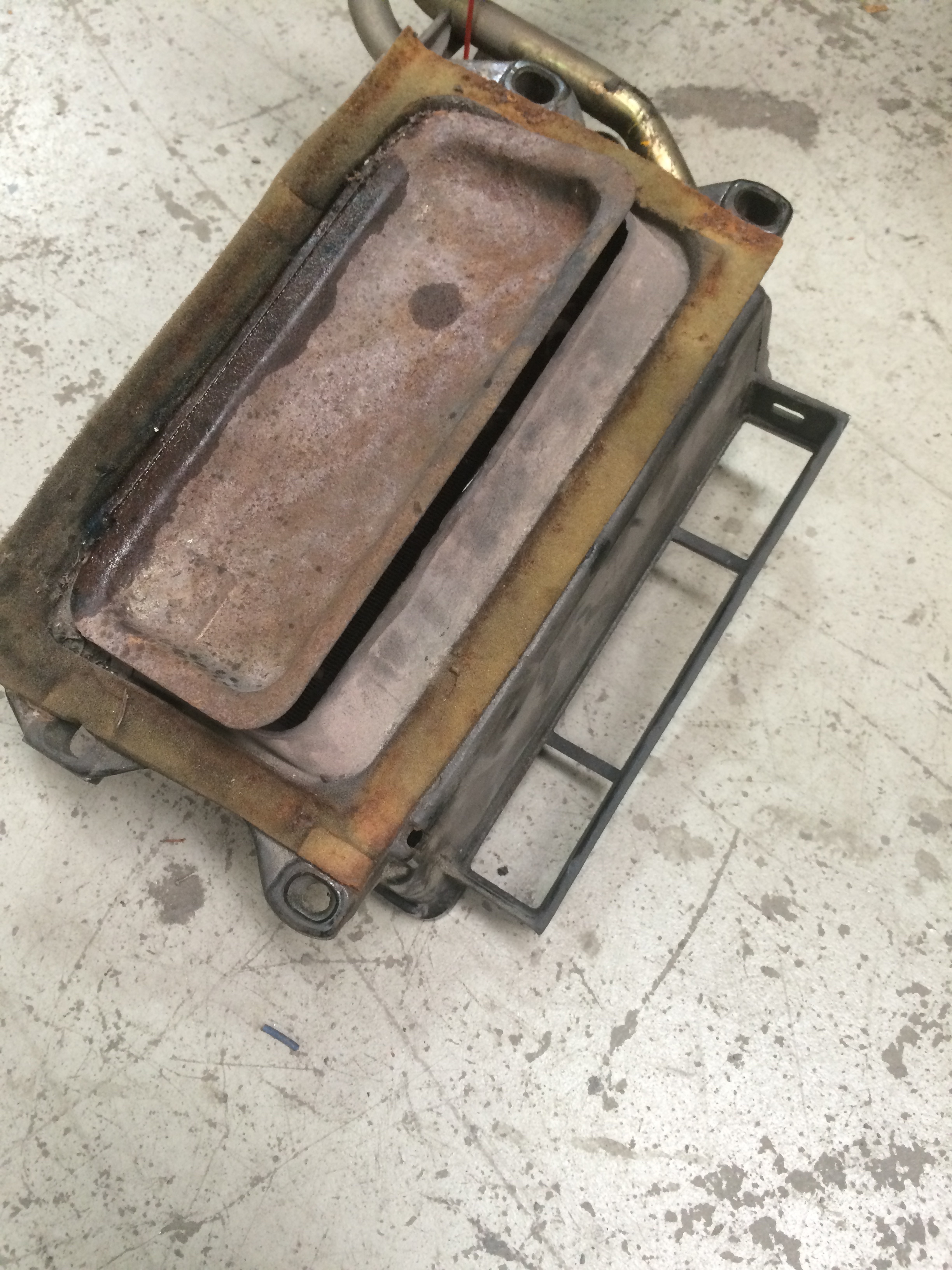

I am in the middle of a heater core cleaning.
My heating box was in pretty dirty and the core is ok with no leak.
However the valve inner rubber is completely gone.
I ordered a new valve from Superformance, but the wholes do not line up with the studs.
We made some modification to the new valve to make it fit to our old core... To no avail.
Now going to plan B will see if I should order a new Kit from
http://www.autoricambi.us/product/HE6-4 ... e-Over-10/
But now I wonder if the pipes will fit correctly through our fire all...
Anyway this is the sort of job I never want to do again, especially with new carpets.
