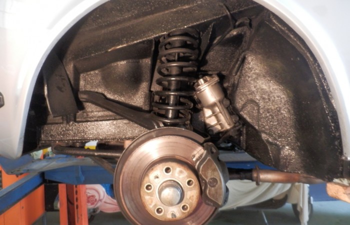

After finding out my steering box is wrecked, I was wondering if the 132 steering box would fit. Does anyone know? I have a good chance to get one.

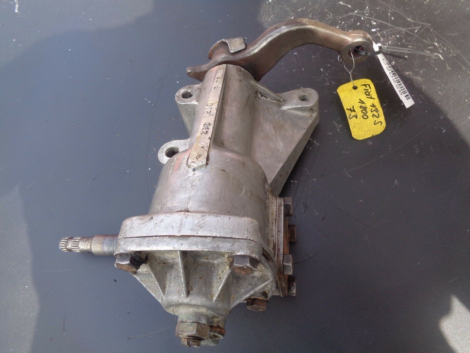

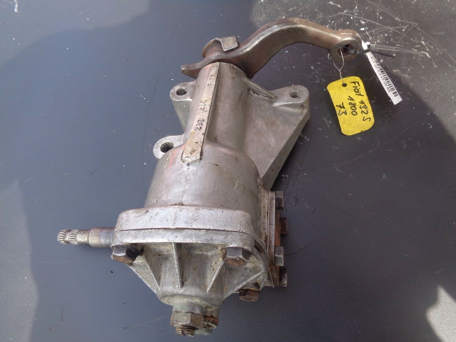

That is still a good question!
Currently several 132 steering boxes are offerd on ebay.
Has anybody tried that?

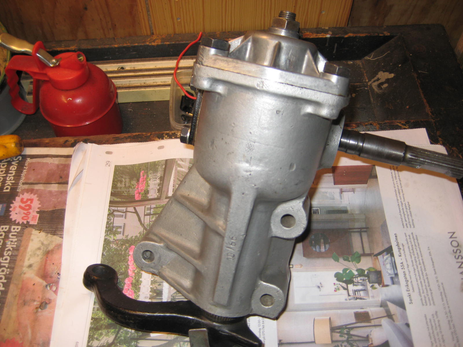

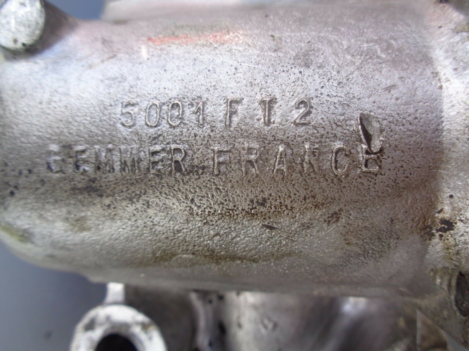

Re: Fiat 132 steering box into Dino Coupe

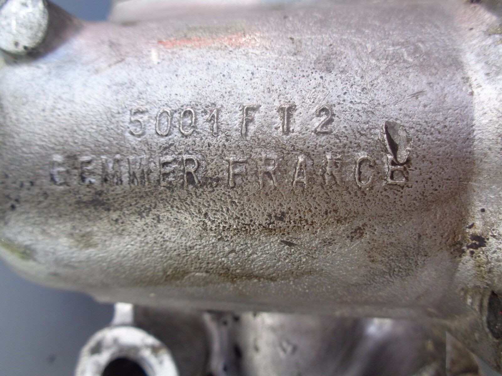

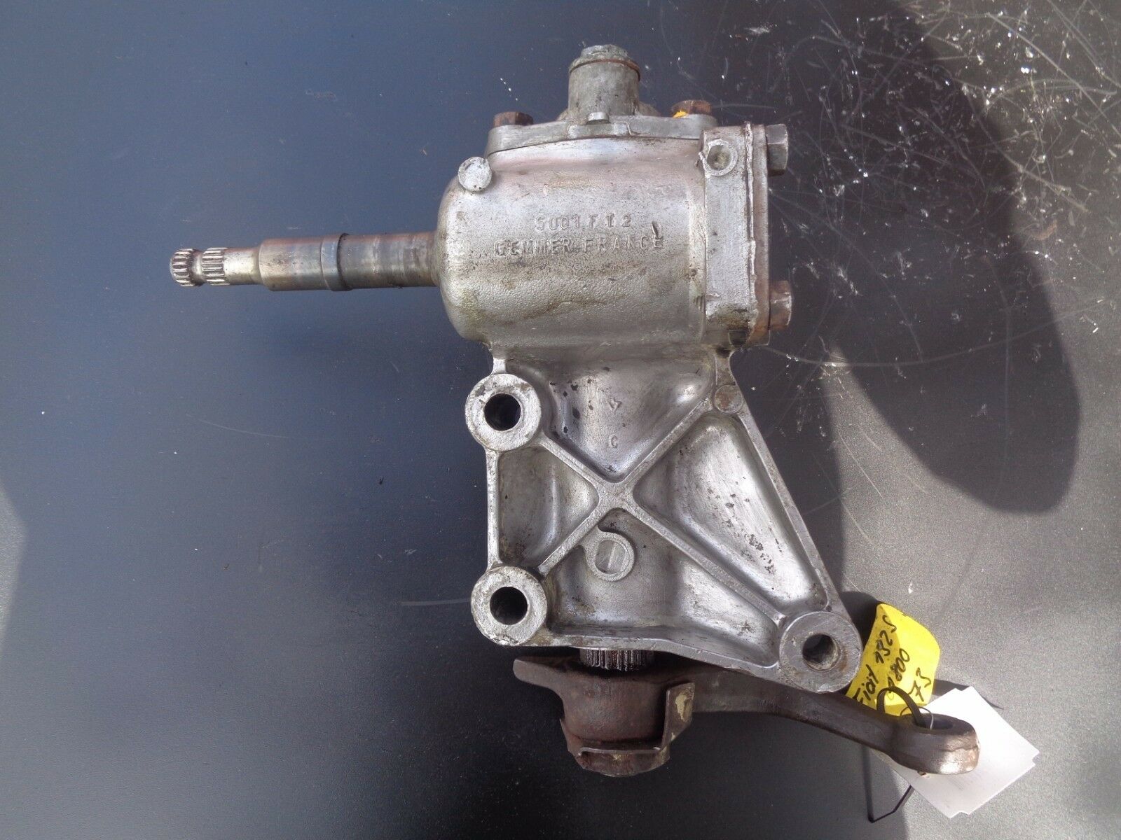

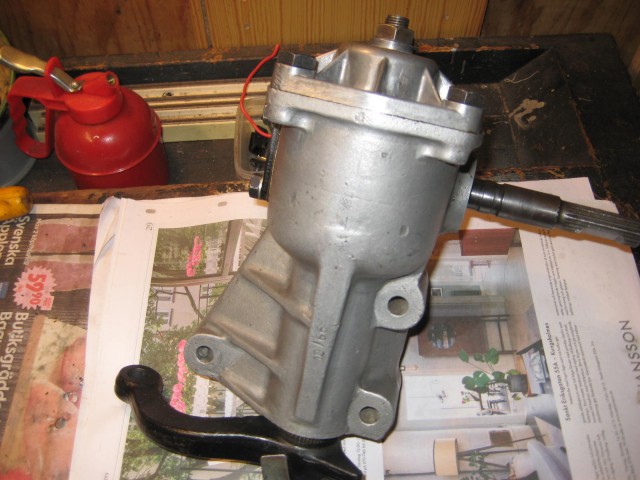

It will not fit right on. The three bolt-holes has a different pattern than the Dino steering boxes.
I think the same goes for Fiat 125 S steering boxes, as well.
Gemmer/Fiat Dino steering box Dinoswede

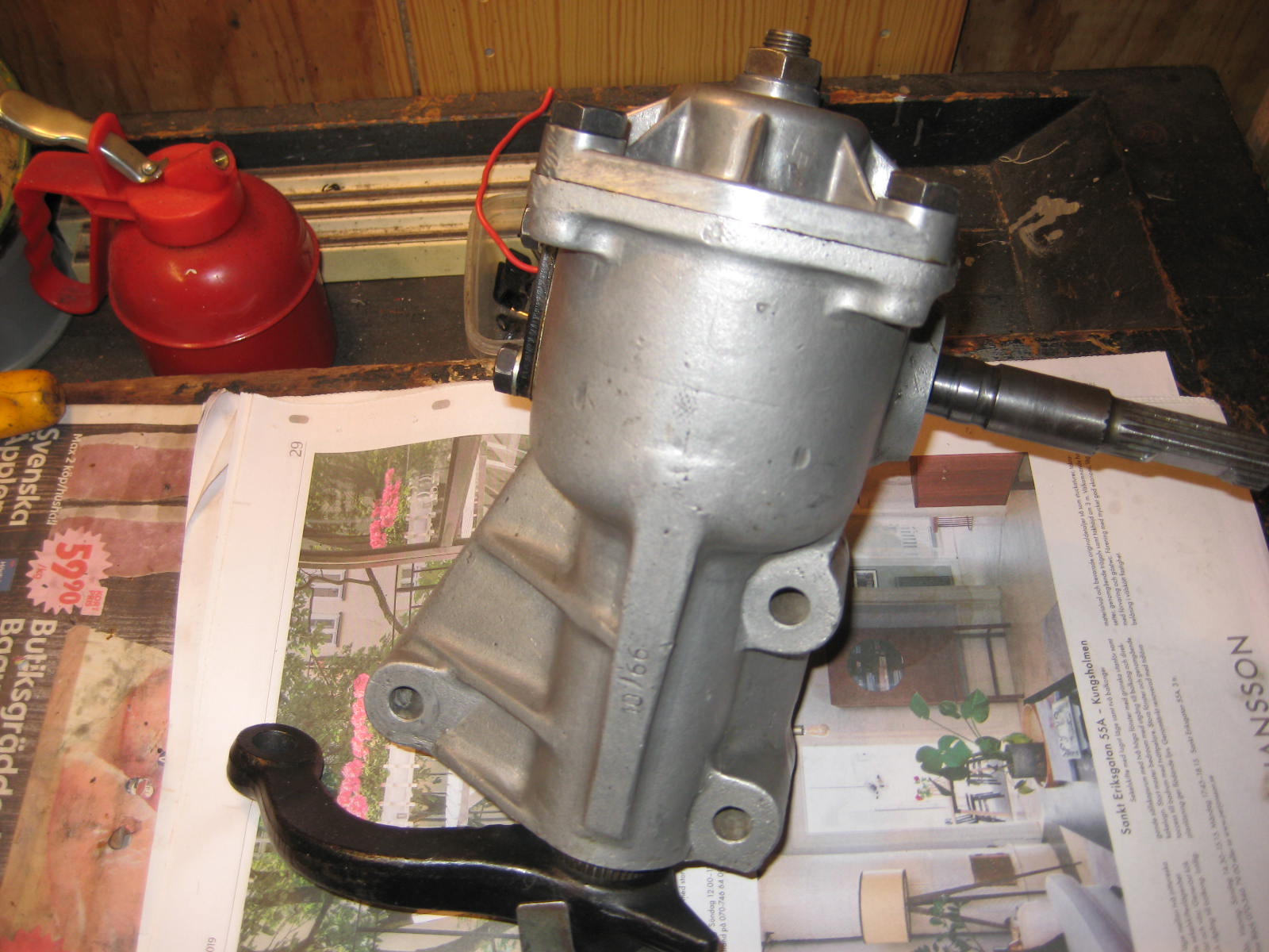

I have a great one with all new parts..
