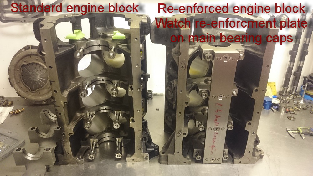

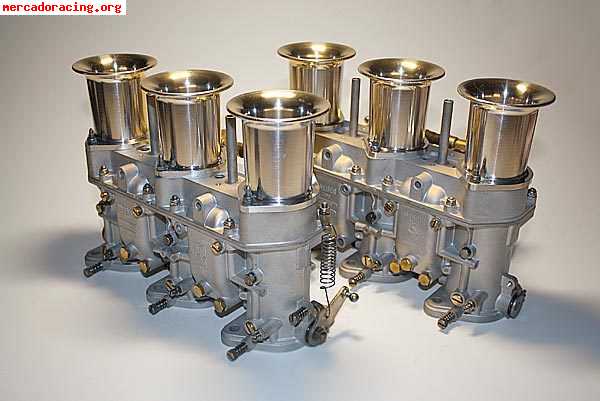

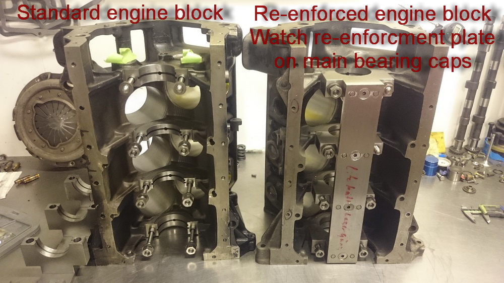

Do you think that 2 triple Weber carbs would work.(Of course I have to make a special intake manifold, but I think it would be feasible!)
Of course I will probably need to strengthen the cil. block as I intend to have more engine modifications done (see pic)

Dinofan, What advantages would the IDA 3C provide? Realizing that DCNF can be had in 42 or 44mm versions if increased CFM is needed, the DCN series is ideally suited to the longitudial placement of the engine in the Fiat Dino versus the transverse placement of the Ferrari and Lancia. The original 1957-60 65 degree motors that ours are modeled after use carbeuration that would be of the same family as the more production oriented DCN / F series. ie: Downdraft 2 barrel side by side sharing a float bowl that is perpindicular to the cars direction of travel. The inlet ports are designed to line up symmetrically between the L & R cylinder heads allowing simple manifolding with equal runner lengths for the DCN/F style. The 3 inline double barrel setup also benefits from a much simplified and sensible linkage arrangement than the IDA-3C would require.
