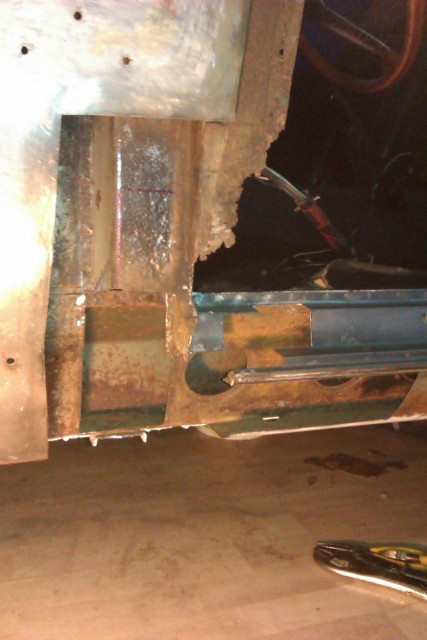

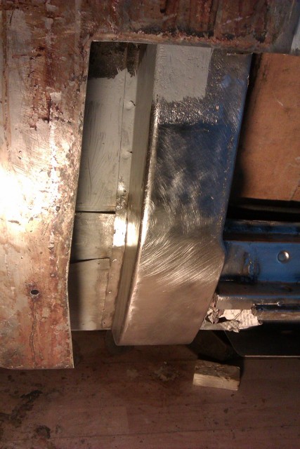

Post by 4cambob »

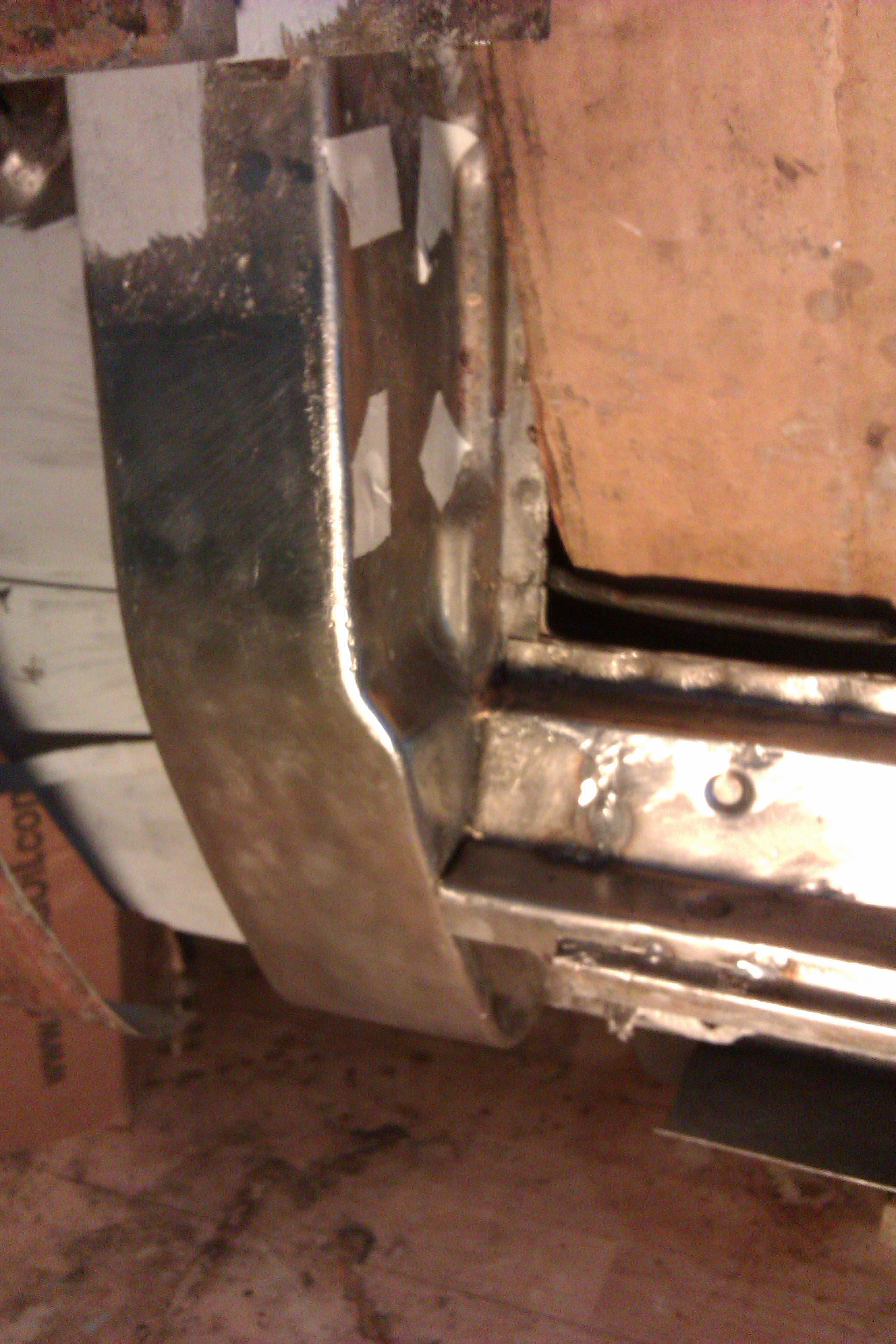

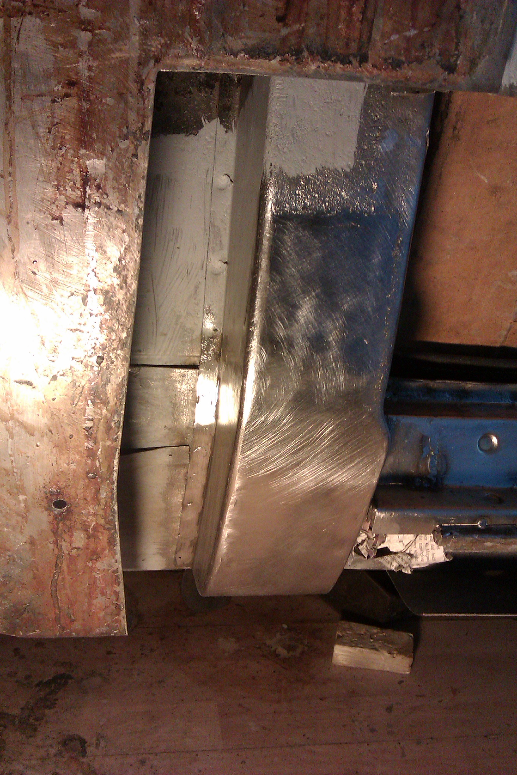

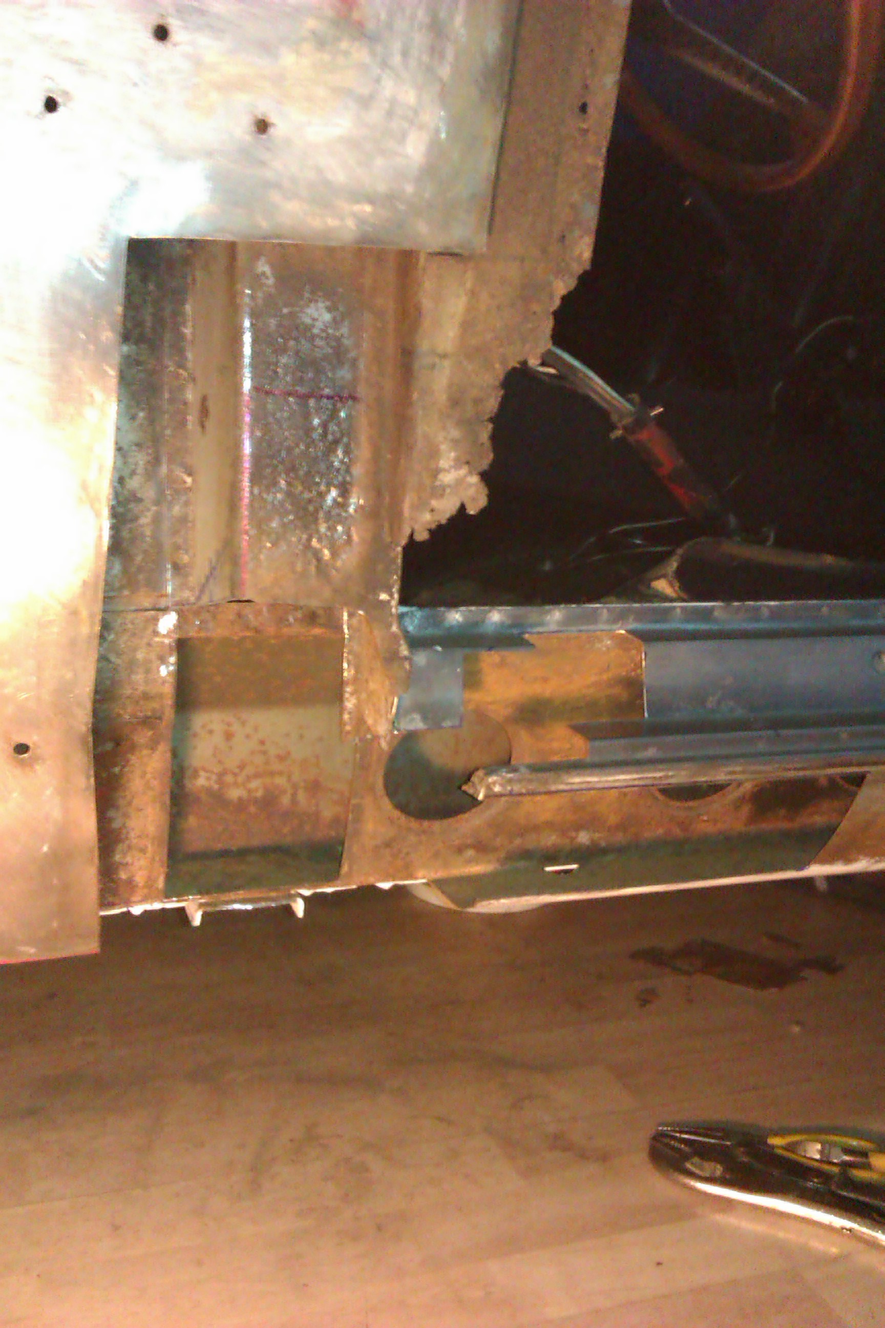

I would be grateful if someone has a photo of the panel between the front wing/fender and the A pillar box section where the door hinges mount to. The lower section of mine was just thin air due to rust and I need to fabricate a new one. These are photos of the area and the finished hinge mounting box section.

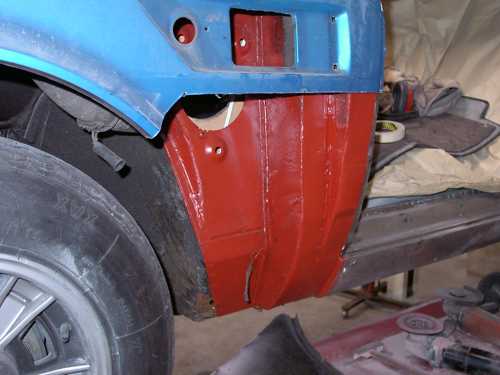

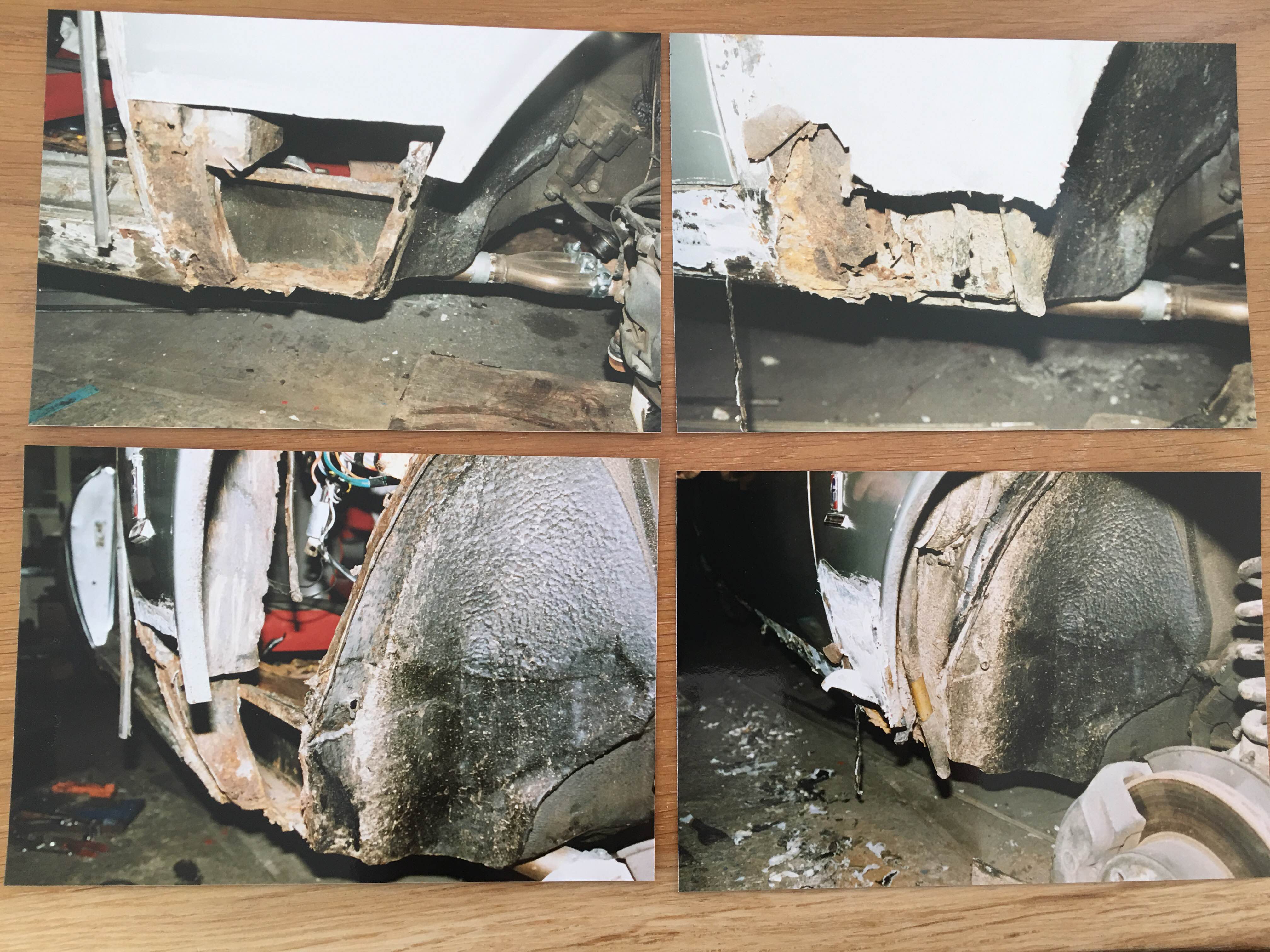

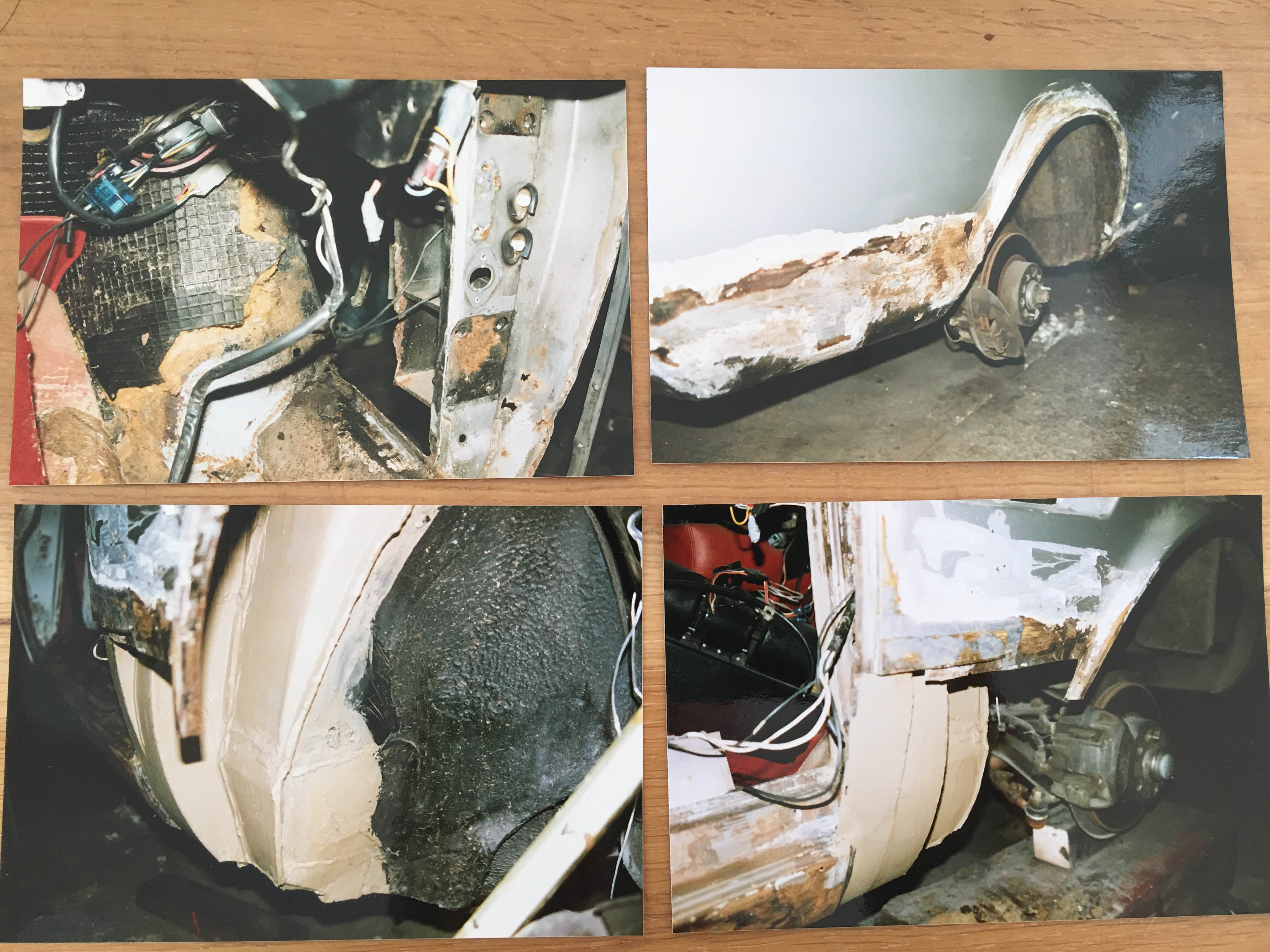

Does this help?
Posts: 135
Re: Photos of coupe inner body section needed.
Post by Ribolla_67 »
Found these pictures, maybe helpful. Fortunately NOT my car...

Thank you very much Georg,yes that is what I was looking for. I would also like to ask if you know how the front wing attaches to the outer sill where there would be a visible vertical groove. I would guess this would be brazed/gas welded, certainly not spot or mig welded.
4cambob
Posts: 129
Post by 4cambob »
Thank you Ribolla_67 . And there was I thinking my car must be the only rusty car out there. It seems this area is very susceptible to corrosion. I will at a latter stage try and fabricate a fibreglass inner wheel arch as there are too many items under the front wings which are all exposed . This is the first time I have seen the parts catalogue,it is very useful to see.
