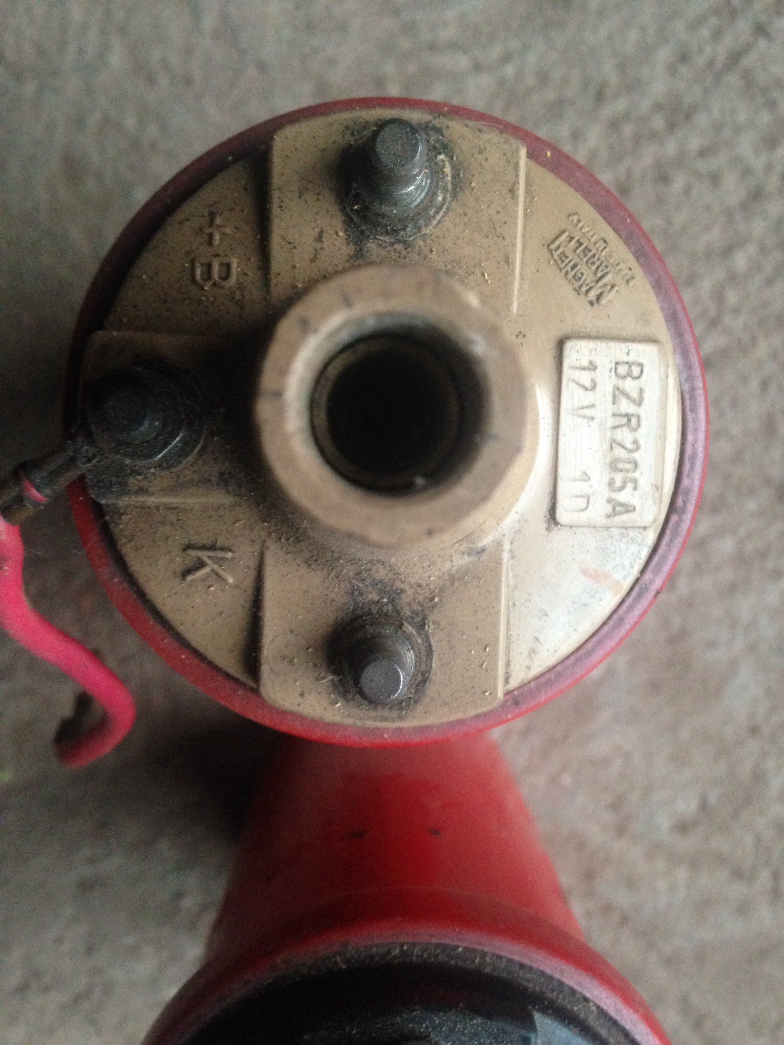

The three point coil is for a large dinoplex. BZR205A.

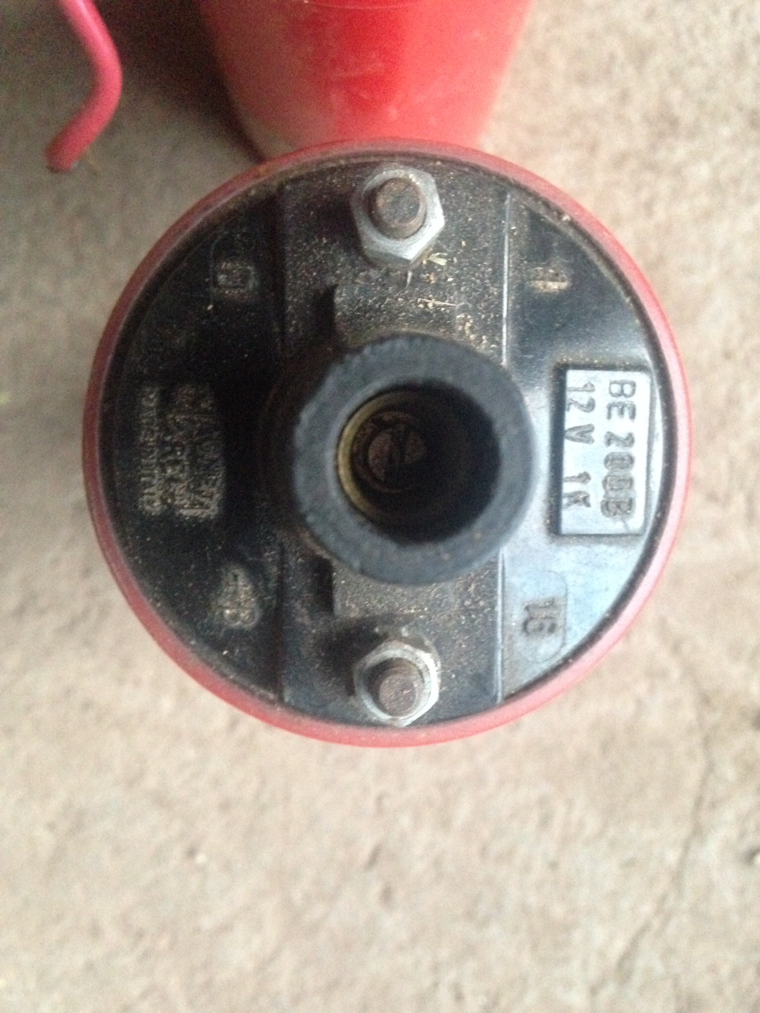

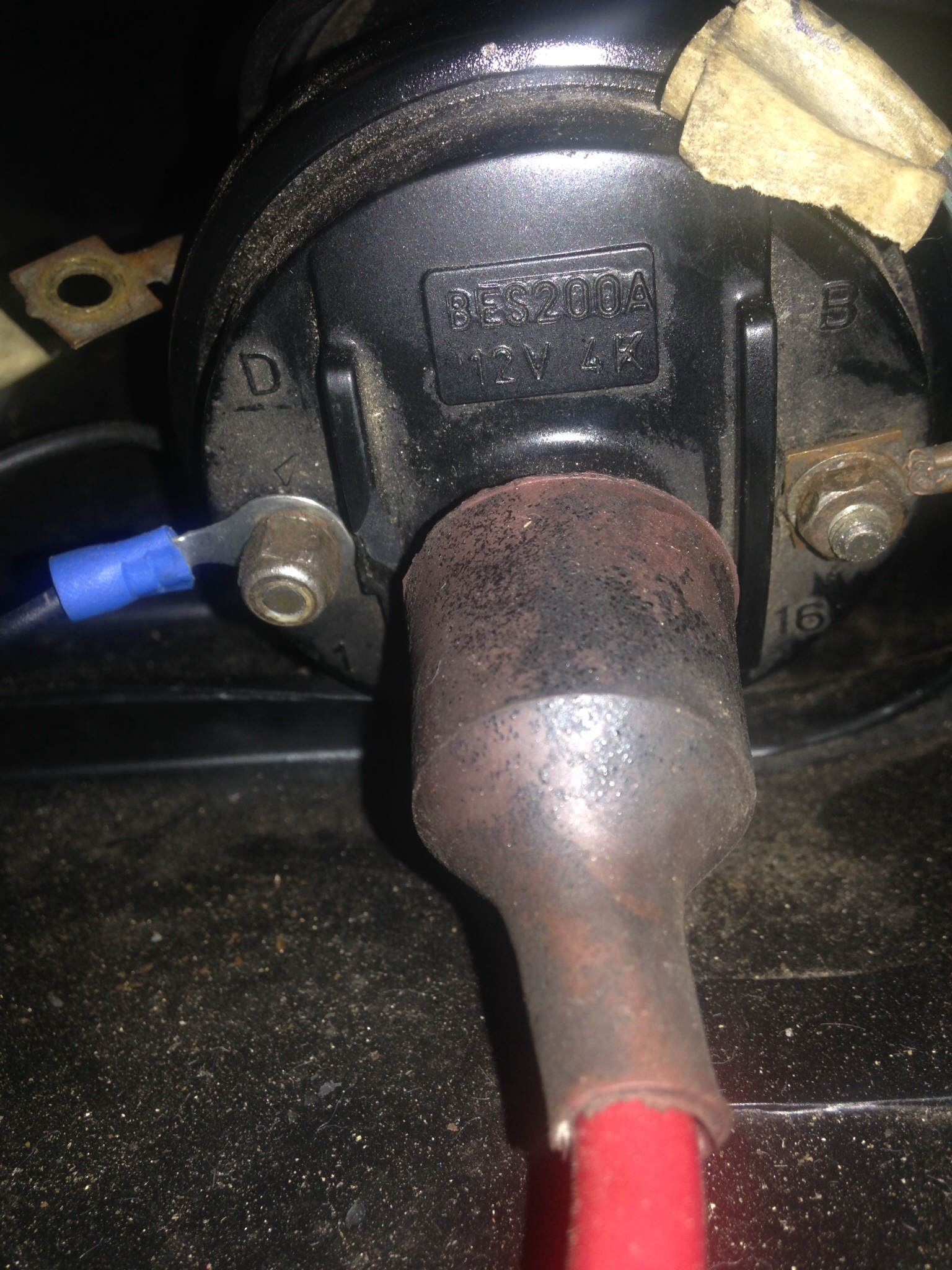

The other ones are BES200A. With letters D and +B and 1 and 16 on it.
And a BE200B. With the same letters and numbers on it.

The BZR205A is coil is quite rare, take good care of it! A good replacement for the AEC103A main coil is a MSD Blaster 2 coil (#8200 or #8202).
BE200B is a classic coil for Fiats and should work nicely as a emergenzia coil, i dont ' have any infos about the BES200A unfortunately.
1, D = Minus/Points side (blue wire)
16, B+ = Battery plus side (yellow wire)

Depends on the condition, a very good one can sell for $500 or more, standard condition but working ones are above $300 by now. They are quite rare and are the only coils working with a Dinoplex C AEC101 (except the BAE202, which is also quite rare).
It's not only about the Daytona (US Daytonas only, EU Daytonas had a simple points based ignition) but with the current prices for original early 246 GTs and Fiat Dinos, these coils are much more in demand.
