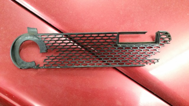

Today a set came in from a good manufacturer. I'm quite happy with the result. Looks pretty much identical to the original one.
Only thing is I have to coat it in a slightly more cream white color but other than that it looks and fits great.
You did a great job, bravo!
As for the color you can always paint them ...
I'm doing design rear passenger side grids.
I too would make them realize, as you did, in plastic or aluminum.
When I prepared something I will certainly post ....
Hope you will succeed your side grids as well, if you run into problems just let me know.
If you have difficulties you could also send it over to me and I could make some time to reproduce them as well. Most difficult thing in the process is to find out where to have them manufactured qualitywise, what 3d printing process should be used for what, what coating will be needed etc.etc. I think I have this sorted out by now.
This company that manufactured these grids will be able from next week on to print in color with this specific process, with this process it's normally quite difficult to have parts printed in a specific color.
I do not think to realize the side racks with a traditional 3D printing (hot wire).
I have already identified some companies that print 3D fusing powder material, even metal.
I'm waiting to have the file to request an estimate of the work.
I would still oriented, given the presence of the lamp housing that had already damaged the previous grid, to make it realize aluminum (money permitting).

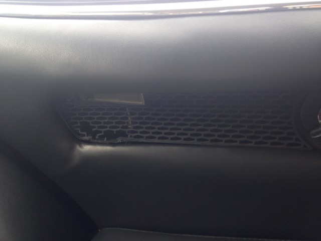

If you make rear passenger side grids (I assume you mean the ones with the lights at each side of the rear passenger compartment as per the image) I would be keen to buy some.

As mentioned by patrizio, the air vents are equipped with membrames in order to prevent exhaust fumes getting into the car during deceleration! So it is really worth getting the system working properly! (Perhaps you might get these vents into shape by carefully heating them up with a powerfull hot air blower from Bosch or if don't have that tool you might try with a powerfull hair dryer! If that doesn't work, I would certainly go for that newly produced vent!

I think patrizio is still working on those. It's quite time and labour intensive to have this kind of stuff remanufactured so we just have to wait a while to let him finish it. If it won't work out one way or another I will take some time to have them remanufactured as well. Only thing is I don't want is to tear down my own car with all the grids in good shape to reproduce parts so than I must trace one of a donor car.
Last week I ordered some 3d printed parts in black, they will arrive soon so I'm curious to see how it looks and if it would be good for reproducing black parts.
