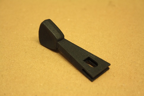

About getting brittle and strength, only time will tell, I made these black choke/heater handles and tried to do a destructive test on them to check the strength.... I stopped applying more force at the point where I thought I would twist the whole steel arm it's clamped on.
