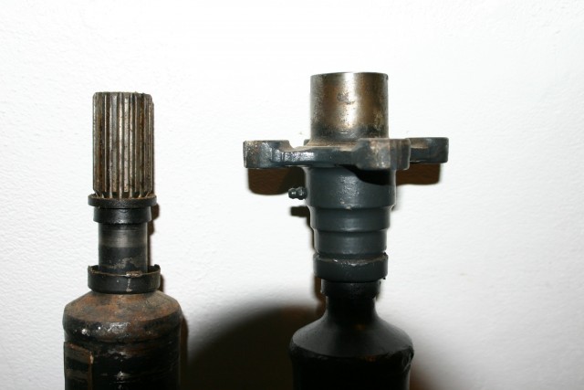

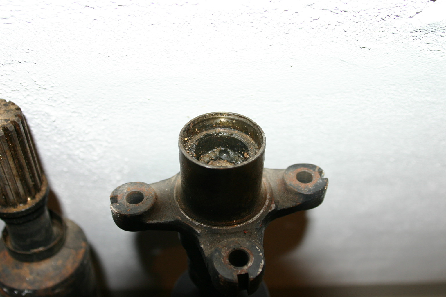

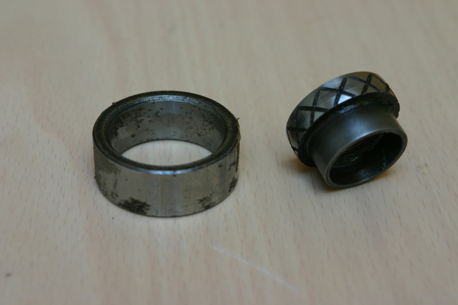

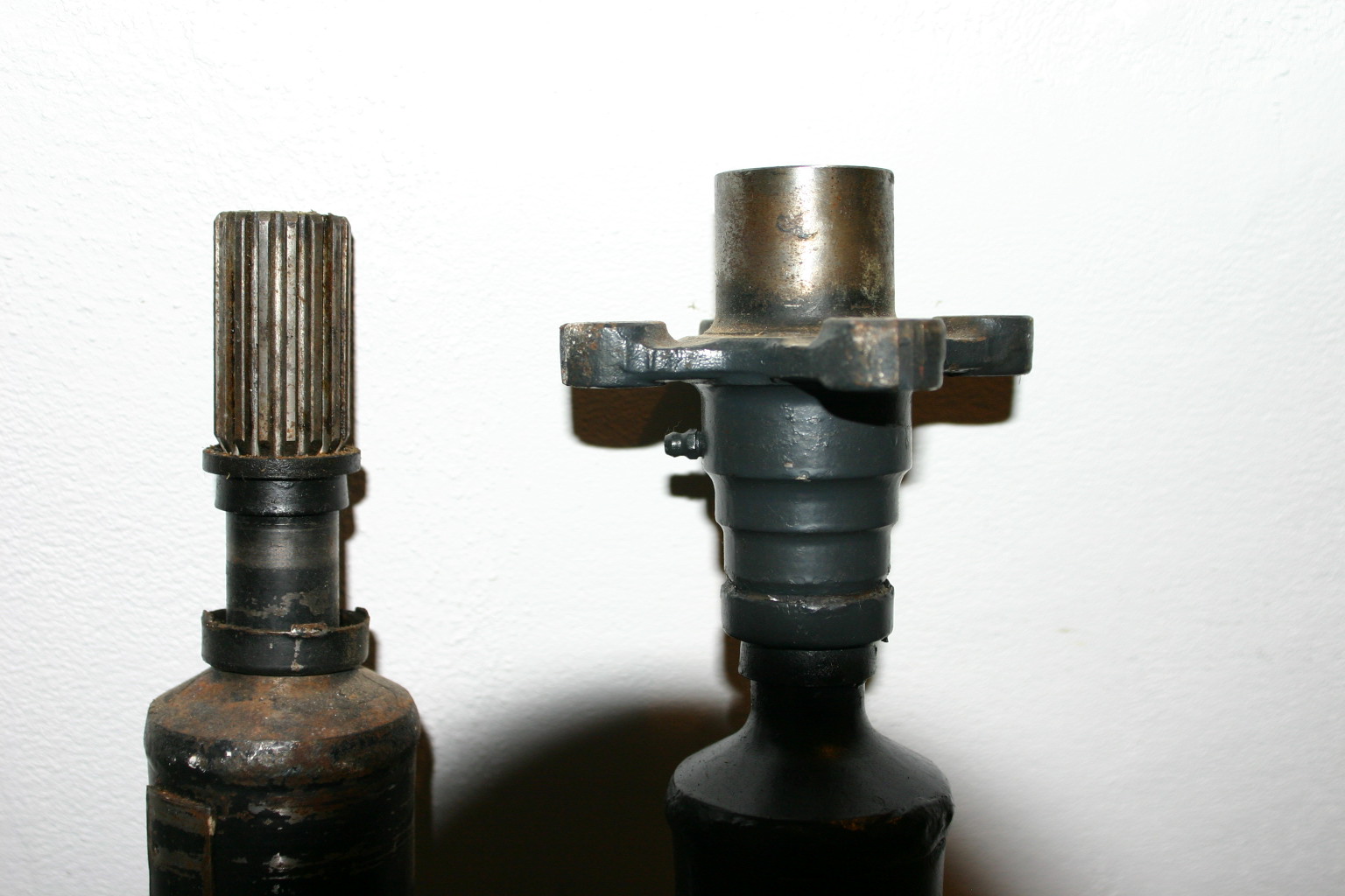

I have experienced this problem several years ago with my FIAT Dino 2400 Coupé and after a long search the solution was found in several details at the propeller shaft.
At the inner side of the propeller’s casted front end (where the hardy disk is Catalogue B3.01) is a steel bush which embraces / connects with a spherically formed ring on the primary gearbox shaft’s end (Fiat part no. 421 7547 on page B2.04 of the parts catalogue). This ring centres the propeller shaft with the gearbox’ primary shaft. An often neglected maintenance detail is regularly greasing / lubricating the propeller shaft’s front. There is a small greasing nipple. If you do not grease here over time the bush and the sliding front end of the shaft run dry and wear out. Remove the propeller shaft from the car and feel with your fingertip if the surface of the bush is still straight or already eroded. A millimetre of erosion leads to a propeller shaft that turns out of the centre and causes vibrations. Push, pull and twist the front end on the main body of the propeller shaft. Again, no grease here causes wear of the shaft’s indenting. My car had these vibrations at km/h 80-90. If to be replaced the bush must be reproduced on a turning centre as you will probably not find it as an individual spare part. It must be hardened. If the denting has tolerance it is hard to repair. Years back when I was engaged with this problem I was happy to find a spare part at GKN, and they also welded the part on the shaft. Perhaps you consult with GKN?
It is indispensible that you have the complete propeller shaft rebalanced in one peace. The specialist doing this work must have a machine that can balance on 3 “levels”. Only balancing the main propeller shaft 4639525 without being connected to the smaller shaft 4201181 (catalogue page B3.16) is useless and wasted money. Make sure that the ball bearing 28042330 in the rear tube is good.
The front end of the propeller shaft is connected to the gear box with the hardy disk. Make sure that all 8 screws and nuts are the same. Different size and length leads to a few grams difference and can cause vibrations.
All this helped to eliminate the vibrations at my Dino.

Fotos of bush and spherical ring, indenting and casted shaft's front end and position of bush in casted front end

Hello Georg.
Thanks for your reply - that's very interesting information. I should have thought about this area earlier, because Alfa Romeos have the exact same problem. A spherical centering "olive" on the end of gthe gearbox output shaft, and a small circular bush in the nose of the propshaft. It's quite easy to replace the one in the propshaft - and requires a full gearbox rebuild to replace the olive.
On my Dino I never felt inside the nose of the propshaft as you suggest - I should have!. I just filled it with grease and pushed it back on. So I will look at that as soon as possible and replace somehow if it's loose. I really hope the olive is good...
The push/pull part you mention (splined area I think you're referring to) is in good shape as far as I could tell.
Balancing as a whole - yes I certainly didn't do that - only the main external black section. The piece inside the torque-tube seemed like it was so well constrained between two bearings (and is short) that it couldn't produce this high amplitude vibration - but - you're right,I must try to find someone who can do it as a whole. Our local brilliant propshaft balancer passed away last year, and so all that's left are the pickup truck guys...I will have to find someone to send it to.
