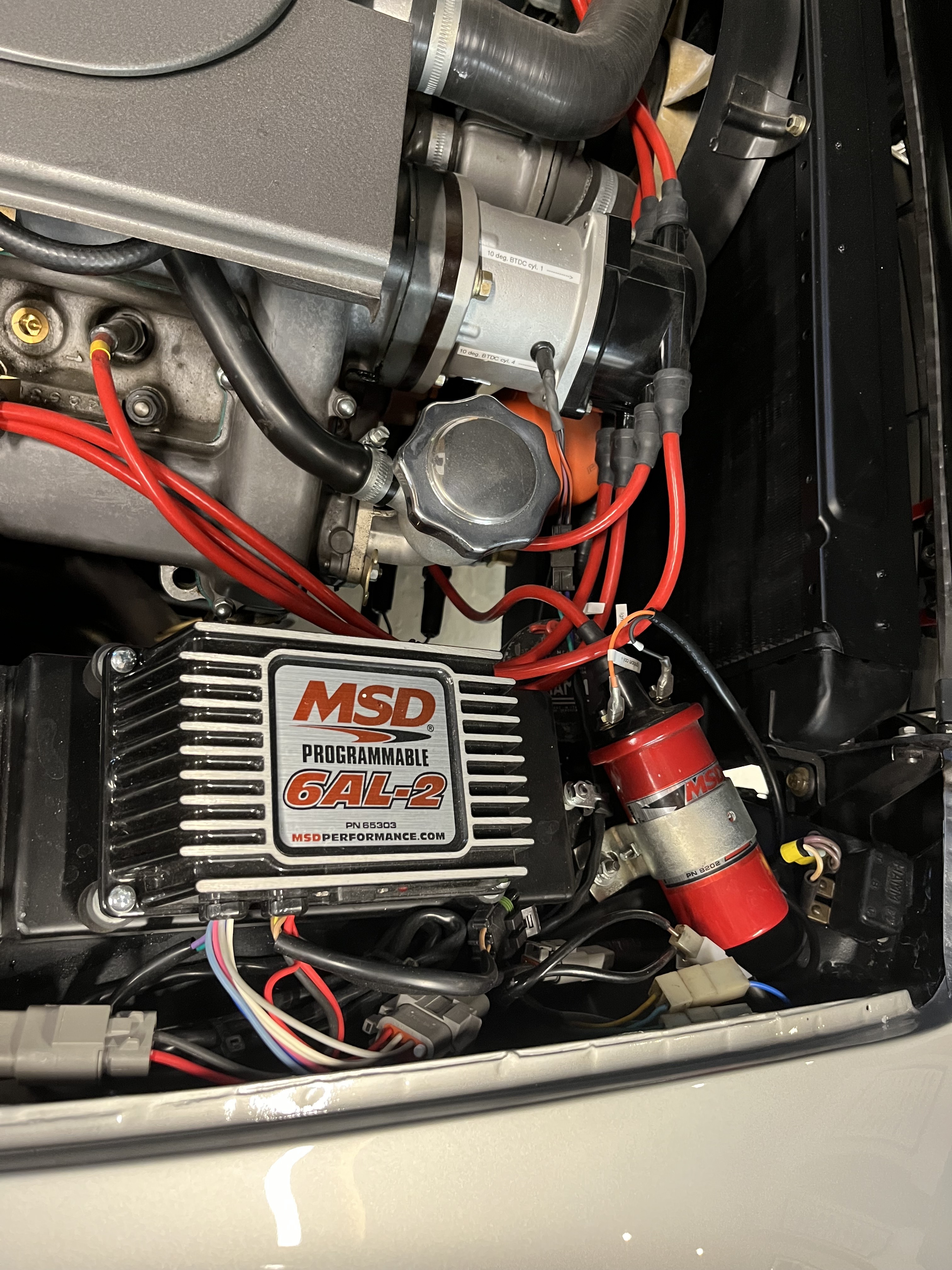

Hi, I wanted to provide an update on my Dino ignition problems and their successful resolution.
I was having all sorts of running problems, both before a full engine rebuild and afterwards. The root cause was the ignition system. My distributor was overhauled but it had not been set up on a distributor machine – finding someone with the right skills and equipment is difficult, in the UK at least. Eventually my Dinoplex packed up - for the second time, having had it overhauled once before. After researching various options, I contacted ignition guru Stefan (see earlier messages in this thread) who is based in the Netherlands. As my original coil was still working he offered to repair and restore my Dinoplex and original distributor. However, my priority for now was total reliability and driving pleasure so I opted for his complete programmable ignition system designed for the Dino. The changes are all reversable and I will one day have the original parts restored so that the car can be returned to 100% original spec in the future.
Stefan’s system consists of a fully electronic distributor with MSD inductive sensor (no bob weights or other moving parts) housed in a beautiful new reproduction distributor body. An MSD programmable 6AL2 unit replaces the Dinoplex and an MSD blaster 2 coil replaces the original Magnetti coil. These items are obviously non-original but not wildly out of place in a Dino engine bay. The internals of the 6AL2 can be hidden inside an old Dinoplex casing if you have one. I decided not to bother with that option.
Having put a few hundred miles on the car since I can say that I am absolutely delighted. For the first time ever my Dino starts reliably (hot or cold), revs smoothly through the range and pulls like a train. I wonder how many Dinos run poorly due to ignition problems? I would guess many. The system is complex, based on emerging technology back in the late 60s and the electronic components are now 50+ years old. I greatly admire the gurus on this site (we all know who they are!) who keep things original and have the skills to set up a dizzy properly and repair a 1960s capacitive discharge system. But for the rest of us mortals I recommend giving Stefan call if you have ignition issues!

Great solution as it is reversible. I'm running a Winterburn CDI in 103 housing with an MSD coil myself at the moment - but just for testing purposes :lol:
I've tested an MSD 6A once since it is a very good replacement, but it stopped running after just one day. I could never find out why.
