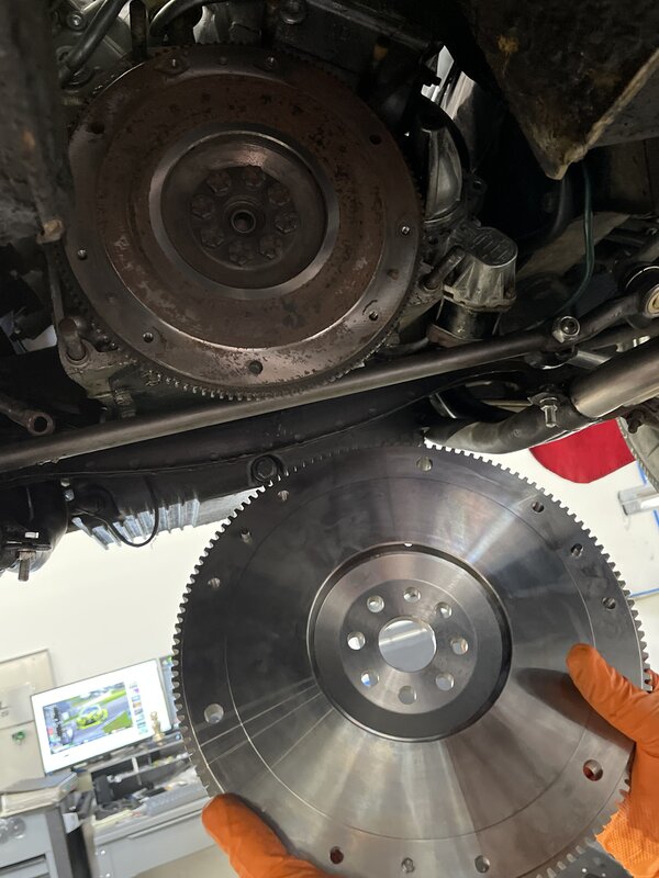

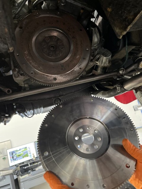

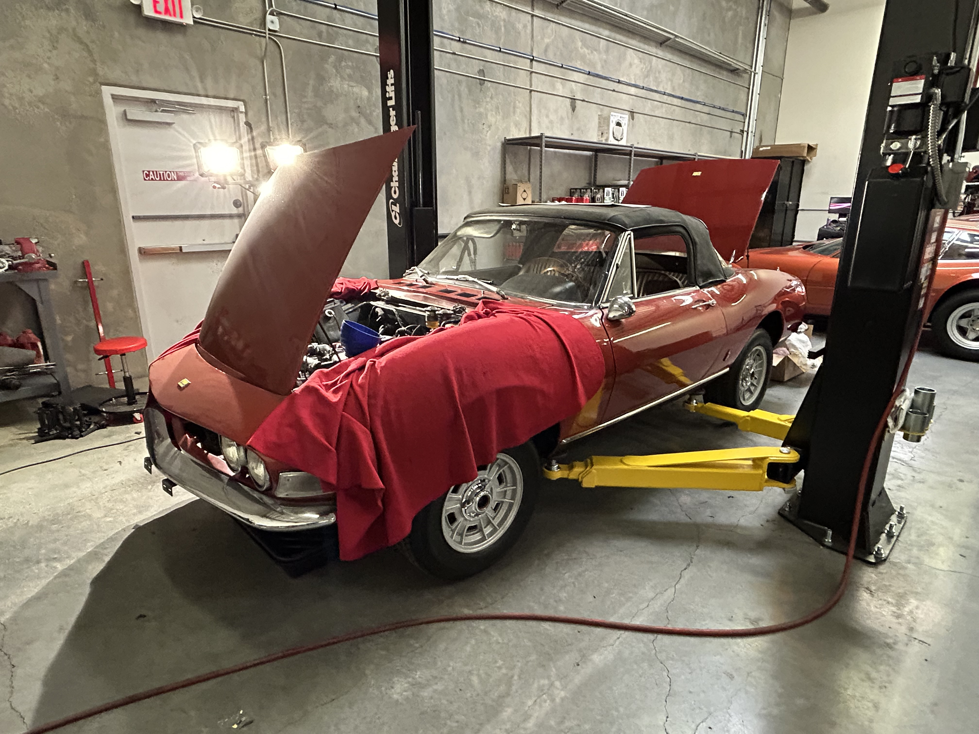

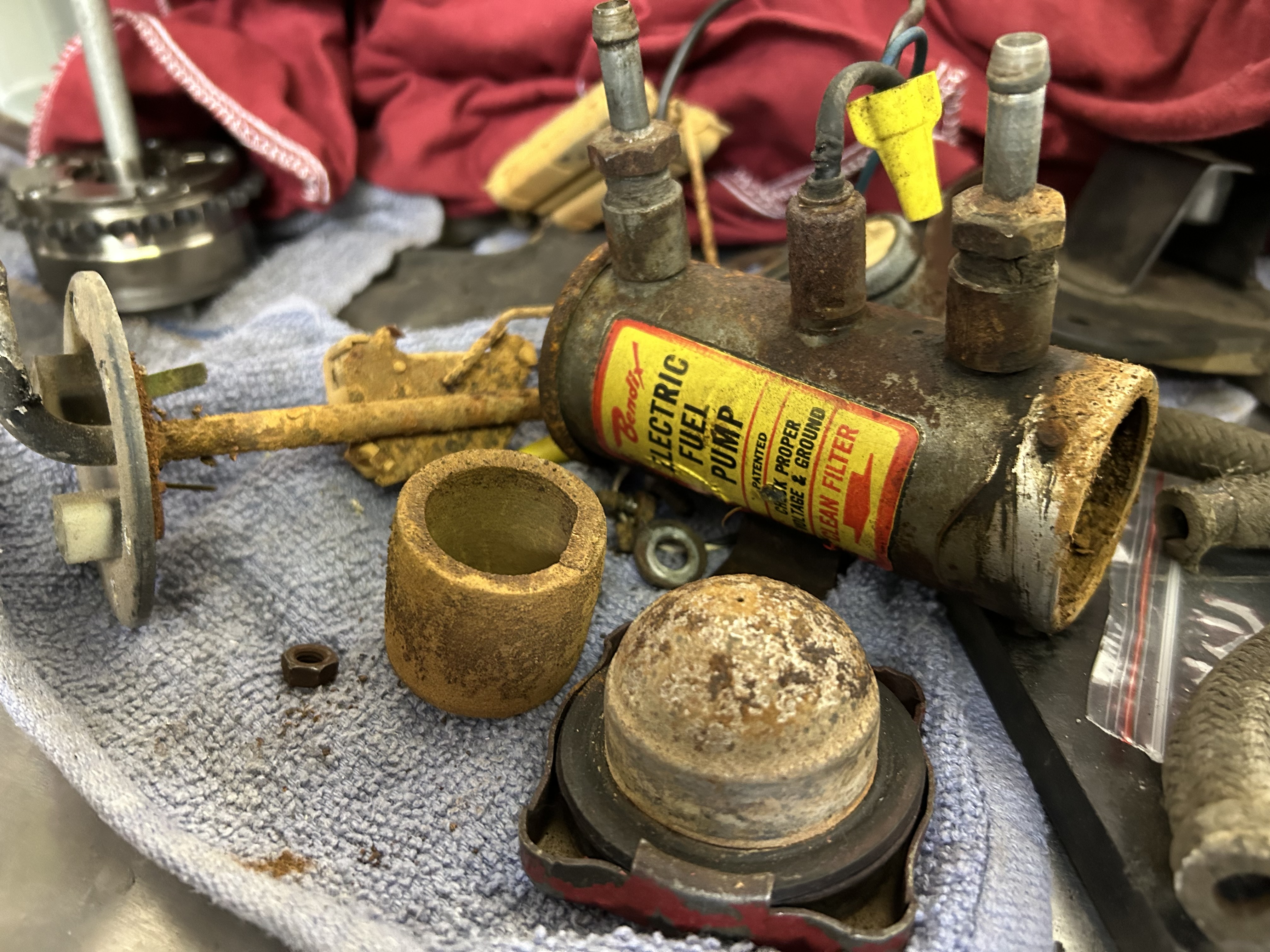

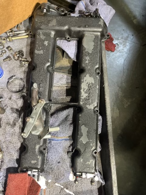

A couple of pics of the progress since Feb. It arrived non- running but we knew the clutch didn't work. Gearbox is out and new flywheel being replaced (too rusted to resurface). New complete clutch assembly (it actually was new 20 years ago) and all new hydraulics and springs going in. We are adding a new electronic distributor. This car was pre-Dinoplex. Believe it or not my 246 Dino GT still had the original working Dinoplex when I sold it -- over 30 years from when it was first installed.
The biggest issue has been cleaning the fuel tank and restoring it. In the end I may have to buy a new one. Hoping to save the original. Fuel pump, tank level sending unit shown here when they were removed and all carbs being rebuilt. The photo of the pump and sending unit give you a general idea on how long this car sat. Some of it is just TLC. The valve covers leak like crazy so we are sending them out for polishing before new gaskets are installed. Underneath the car is all looks very good. Luckily its new life in Nevada will keep it that way.
Its got most of the body and interior parts but today I received a new Front Grille from Superperformance along with some missing badges and stuff. Once we get it actually running it we can tell what problems we have in other systems. We can see the electric fan isn't hooked up for example. There are some loose wires in the steering column. So we have electrical issues to resolve. Its a big project, but worth it. Saving one poor Spider at a time from the scrap heap. She's a survivor. Time to rise and shine.
I'm sure I'll be asking questions here and there. Thanks very much for any help from other owners in advance!

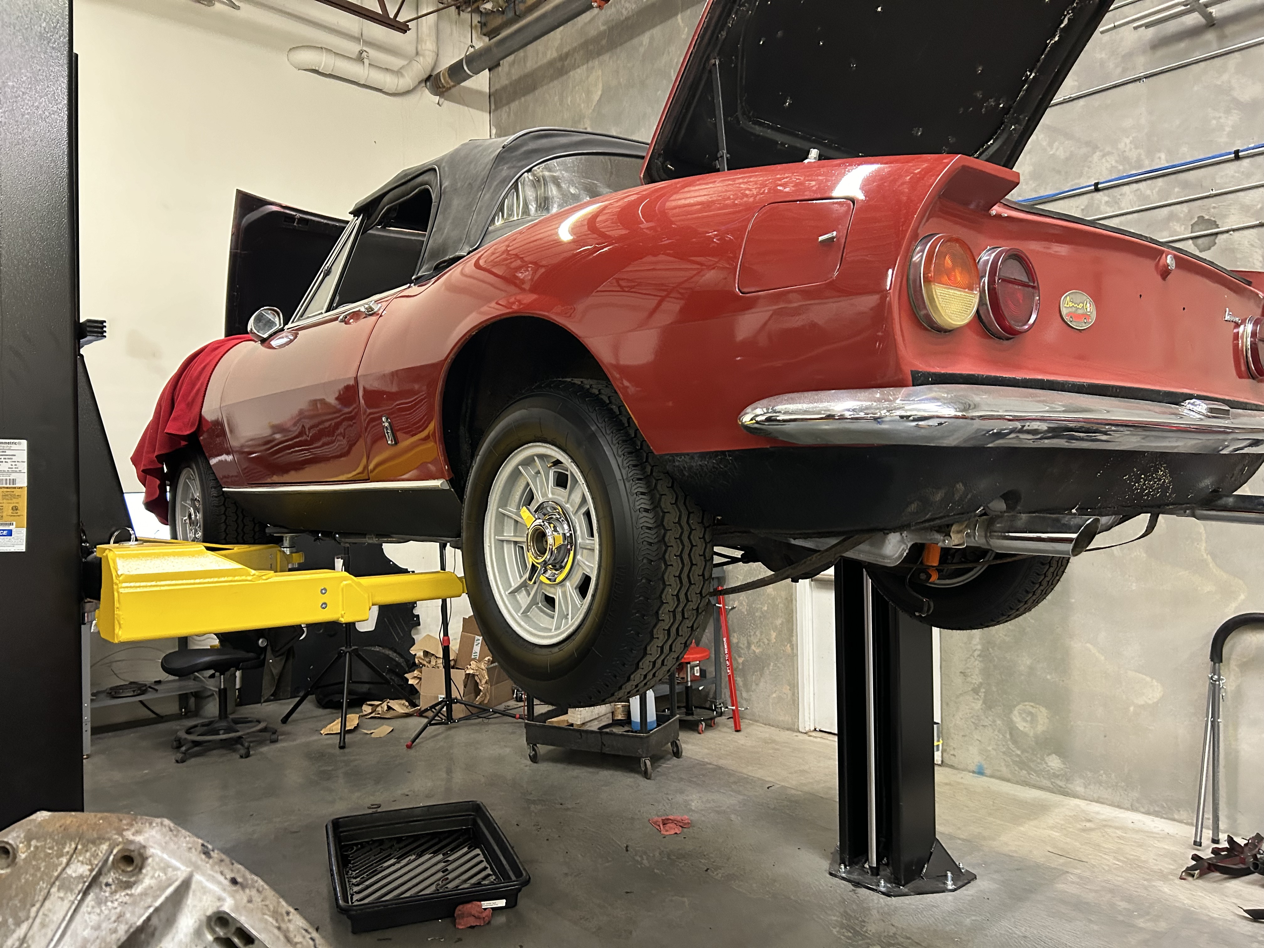

BTW the doors to open and close on the lift without a problem. The original undercoat is on most of the underside and we don't see any rust in joints we would expect to see them in. It doesn't look like it sustained any major collision damage but I am concerned the front was hit slightly at some point
We still have to strip the paint and look at what's underneath. Not sure what we'll find but for a mid 60's Fiat this one looks pretty darn good.

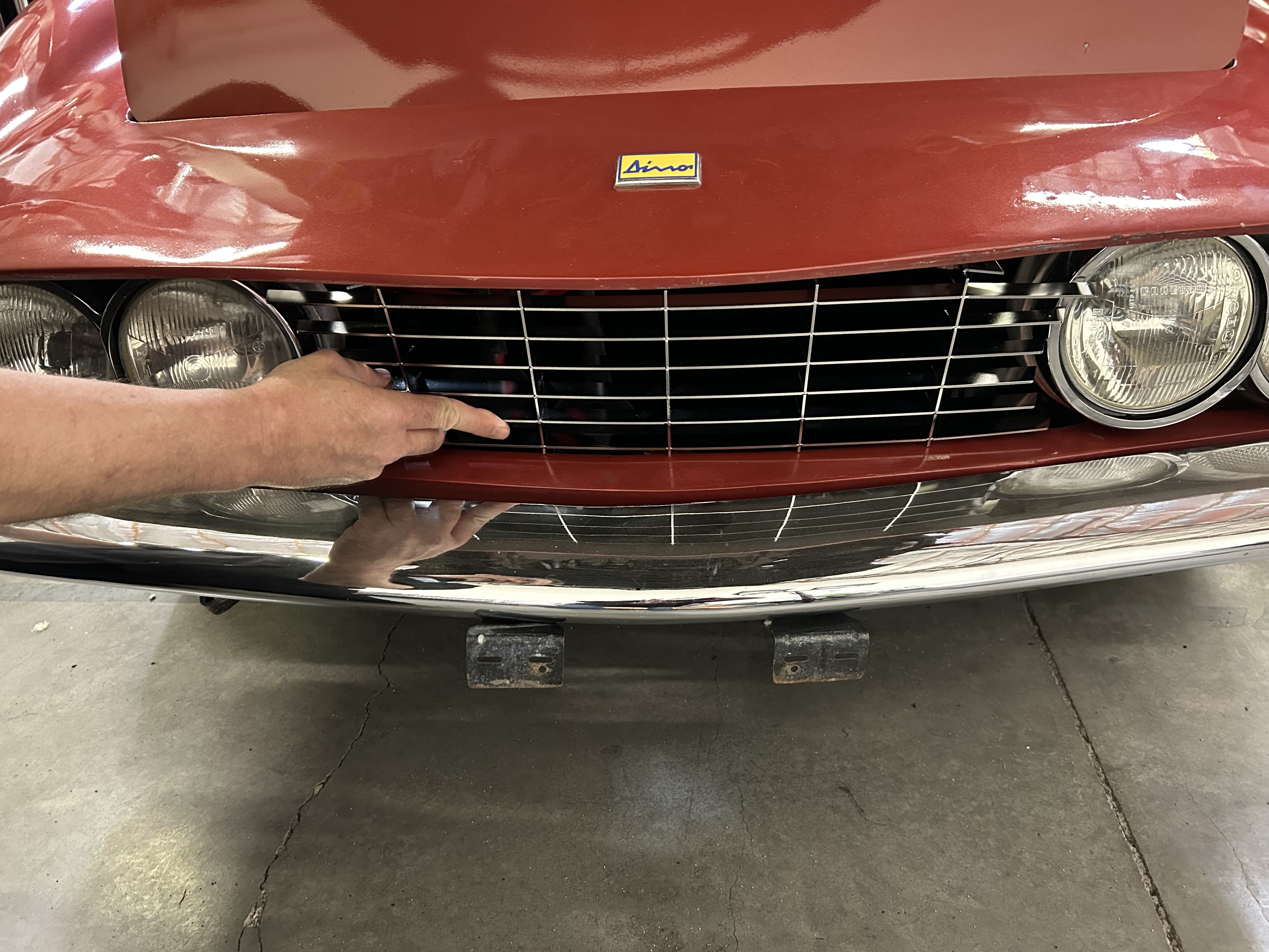

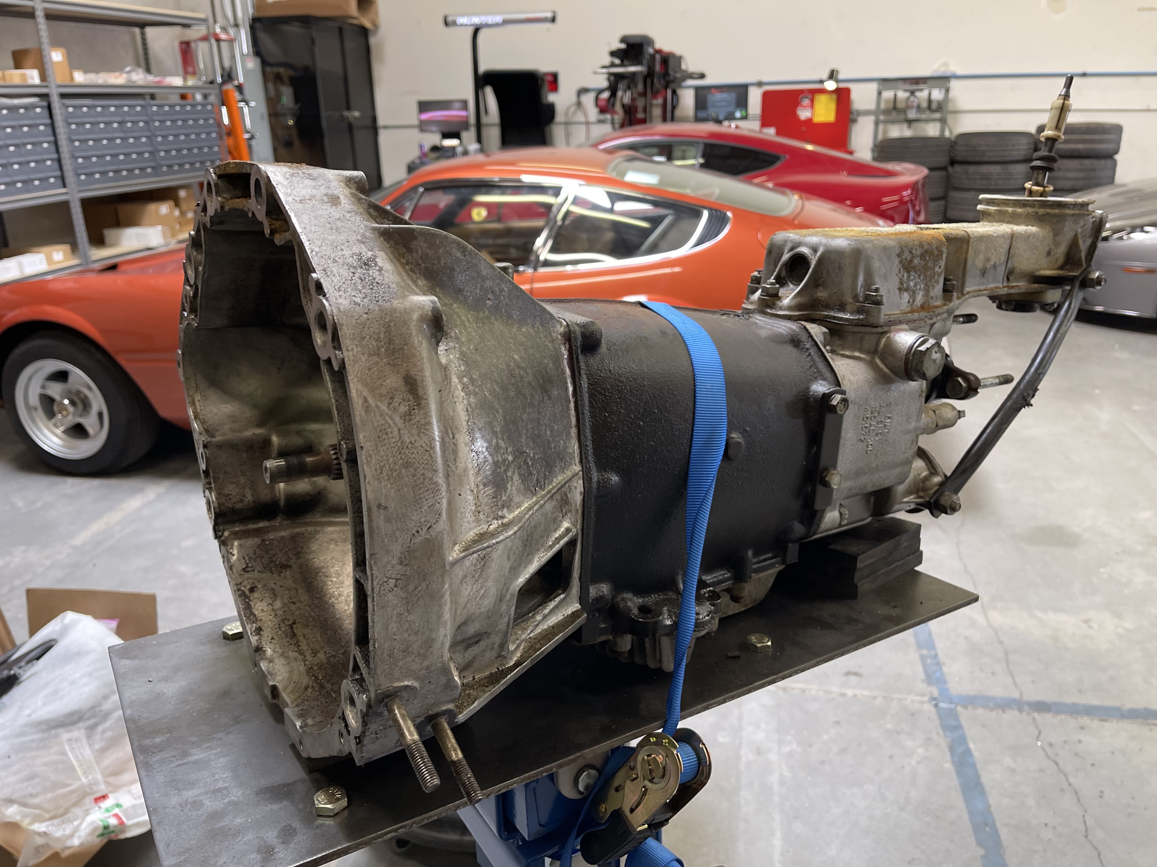

The new Front grill arrived from Superperformance UK and its excellent. Its difficult to tell from the online photo on their website but its perfect in person. I was worried about the fit and finish. We test fit it and all the mounting points line up. The flywheel, clutch, and gearbox are back in the car. We need to install the master and slave cylinder and the clutch issues should be finished. Still our biggest concern is electrical and we won't know the extent of that until we get it started. The carbs should be rebuilt this week. We still have plenty to do while waiting for the repair of the fuel tank and parts polishing.
