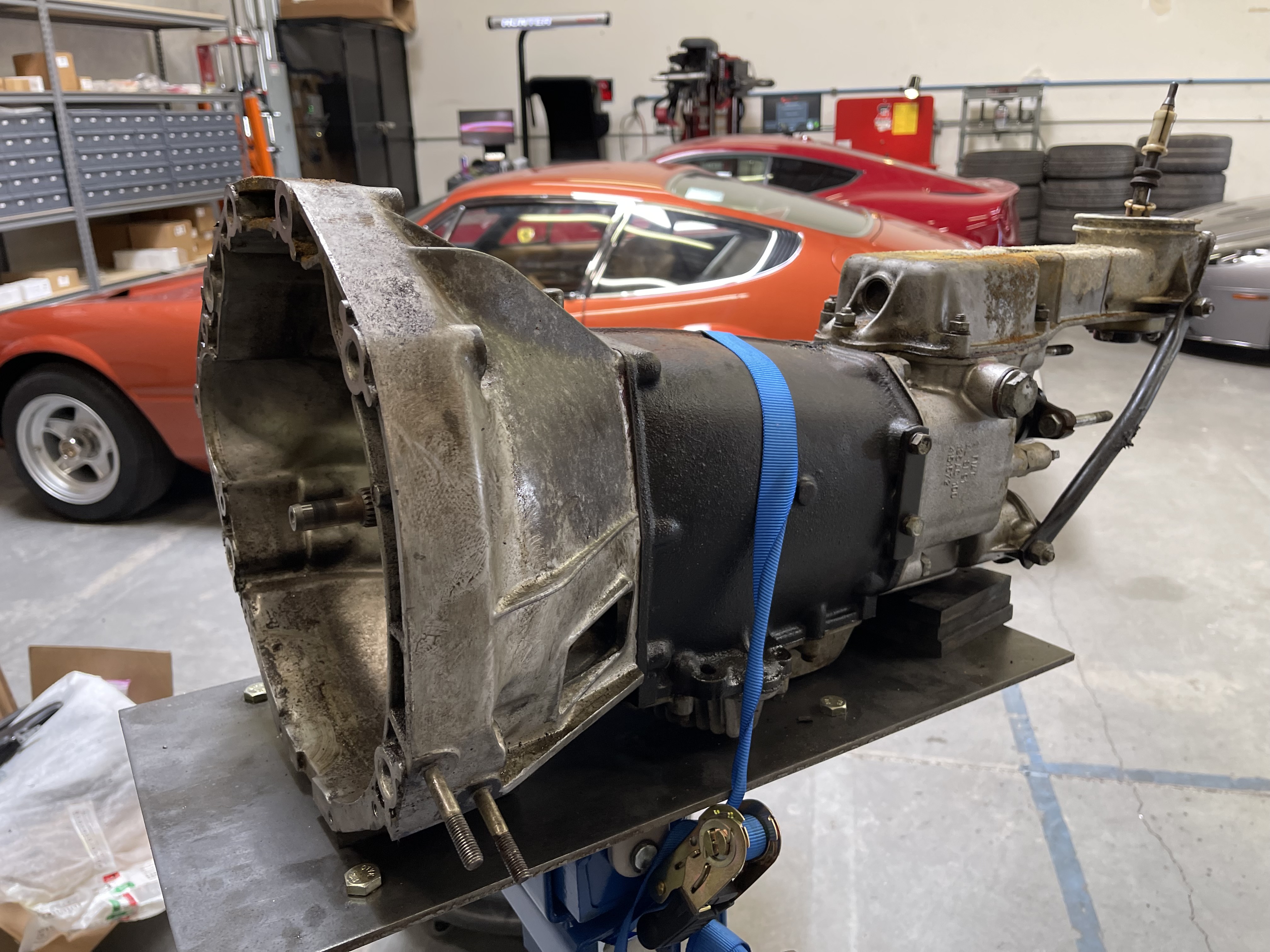

A couple of pics of the progress since Feb. It arrived non- running but we knew the clutch didn't work. Gearbox is out and new flywheel being replaced (too rusted to resurface). New complete clutch assembly (it actually was new 20 years ago) and all new hydraulics and springs going in. We are adding a new electronic distributor. This car was pre-Dinoplex. Believe it or not my 246 Dino GT still had the original working Dinoplex when I sold it -- over 30 years from when it was first installed.

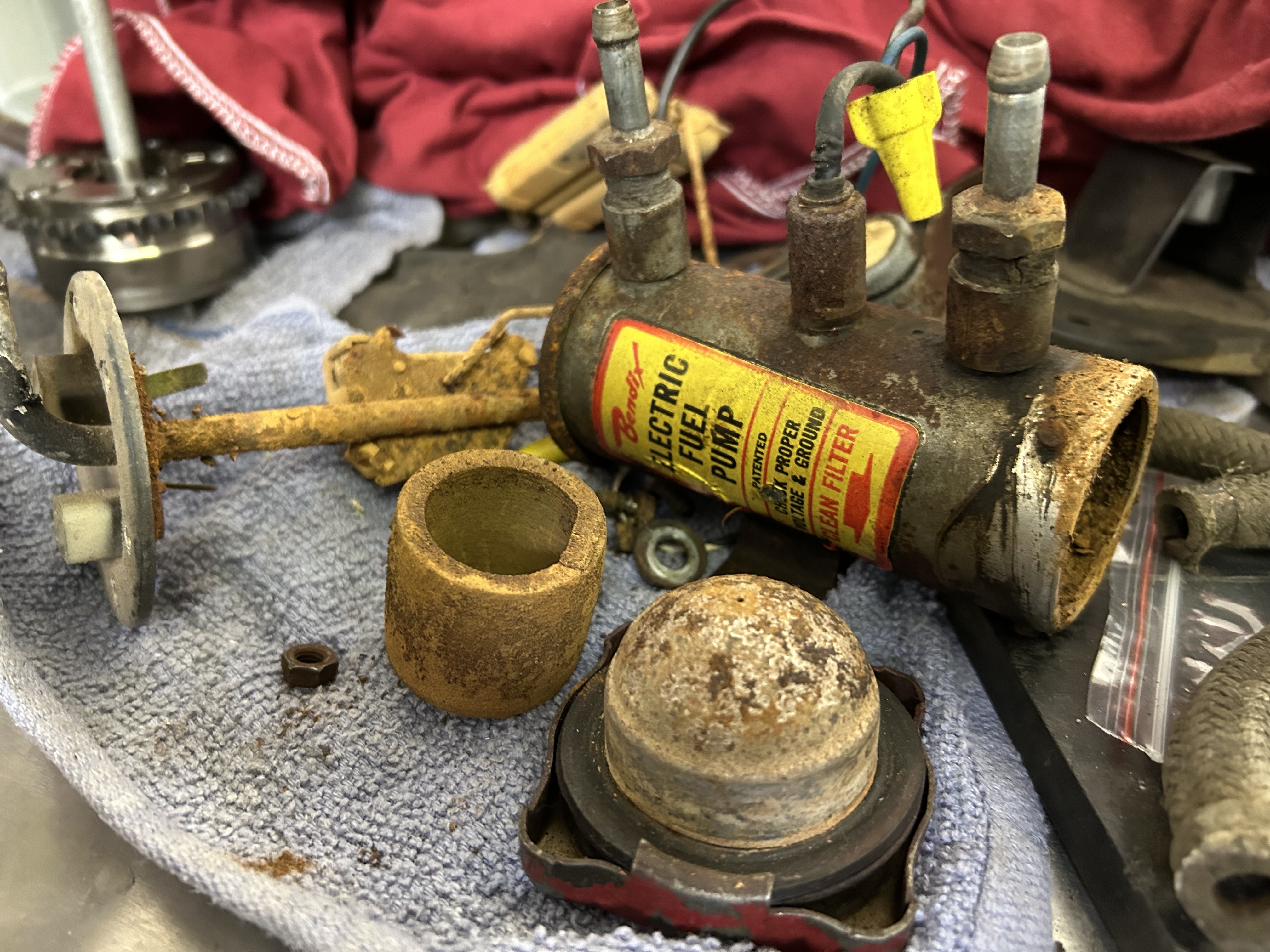

The biggest issue has been cleaning the fuel tank and restoring it. In the end I may have to buy a new one. Hoping to save the original. Fuel pump, tank level sending unit shown here when they were removed and all carbs being rebuilt. The photo of the pump and sending unit give you a general idea on how long this car sat. Some of it is just TLC. The valve covers leak like crazy so we are sending them out for polishing before new gaskets are installed. Underneath the car is all looks very good. Luckily its new life in Nevada will keep it that way.
Its got most of the body and interior parts but today I received a new Front Grille from Superperformance along with some missing badges and stuff. Once we get it actually running it we can tell what problems we have in other systems. We can see the electric fan isn't hooked up for example. There are some loose wires in the steering column. So we have electrical issues to resolve. Its a big project, but worth it. Saving one poor Spider at a time from the scrap heap. She's a survivor. Time to rise and shine.

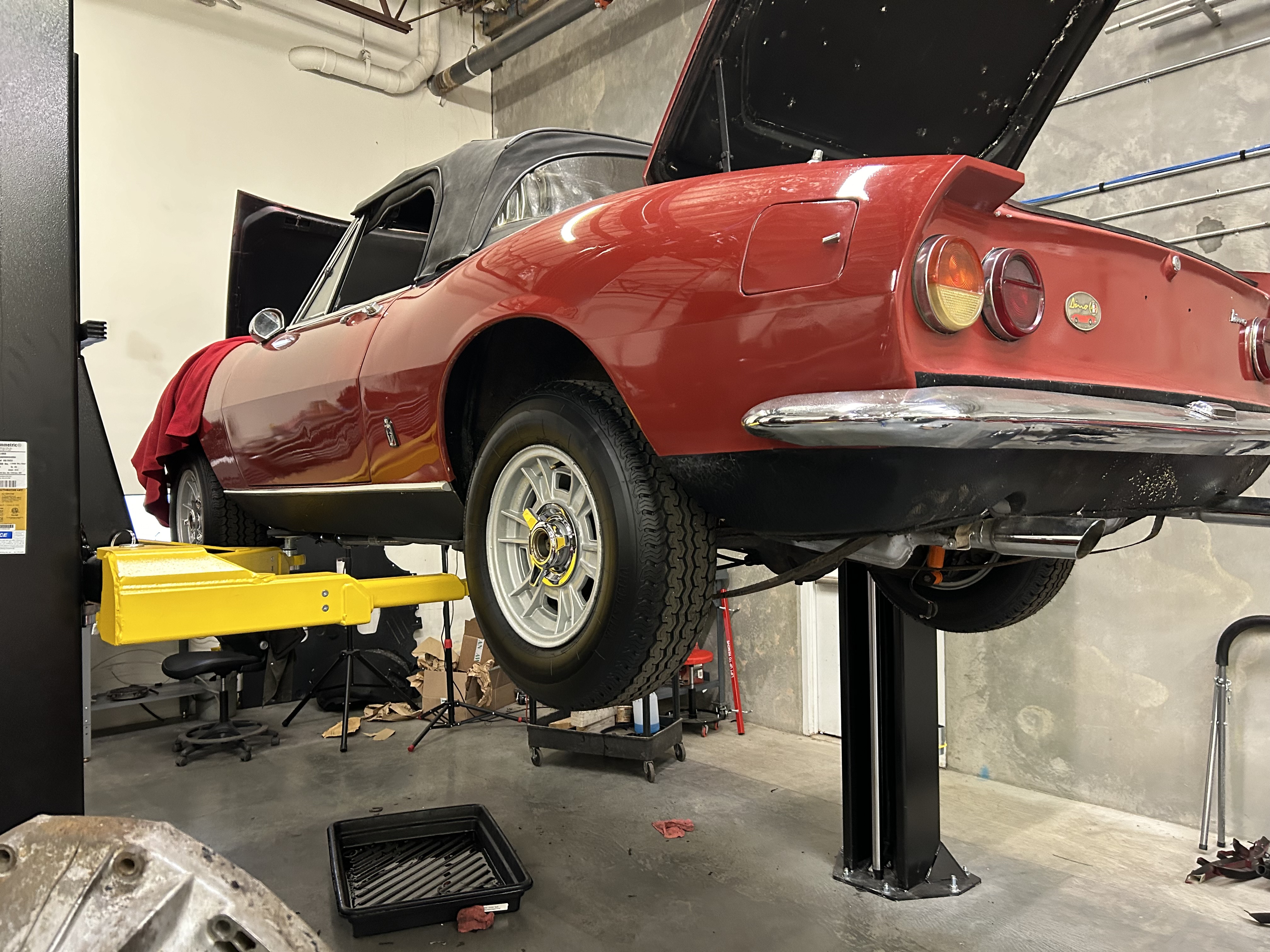

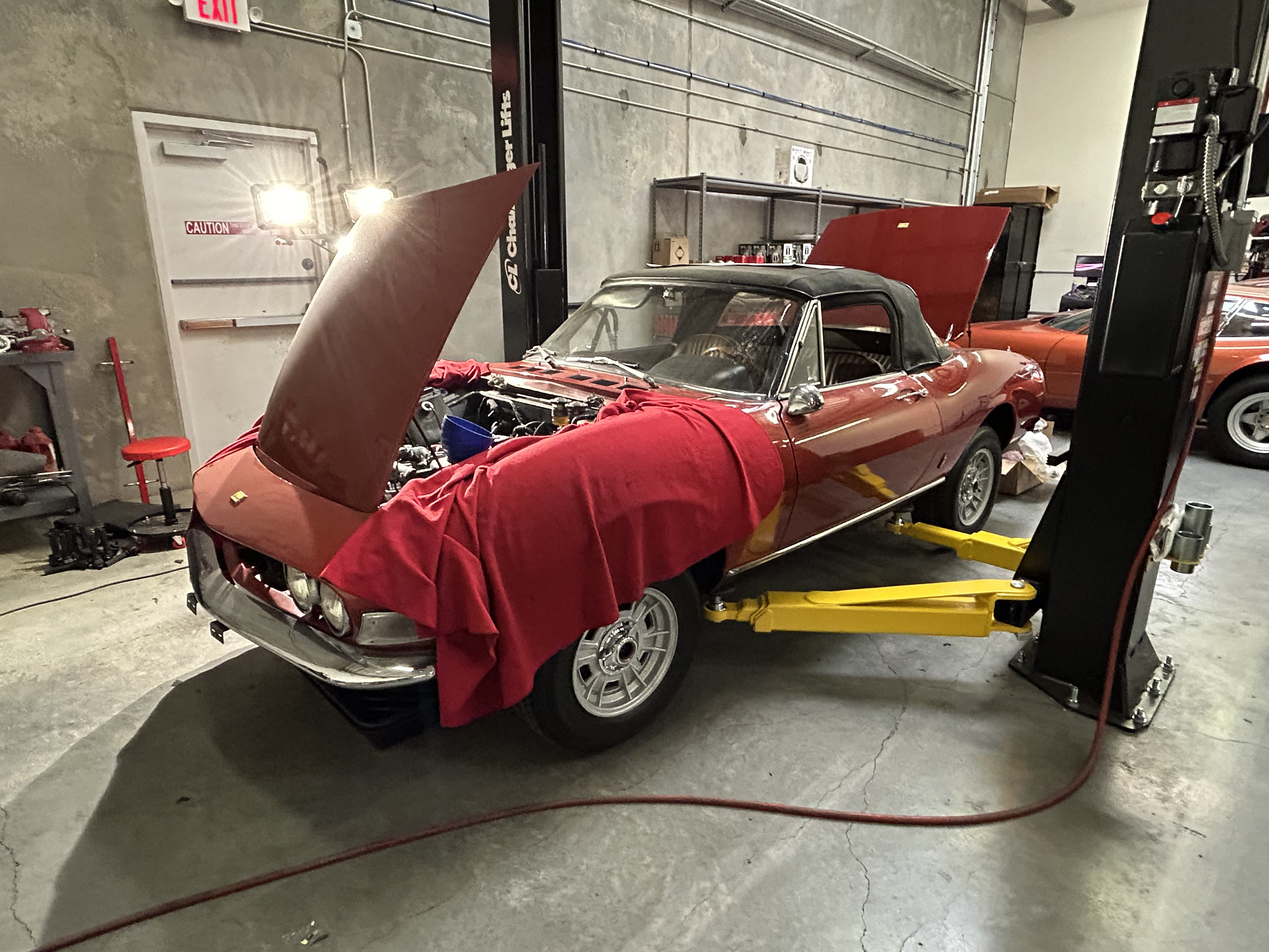

BTW the doors to open and close on the lift without a problem. The original undercoat is on most of the underside and we don't see any rust in joints we would expect to see them in. It doesn't look like it sustained any major collision damage but I am concerned the front was hit slightly at some point
We still have to strip the paint and look at what's underneath. Not sure what we'll find but for a mid 60's Fiat this one looks pretty darn good.

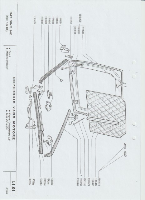

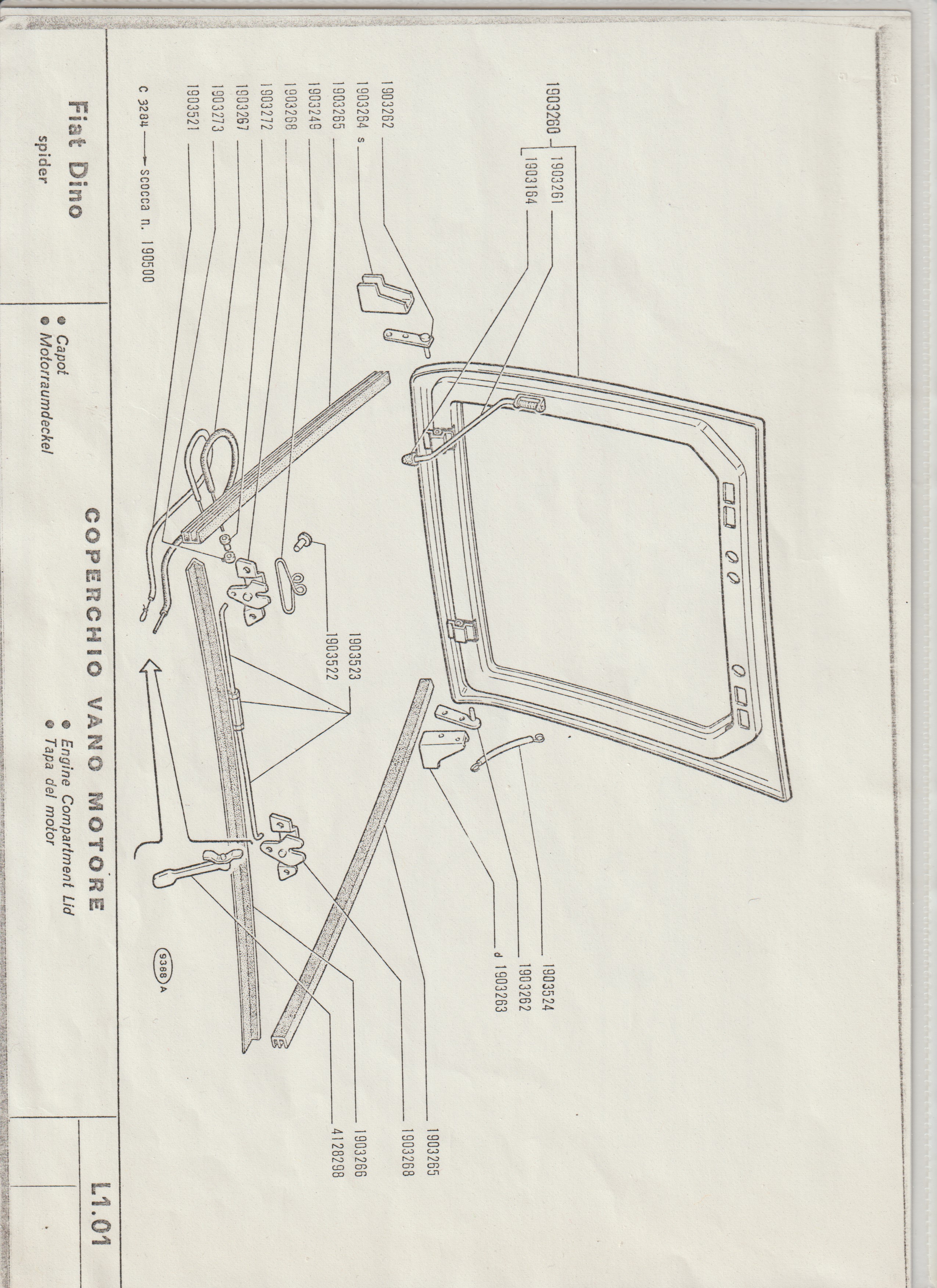

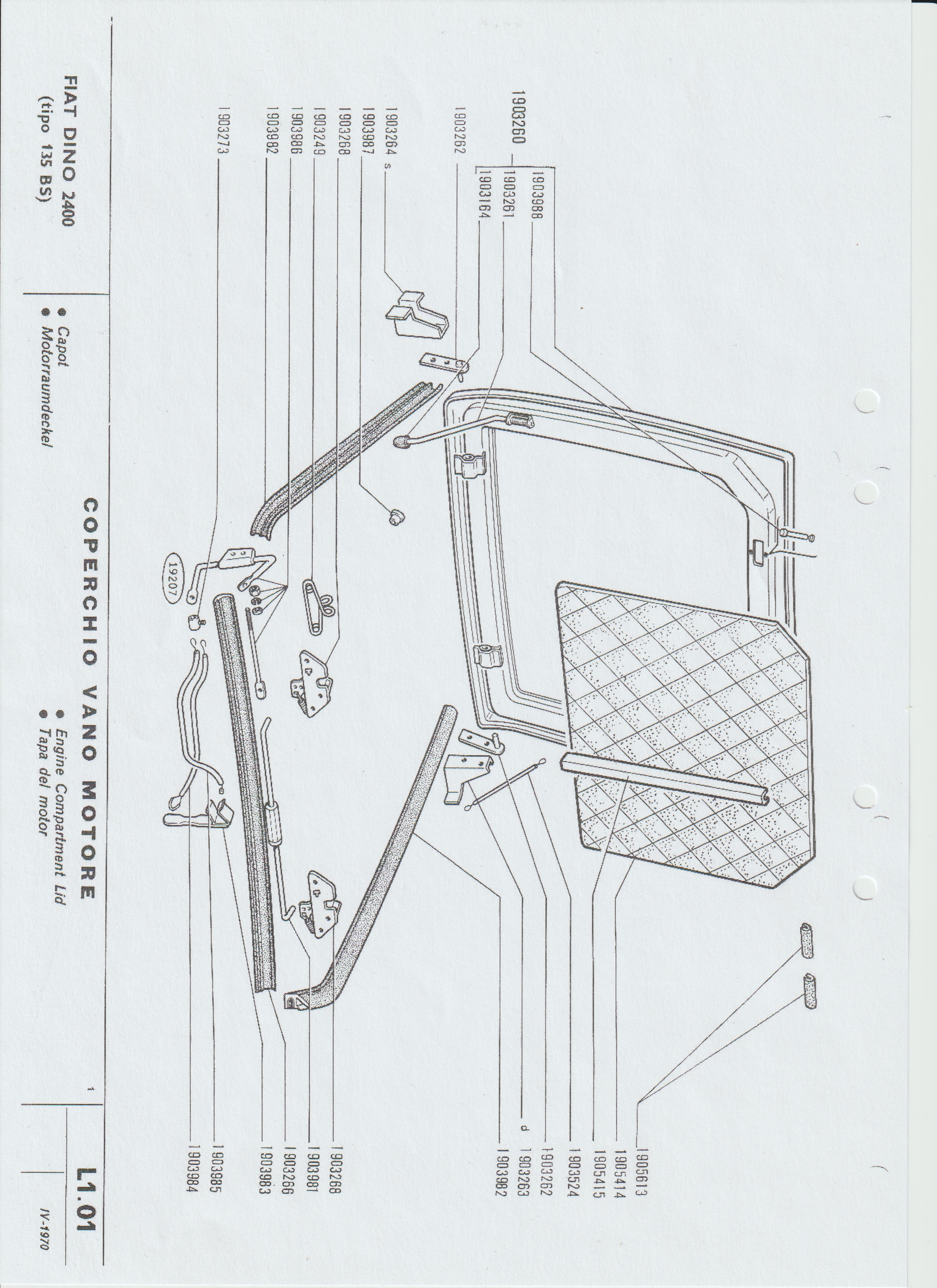

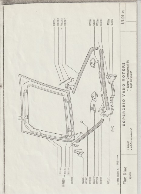

If you have a car that's just a few numbers away from mine, I have a big question. Its the padding under the hood. Did they all come with it? Is it necessary? Does it interfere with the engine noise?
I can't seen anything under my hood that would indicate there was ever a pad there. I would expect some glue or something but there's nothing. Any information would be appreciated!
ALSO, I can't seem to locate the little Pinnafarina badges that half cover the Fiat Dino side emblems. Yet it has Pinnafranna badges on the lower body by the rear similar to Alfa Spiders. Seems weird they would have 2. Any information on what is correct would be helpful.
