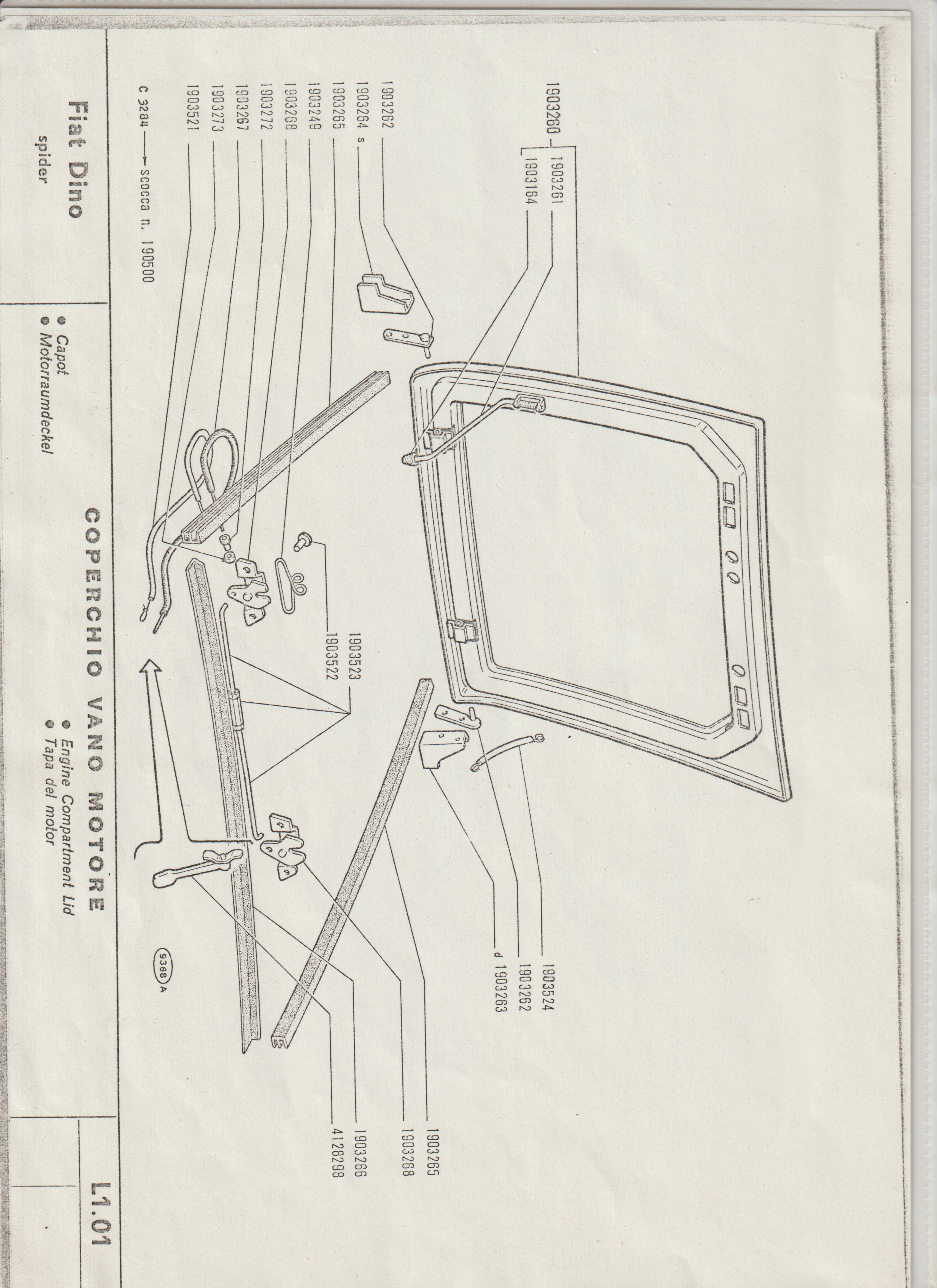

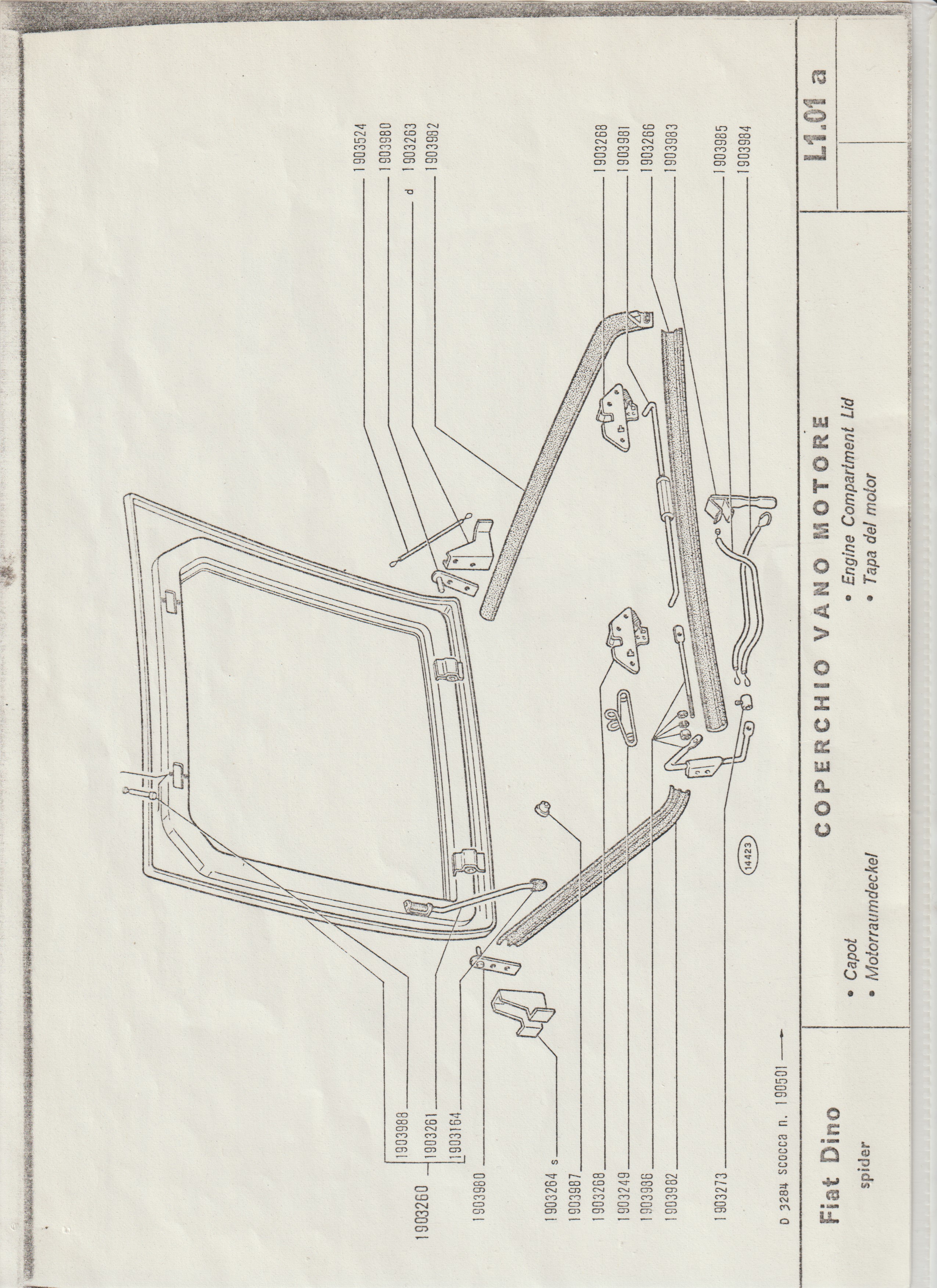

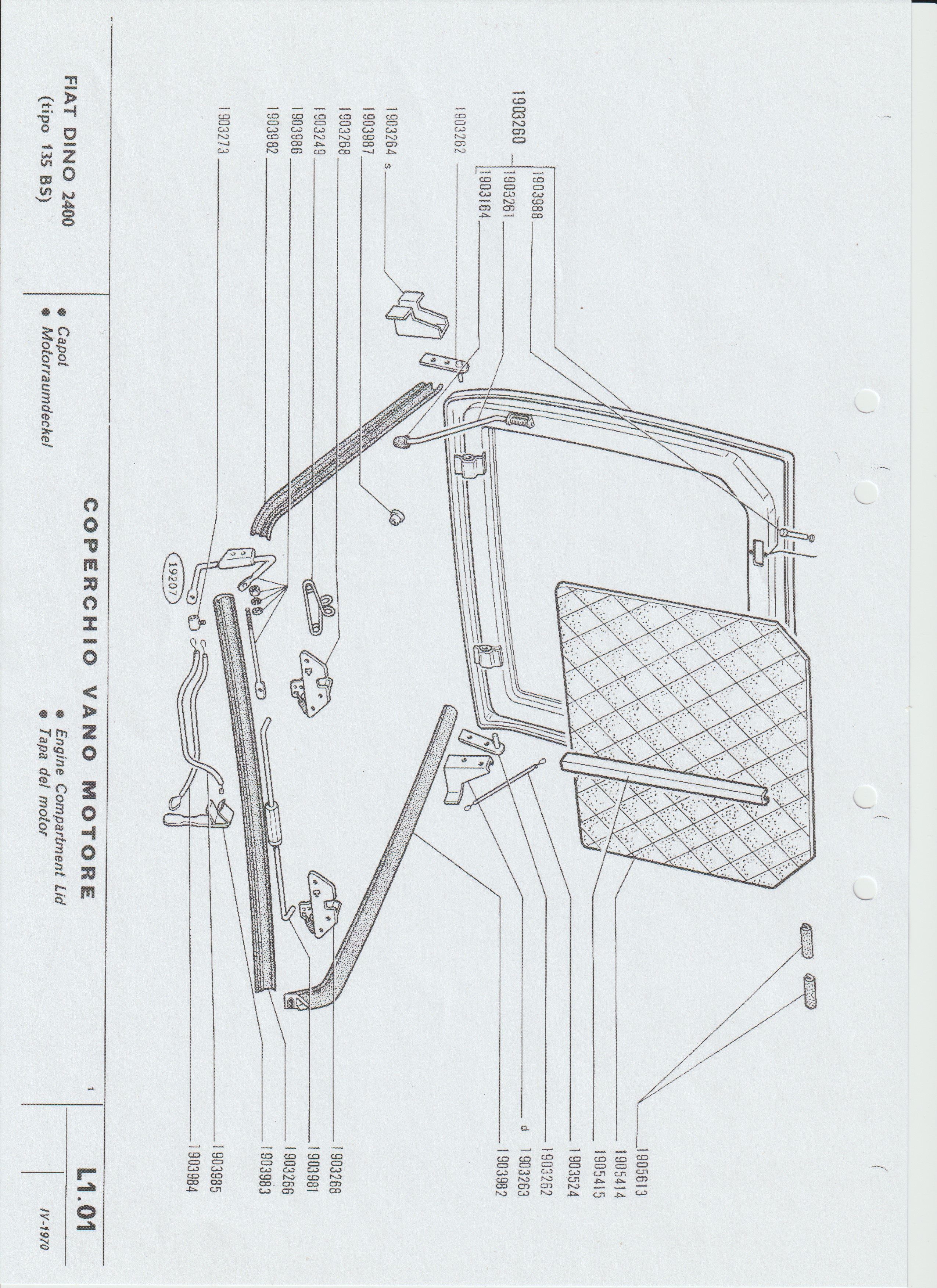

No 2 Litre Spider had any padding underneath the bonnet. It was added at the 2.4 Spiders. See the 3 spare parts Catalogue pages
below: (Sorry for the pics are not shown in correct angles!)

Wow that is awesome information! I have seen the parts book for the 2.0 and it did not show the blanket but I have never seen the 2.4 parts before. This is what I suspected but its great someone can confirm.
I wasn't worried so much about authenticity as I was technically. I worried there was an engineering purpose to the blanket.
