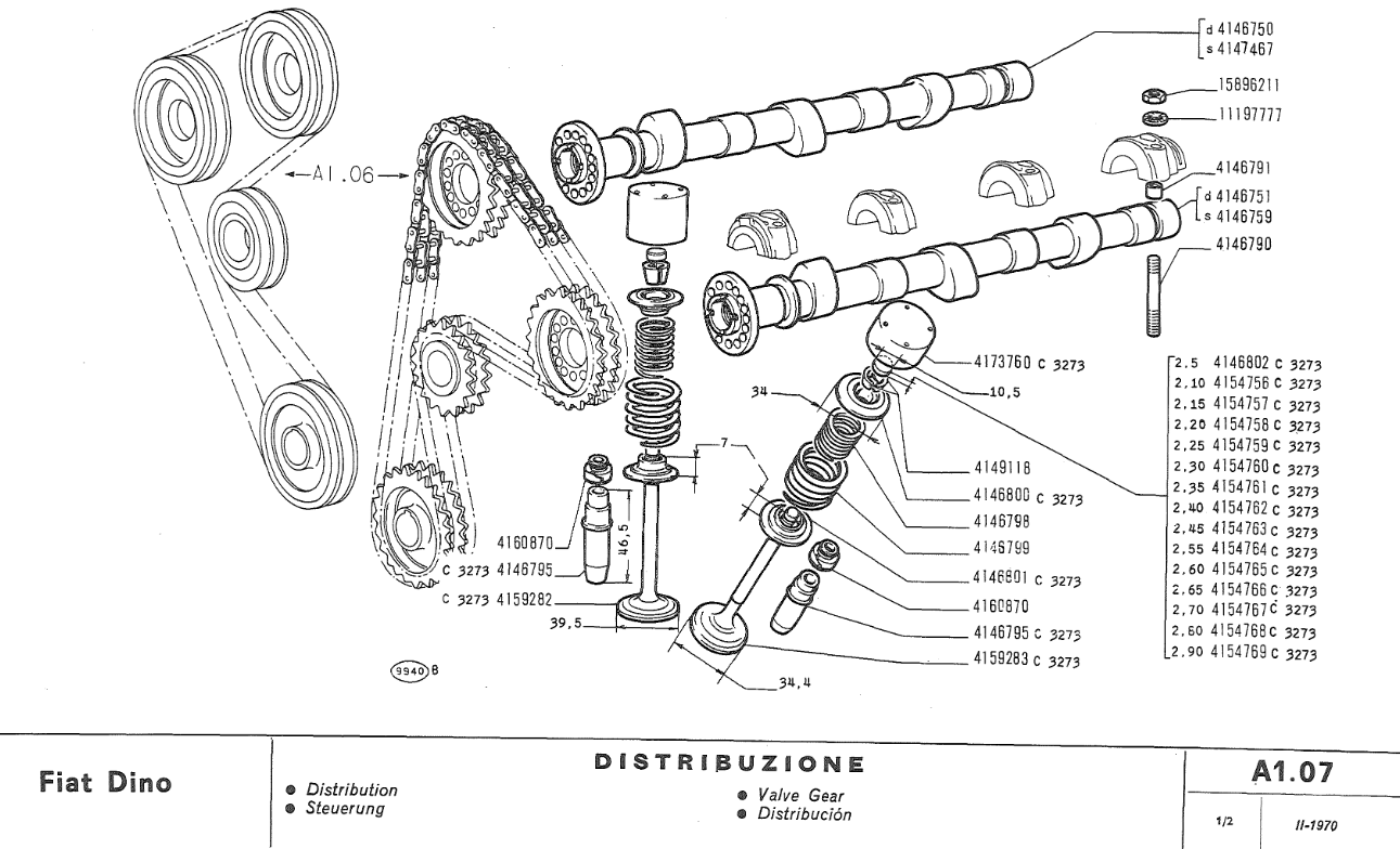

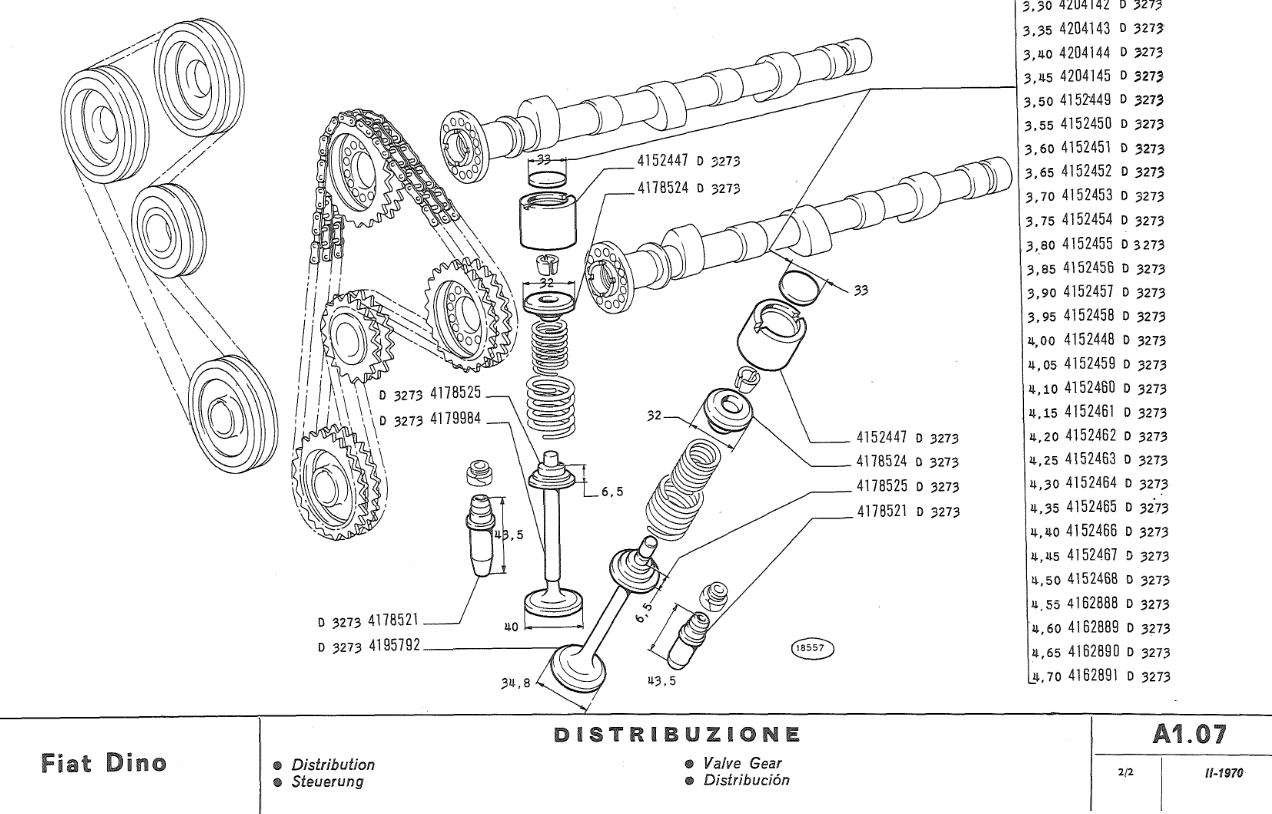

Looking at the Spare parts Catalogues you will notice that not only the valve tappets were replaced when the valve shim system was
changed, but also the actual valves.
The valves outer diameter were slightly changed, but more important, the valves total length were shortened. I have found my
old measurement notes over this:
Early type exhaust valve = 106,35 mm
Early type intake valve = 95,55 mm
Late type exhaust valve = 104,65 mm
Late type intake valve = 94,50 mm
This was made to compensate for the differences in "actual thickness" between the early and late type of the valve tappet.
You can re-use your old valves by cutting off the valve stems, but then you also have to make changes in the valve springs
locking cones positioning, which make it much more complicated. The best alternative today with new correct valves easy
availible, would be changing all the valves and valve tappets together.

Re: 2.0 cam clearance buckets
Hi Stefan. I’m curious, why did Fiat change it if the prior system was better?
Mainly for maintenance reasons as you can let the camshafts in to adjust the valve clearance. With that you also not have to adjust the timing new when it’s correct. The Dino was at that time quite complex for Fiat workshops and the later version was a bit easier to maintain and don’t overwhelm Fiat mechanics not being used at all to these kind of complex engines.
And yes, the later version wheighs more/is heavier what influences the free revving of the engine. I will also keep the earlier system on my Spider as its originally was/is.
