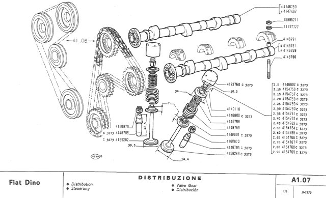

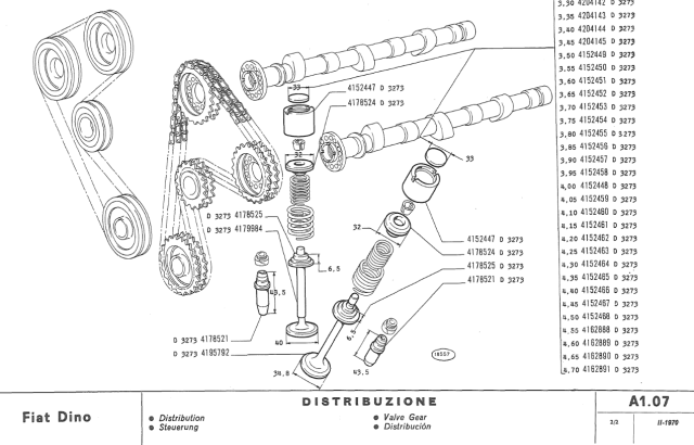

Looking at the Spare parts Catalogues you will notice that not only the valve tappets were replaced when the valve shim system was
changed, but also the actual valves.
The valves outer diameter were slightly changed, but more important, the valves total length were shortened. I have found my
old measurement notes over this:
Early type exhaust valve = 106,35 mm
Early type intake valve = 95,55 mm
Late type exhaust valve = 104,65 mm
Late type intake valve = 94,50 mm
This was made to compensate for the differences in "actual thickness" between the early and late type of the valve tappet.
You can re-use your old valves by cutting off the valve stems, but then you also have to make changes in the valve springs
locking cones positioning, which make it much more complicated. The best alternative today with new correct valves easy
availible, would be changing all the valves and valve tappets together.

I would never change it, and if, only the other way around.
The early style is much better. It is much lighter, easier on the cams, easier on the valves, harder surface than the shims, able to rev higher. Beside that it will take you 2 extra hours setting the valve clearance (which you never have to do, mines only changed 0.01mm in 15.000km) it only has advantages and no disadvantages.
