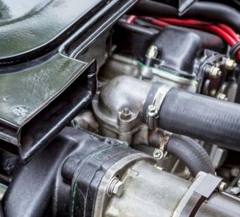

it's not necessary to remove the carburettor to remove the part 4206603..
as you can see in the picture, the 3 screw nuts are freely accessible
